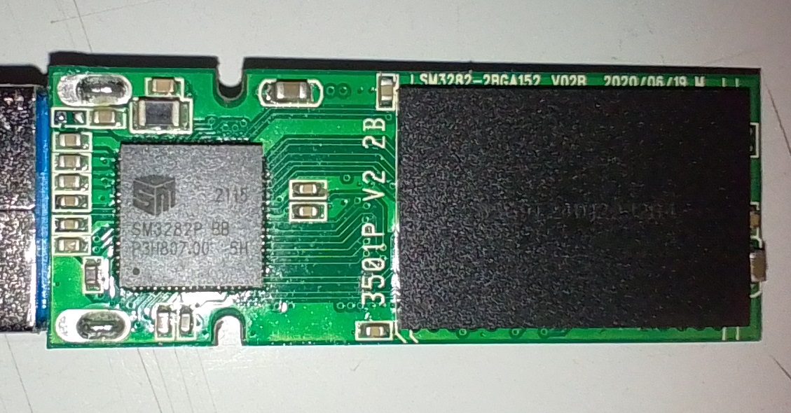

I have a flash drive that has physical errors in its file system metadata.
It detects itself for 1-2 seconds and then disconnects itself from the system.
It reads the MBR, then tries to read the file system, encounters an error and says goodbye.
I don't want to mess with chip-off - I need a relatively full file system.
I can't turn off autodetection under Win 7/10/11.
I need to connect to DE (via SATA or ATA) and map the file system
I'm looking simple solutions...

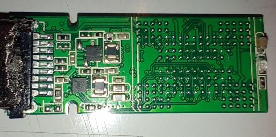

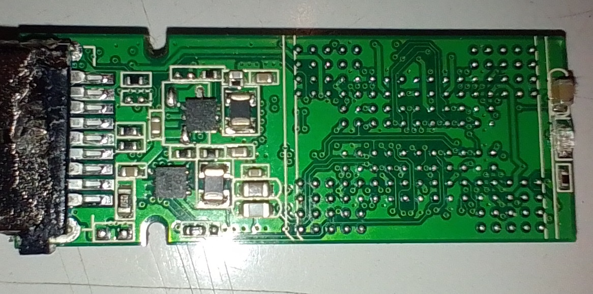

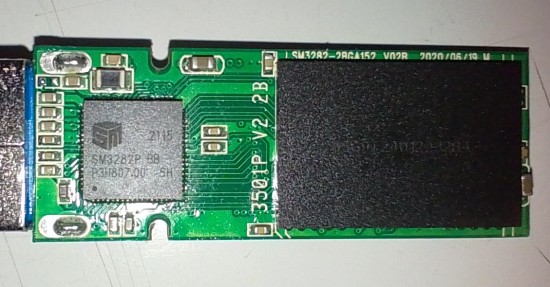

fzabkar, maybe you can advise me something.
You have electronics at your little finger... :)
The case I am describing allows me to suspect that there may also be a problem with the electronics of this pendrive.
Well, apart from this pendrive, there is another identical pendrive - both broke down at the same time and were used in the same laptop.
And they behave the same - the same symptoms.
Maybe there is some problem on the PCB (other than NAND).
I'm sending photos.
Thank you in advance for your help.
