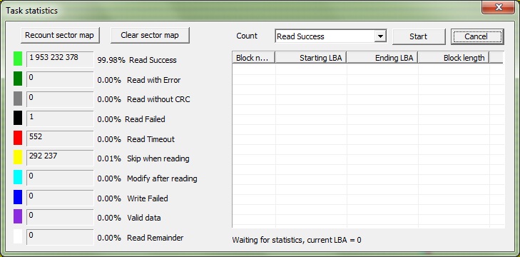

HDD: ST1000DM003-1SB102 F/W: CC43
1. Terminal Message
Boot 0x40M
SpinUp
Trans
Rst 0x40M Thermistor Temp 0020
PreampFaultStatus = 00C0
2. Changed Logical Headmap to 01 01
then after some recvo err HDD detected correctly then important sys files backedup
changed Headmap to Original 00 01 in Ram
3. In DE created Headmap and imaged
If H0 enabled during boot HDD gives PreampFaultStatus err, If disabled during boot no Problem
Question: What is the Actual Problem in This HDD.
Is there any fix for this

the problem maybe in defect file or in head 0 itself is weak.
