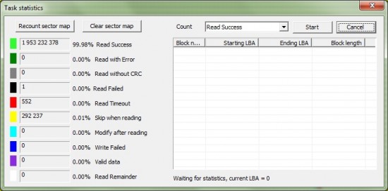

 Post subject: ST1000DM003-1SB102 CC43 PreampFaultStatus = 00C0
PostPosted: September 15th, 2021, 1:38
Posts: 347
Location: india
HDD: ST1000DM003-1SB102 F/W: CC43
1. Terminal Message
Boot 0x40M
SpinUp
Trans
Rst 0x40M Thermistor Temp 0020
PreampFaultStatus = 00C0
PreampFaultStatus = 00C0
PreampFaultStatus = 00C0
PreampFaultStatus = 00C0
PreampFaultStatus = 00C0
PreampFaultStatus = 00C0
PreampFaultStatus = 00C0
PreampFaultStatus = 00C0
PreampFaultStatus = 00C0
PreampFaultStatus = 00C0
PreampFaultStatus = 00C0
PreampFaultStatus = 00C0
PreampFaultStatus = 00C0
PreampFaultStatus = 00C0
PreampFaultStatus = 00C0
PreampFaultStatus = 00C0
PreampFaultStatus = 00C0
PreampFaultStatus = 00C0
PreampFaultStatus = 00C0
PreampFaultStatus = 00C0
PreampFaultStatus = 00C0
PreampFaultStatus = 00C0
PreampFaultStatus = 00C0
PreampFaultStatus = 00C0
PreampFaultStatus = 00C0
PreampFaultStatus = 00C0
PreampFaultStatus = 00C0
PreampFaultStatus = 00C0
PreampFaultStatus = 00C0
PreampFaultStatus = 00C0
PreampFaultStatus = 00C0
PreampFaultStatus = 00C0
PreampFaultStatus = 00C0
PreampFaultStatus = 00C0
PreampFaultStatus = 00C0
PreampFaultStatus = 00C0
PreampFaultStatus = 00C0
PreampFaultStatus = 00C0
PreampFaultStatus = 00C0
2. Changed Logical Headmap to 01 01
then after some recvo err HDD detected correctly then important sys files backedup
changed Headmap to Original 00 01 in Ram
3. In DE created Headmap and imaged
ST-1TB.jpg [ 72.23 KiB | Viewed 13189 times ]
ST-1TB.jpg [ 72.23 KiB | Viewed 13189 times ]
If H0 enabled during boot HDD gives PreampFaultStatus err, If disabled during boot no Problem
Question: What is the Actual Problem in This HDD.
Is there any fix for this
 Post subject: Re: ST1000DM003-1SB102 CC43 PreampFaultStatus = 00C0
PostPosted: December 25th, 2024, 12:25
Joined: December 25th, 2024, 12:19
Location: Pakistan
the problem maybe in defect file or in head 0 itself is weak.
Users browsing this forum: michael chiklis and 54 guests
