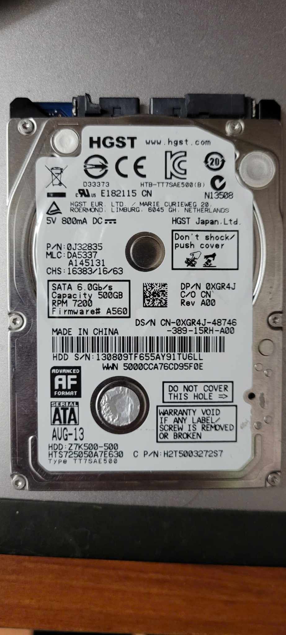

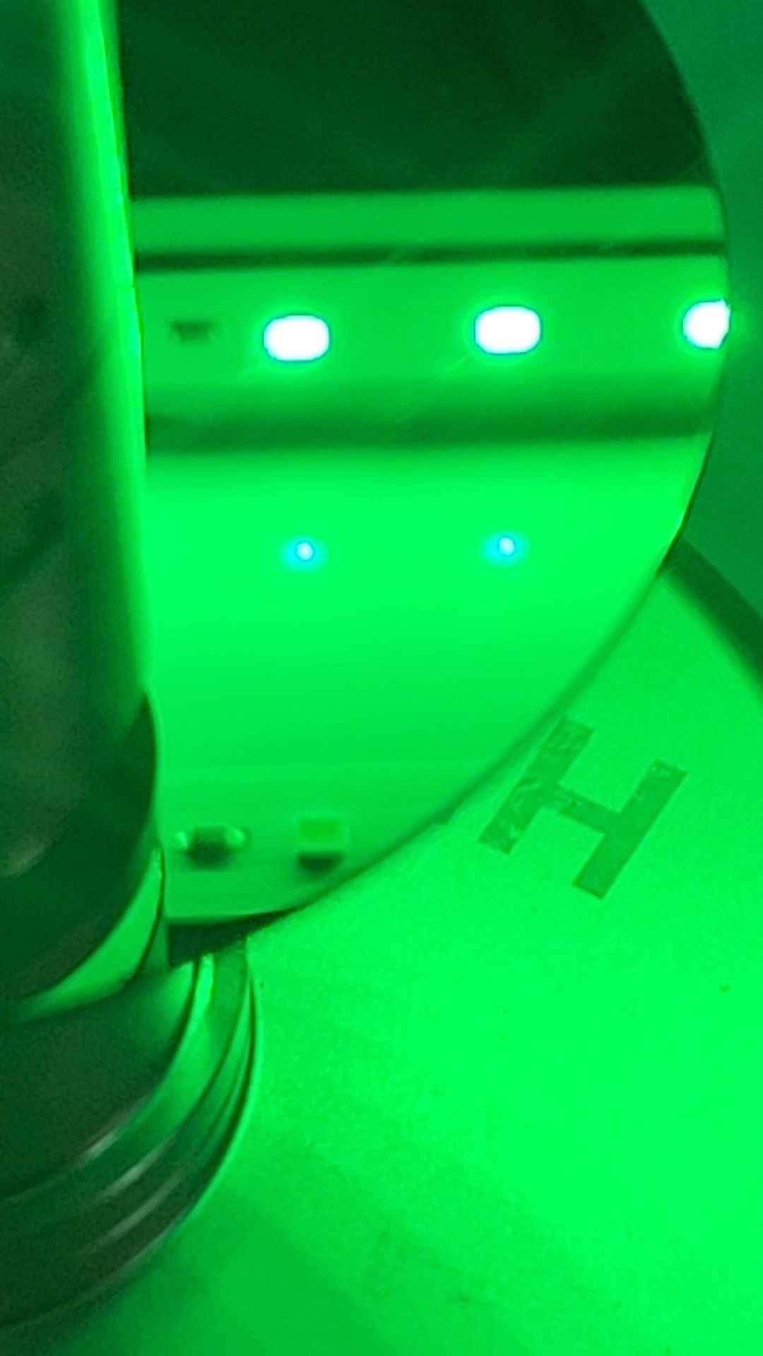

Hi everyone!
I need some guidance or someone willing to help me on this case!
I am currently working on a Hitachi HGST Z7K500-500 HTS725050A7E630 drive
It has a very badly scratched 01 (top) surface
My question is. Can i anyhow physically cut the 01 heads of so that i can read head 0 platter 0?? If yes, what is the procedure and can anyone guide me through it?!
- I am a long time PC3000 User, have clean bench etc...
- I already turned off Head 01 in RAM HEAD MAP
- I already physically cut the 01 Head
But when i start the drive the drive still came up clicking
- I have tried swapping good pair of heads. Which did survive 12GB of data recovery
Many Thanks

You need to clean the platter first. Then cut/bent head 01, change head map in nv-ram and try to recover more sectors. But i think surface 00 will have damage too.

I have cleaned both platters. Platters 00 is in good condition. I cut head 01, changed head map in NV-RAM however the drive starts clicking when the head 01 is missing
i don't know what step i am missing is the point. Or is there any steps in between??

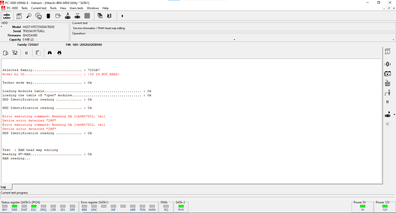

Sorry, need to bother for some time
So i cut head 01, Disabled head 01 In NV-RAM. The Drive gets Ready. spinning, no clicking. But It cannot read SA. The drive shows 0mb
Can you help me out!

It looks like it was able to read ID once, then it failed, probably ovls are not loaded, so that's the first thing you should sort out.
btw, it is not a very good idea to start the drive like this, it can easily damage the SA copy 0 when writing copy 1 of modules...

So any suggestions on how should I proceed pepe??
