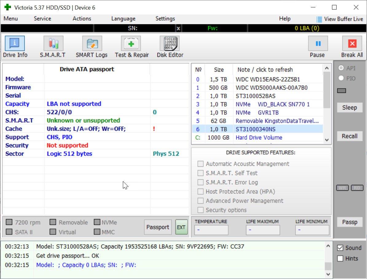

The BIOS and system see the disk, but it can't be read. What can I try to do at home?

So, can't access to restore files? Trash?

If the data is not so important that you need to contact a DR specialist...
We buy a USB-TTL adapter, make a power switch for the HDD, and look at the startup log in the terminal.
And mounting a sick HDD in Windows is a bad omen... :)
Molex --------- Double switch ---------------- SATA Power
+5V ----------- swith -------------------- Red
+12V ---------- swith -------------------- Yellow
GND ---------------------------------------- Black
