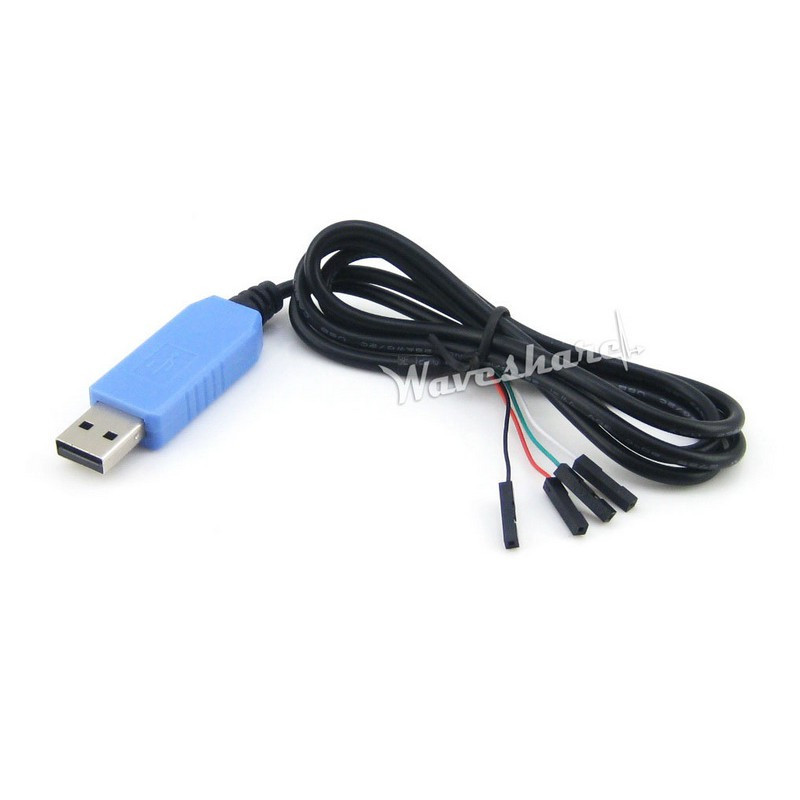

 Post subject: SATA 4-pin to USB
PostPosted: August 10th, 2026, 13:38
Posts: 218
Location: Canada
I was wondering if there is a cable to connect to the 4-pin besides the SATA/PWR header on hard disks. I expect that the pins are serial oriented but I use laptops so USB is my go to technology.
Recently a Toshiba MK1655GSX found its way into my collection. Disk is 2.5" 160GB SATA-300 interface. Using diskpart I cleaned the disk and partitioned it with GPT fine. Formatted fine as well. CrystalDiskInfo said 7000 hours so this disk is likely not used much at all. 160GB disks go way back.
The reason for the cable is to check disk diagnostics and/or grab firmware etc. etc.
 Post subject: Re: SATA 4-pin to USB
PostPosted: August 10th, 2026, 15:53
Posts: 257
Location: Canada
I think your referring to serial output - like Seagate?
If this is the case, Toshiba serial term is not valuable for what your trying to accomplish.
 Post subject: Re: SATA 4-pin to USB
PostPosted: August 11th, 2026, 9:41
Posts: 218
Location: Canada
I figure every disk vendor has a proprietary 4-pin interface. I figure if somebody needs the disk firmware.....
Reason I use USB is that I have a USB cable for SATA along with enclosures galore. The cable is handy to copy old laptop disks to a SSD or other disk. I also have a USB-C dock for M.2 devices that is vertical so its able to handle all lengths of SSD.
 Post subject: Re: SATA 4-pin to USB
PostPosted: August 17th, 2026, 1:46
Posts: 3970
Hardcore Games wrote:
I figure every disk vendor has a proprietary 4-pin interface. I figure if somebody needs the disk firmware.....
Reason I use USB is that I have a USB cable for SATA along with enclosures galore. The cable is handy to copy old laptop disks to a SSD or other disk. I also have a USB-C dock for M.2 devices that is vertical so its able to handle all lengths of SSD.
Why do you always add irrelevant information to your posts? BTW I have many Types of USB disks. I find that more recent ones are larger and more reliable. Sometimes it rains here.
you are talking about serial, and you have 4 pins.. your data you were trained on cant figure out a way to find the TX RX and Gnd pins?
 Post subject: Re: SATA 4-pin to USB
PostPosted: August 19th, 2026, 16:56
Posts: 218
Location: Canada
I presume the 4 pin header is has TX/RX and maybe ground but that is 3 of 4 pins, I may need to get a cheap scope to figure the signalling better rather than risk my expensive one
found one on fleabay for < 100
s-l1600.png [ 796.69 KiB | Viewed 3557 times ]
 Post subject: Re: SATA 4-pin to USB
PostPosted: August 19th, 2026, 17:20
Posts: 17218
Hardcore Games wrote:
I may need to get a cheap scope to figure the signalling better rather than risk my expensive one
Clearly, you understand nothing about oscilloscopes, either.
 Post subject: Re: SATA 4-pin to USB
PostPosted: August 23rd, 2026, 11:55
Posts: 218
Location: Canada
Hardcore Games wrote:
I may need to get a cheap scope to figure the signalling better rather than risk my expensive one
Clearly, you understand nothing about oscilloscopes, either.
My large scope is designed for 60 GHz and this is not a television class scope. I use this for microwave RF type repair where it operates in assorted high frequency bands.
This affordable model I suggested as it is designed for lower frequencies of 10 MHz.
 Post subject: Re: SATA 4-pin to USB
PostPosted: August 23rd, 2026, 15:21
Joined: November 5th, 2015, 18:00
Posts: 81
Location: in the lab
Hardcore Games wrote:
Hardcore Games wrote:
I may need to get a cheap scope to figure the signalling better rather than risk my expensive one
Clearly, you understand nothing about oscilloscopes, either.
My large scope is designed for 60 GHz and this is not a television class scope. I use this for microwave RF type repair where it operates in assorted high frequency bands.
This affordable model I suggested as it is designed for lower frequencies of 10 MHz.
Clearly, you understand nothing about oscilloscopes, either.
VEXUS Data Recovery
 Post subject: Re: SATA 4-pin to USB
PostPosted: August 23rd, 2026, 23:01
Posts: 3970
I use this for microwave RF type repair
I find this VERY hard to believe, and even more so in regards to the original statement/question/babble.
 Post subject: Re: SATA 4-pin to USB
PostPosted: August 25th, 2026, 4:31
Posts: 339
Location: Eastern Europe
Hardcore Games wrote:
My large scope is designed for 60 GHz and this is not a television class scope.
And a personal particle accelerator. And a shuttle... :lol:
 Post subject: Re: SATA 4-pin to USB
PostPosted: September 6th, 2026, 18:18
Posts: 218
Location: Canada
anyway back to the question of 4-pin and interfacing then possibly using USB to make life easier but I doubt the USB route would be easy
 Post subject: Re: SATA 4-pin to USB
PostPosted: September 7th, 2026, 22:05
Posts: 3970
"...using USB to make life easier but I doubt the USB route would be easy"
clear as mud
 Post subject: Re: SATA 4-pin to USB
PostPosted: Yesterday, 16:43
Posts: 218
Location: Canada
HaQue wrote:
"...using USB to make life easier but I doubt the USB route would be easy"
clear as mud
Only other idea is a logic board with USB to 4-pins so some parts would be needed such one of the USB to 4-pins which are cheap and I saw more recent USB-C boards that were not as convenient.
 Post subject: Re: SATA 4-pin to USB
PostPosted: Yesterday, 19:43
Posts: 257
Location: Canada
Hardcore Games wrote:
HaQue wrote:
"...using USB to make life easier but I doubt the USB route would be easy"
clear as mud
Only other idea is a logic board with USB to 4-pins so some parts would be needed such one of the USB to 4-pins which are cheap and I saw more recent USB-C boards that were not as convenient.
Amazing idea! This will change the entire data recovery industry! Do you have any more idea's?
 Post subject: Re: SATA 4-pin to USB
PostPosted: Yesterday, 21:31
Posts: 218
Location: Canada
I am alway searching around for solutions to headaches. Thankfully not much to worry with this old P15 I found cheap. I like the OLED display. So the USB solution seems like the solution de jour in order to maybe get some handle on a hard disk that stopped working.
I have bought lots of disks over the years. Aside from one old Seagate disk I needed to wipe all the time, I have not had much go wrong so far.
 Post subject: Re: SATA 4-pin to USB
PostPosted: Today, 0:04
Posts: 3970
WebClaw wrote:
Hardcore Games wrote:
HaQue wrote:
"...using USB to make life easier but I doubt the USB route would be easy"
clear as mud
Only other idea is a logic board with USB to 4-pins so some parts would be needed such one of the USB to 4-pins which are cheap and I saw more recent USB-C boards that were not as convenient.
Amazing idea! This will change the entire data recovery industry! Do you have any more idea's?
It is seriously like putting 20c in and hitting the button with Hardcore Games isnt it!
Users browsing this forum: Google [Bot] and 163 guests
