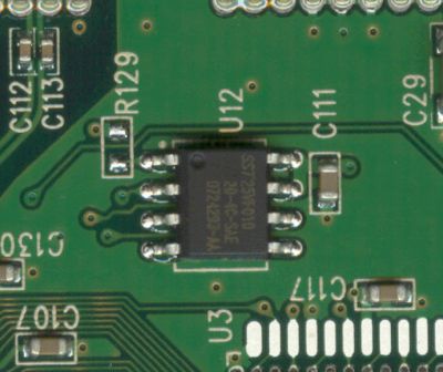

I have a Western Digital Drive
WD400BD-75LRA0
DCM= HSBHYTJCH
SN= WMAMC5060128
Drive is detecting as a WDC ROM MODEL UNICORN does anyone have the firmware or have worked on this drive before?
Thank you.
 Post subject: Re: Firmware Need For WD400BD-75LRA0
PostPosted: October 25th, 2007, 13:23
Posts: 637
Location: Canada
Does it click?
Does it spin up?
Did you change PCB on it?

It Spins no clickiing havnt found a matching PCB but after seeing the way the drive detected as a WDC ROM Unicorn it seemed like firmware.
PostPosted: October 26th, 2007, 2:32
Joined: May 30th, 2005, 17:07
Posts: 543
It is nacessary to resolder native ROM !!!
Mikippp

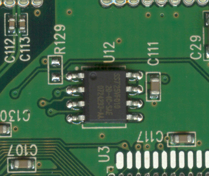

PostPosted: October 27th, 2007, 4:39
Posts: 543
ROM - U12 (25P10, AT25F1024, SST25VF010)
Mikippp
