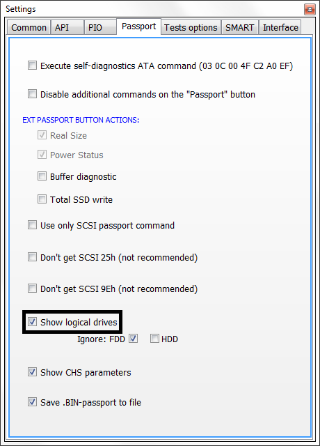

If tinkering with the firmware seems too risky, there's another option, already suggested in the error message: adjusting the settings. Judging by the photos, the drive responds to requests after about 5 seconds. You can set the timeout to 6 or 8 seconds, or even longer, and continue copying. By default, the timeout is set to 1 second (1000 ms), after which the program determines that data is being read slowly from that section and attempts to bypass it by skipping a few megabytes. If, after several jumps, data is still reading slowly, the program increases the skip step, and continues this process until it finds a well-readable section, or increases the skip step to an extremely high value and resets it, returning the error you saw.
The slow response problem has a specific behavior pattern: for the first few hundred or thousand requests after startup or after being idle, the hard drive responds with a significant delay. But if the requests continue, the hard drive exits this slow mode and, after a while, begins transferring data at full speed, sometimes freezing for a split second. This works for both continuous data access operations and random access operations. The main thing is that the computer doesn't stop the flow of requests; then the hard drive doesn't have time to think about other things. You've already noticed this when the hard drive freezes and then starts working for a while.
But judging by the fact that you've already tried running the copy process before, and it took a very long time, copying practically nothing, this most likely won't help. Still, you can try again. Again, this method carries the risk of damaging the hard drive; problematic hard drives tend to be powered on as little as possible and copy data from it as quickly as possible before it fails completely.

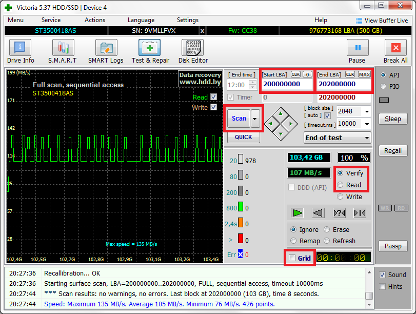

I have performed a risk analysis; even if something goes wrong, no one else will be to blame, and I will accept the risk.
Perhaps some encouraging news: as ora advised, I ran the "Analyze" process, and the result can be seen in Fig 1. The analysis process took about 30 seconds.
I can proceed with "Extended Analyze," or, in accordance with Fig 2, I can perform the disk clone by modifying the "Skip Threshold (ms)" to 9000 or 12000—see Fig 2.
I am also preparing for a possible next step where I would execute "patch mod 02 and potentially patch mod 32"—I have the procedure outlined in Fig 3 across 5 or 6 steps (1 - 6 st). If these steps according to Fig 3 are incorrect, please let me know. I haven't executed the patch mod 02 procedure yet; this is just preparation in case it becomes necessary.
Now I would probably try cloning the disk again based on Fig 2 and report back on what happens. Since it will likely be a very long process during which I'd like to stay by the laptop the whole time to intervene if necessary, I will probably do this on Wednesday when I am at home. For now, thank you very much for all the guidance.

Download the Victoria HDD utility on your new laptop. It's a well-known and trusted application for checking hard drives. https://hdd.by/Victoria/Victoria537.zip
Extract the Victoria537 folder from the downloaded archive, connect the hard drive via a USB-SATA cable, and give the system a little time to initialize it.
Next, launch Victoria from this folder. In the default tab (Drive Information), find your hard drive on the right side of the window and select it. Detailed information about it should appear on the left side of the window. Next, go to the fourth tab (Test and Repair) and configure the settings as shown in the screenshot below:
In the Start LBA and End LBA fields, enter, for example, 200 million and 202 million, respectively. Where the Verification-Read-Write option appears, choose either the first or the second. Verification is slightly safer. Reading produces accurate results.
By default, the "Grid" option will be checked. Turn it off.
Click "Scan".
Judging by the fact that the OpenSuperClone analysis didn't take very long, this test won't take long either. Once it's finished, upload the results.
The program's graph displays the read speed. When the drive is healthy, the speed shouldn't drop to the bottom of the graph. If you see some jaggedness on the graph, and the speed alternates between jumping to around 100 megabytes (your drive has a read speed of around 90 megabytes/sec in the first few gigabytes, dropping to just over 40 megabytes/sec in the last few gigabytes), and then dropping to 10 megabytes/sec, the OpenSuperClone analysis has correctly identified the cause of all the problems: a dirty head.

The program doesn't refuse to launch; upon startup, it attempts to enumerate all available drives, querying them, and then hangs due to the same slow response issue. It just needs more time. The program also tries to find partitions, which also causes freezing - this can be done in the settings (and is necessary in our case).
First, try running the test in Victoria, give it 10 minutes maximum, and set the timeout value to 5000 instead of the default 10000. And based on the results of this test, you will most likely have to either raise the timeout in opensuperclone or apply a patch to fix the slow response. In the VSC menu, select option 4. After reading and fixing the file, backup it from your Home folder, hope for the best, and apply the patch. Then try running the analysis again. Remember, this procedure is dangerous - you are editing the hard drive firmware.
