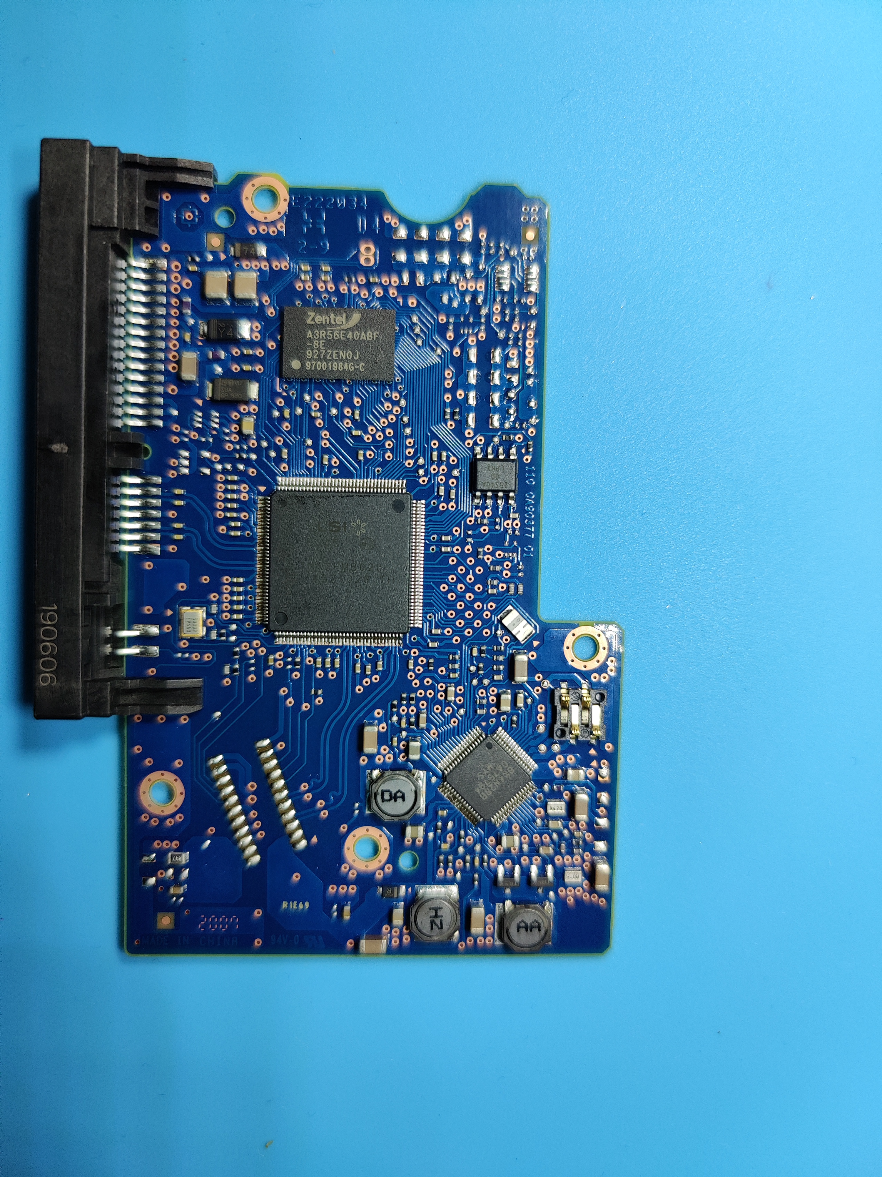

Hello people. I am facing a problem with same type of hdd on this thread. On boot Bios identifies it with: Smart event (asus mb). After windows starts i can see all 3 partitions but no acces to any of them. Hdd gets warm and spinning. I got another pcb from a dismantled good hdd with same specifications. Can anyone hint me somehow. Whenever I try start windows with this hdd connected it takes a lot to start. I have to start windows with hdd disconnected. When I connect it to pcb it takes 30seconds until windows gets stuck.

Wich one Is rom chip please?

I actually just changed reading head hsa. And revived all partitions except one ...Parameter is invalid :(. The most important. I can copy some folders with testdisk. Have any other solution please?

Posts: 17335
Clone the drive with HDDSuperClone.
You could try to disable ARRE (Automatic Read Reallocation Enable) via terminal using the SP command:
https://forum.hddguru.com/viewtopic.php?f=1&t=28168
Doing so should hopefully stabilise the drive.
It's a Hitachi- HDS721050DLE630 labelled by Toshiba
