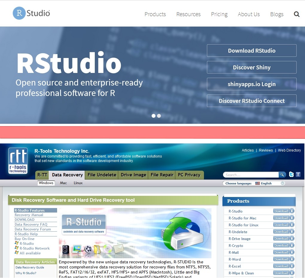

I installed R-Studio, but no idea then what to do with it.

I understand.
I installed the wrong software:
However, recovery of the demo is limited to files no larger than 256KB with is quite a huge limitation.
