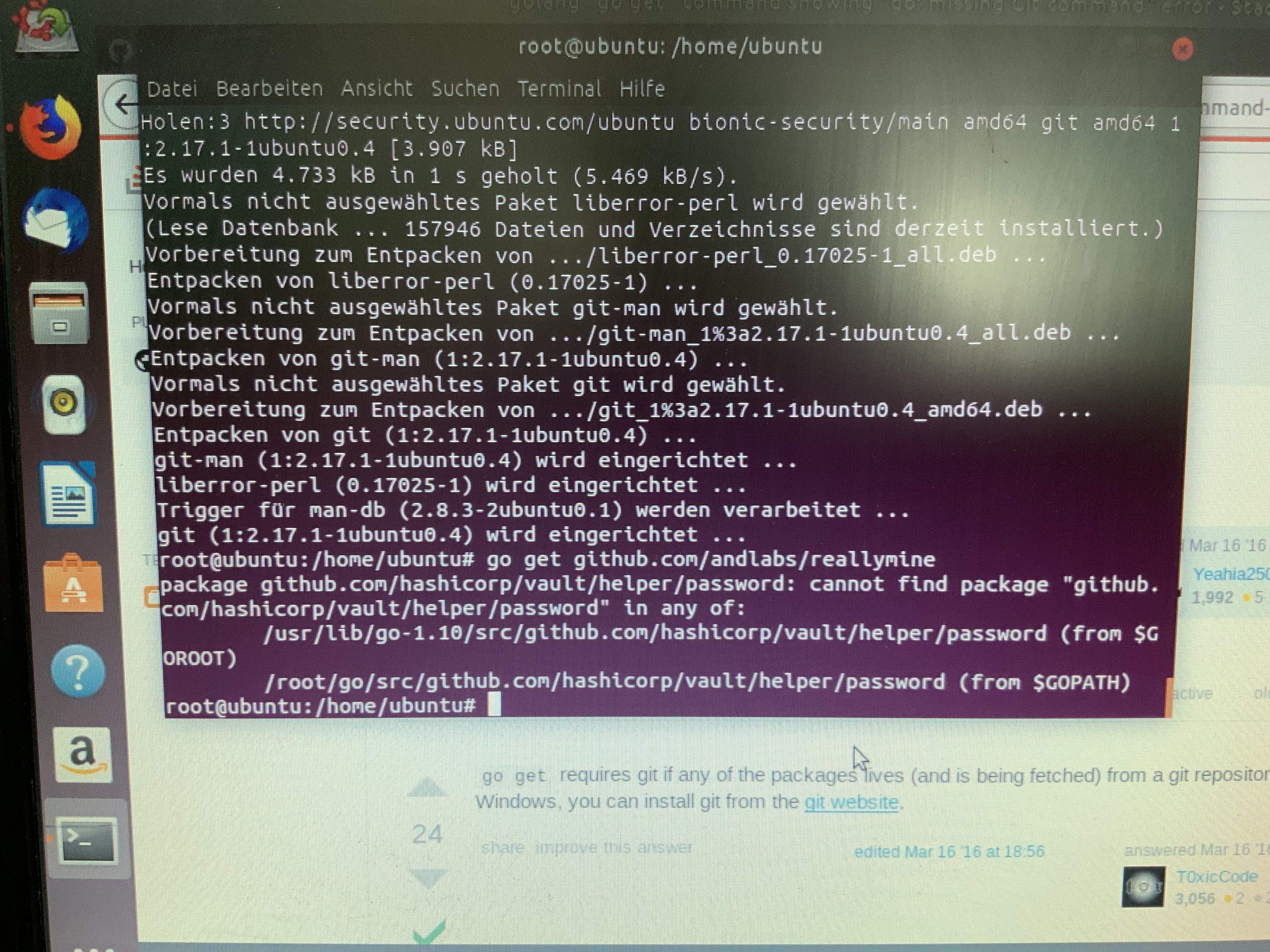

$ go get github.com/andlabs/reallymine
This is what i did, after I installed go.
but if I run the command reallymine i get the result -> unknown command.
Ill post a Screenshot later. ATM another DR is running on this machine.
best regards
Fabian
 Post subject: Re: How to recover WD Mybook Harddisk
PostPosted: September 24th, 2019, 7:12
Joined: April 3rd, 2015, 4:26
Posts: 60
Location: Germany
It seems that the package isn’t up to date anymore
