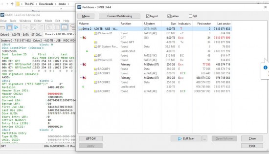

jdanham wrote:
Hello all - I've been out for a bit, so here is some additional photo information as requested. Hope this helps. Also I am attaching what I saw in Disk Utility on the Mac.
Aside from the obvious, I am quite concerned that the partition sizes showing are smaller and don't add up to 4TB.
It looks like an "ASM1051W" SATA>USB bridge chip, if it is then that's non-encrypting.
So the problem is elsewhere.

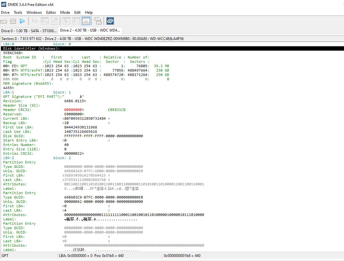

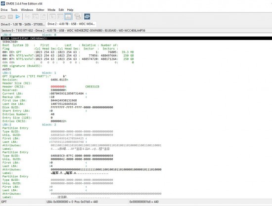

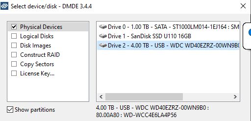

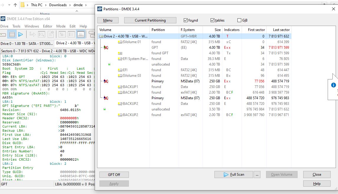

OK, then maybe DMDE behaves differently in a Mac environment. Can you try the same thing in Windows?
OK this may be of more help. It definitely does not work like the MacOS version but here are the relevant captures I believe you were interested in seeing.
 Post subject: Re: 4TB WD Blue issues following power surge/outage
PostPosted: October 30th, 2019, 14:17
Posts: 17230
Thanks. That confirms that the file system was built behind a bridge that was configured for a 4KB sector size.
You can now double-click each of the BACKUP1 and BACKUP2 exFAT(4K) volumes and expand the Root. Hopefully you will see your files and folders.
