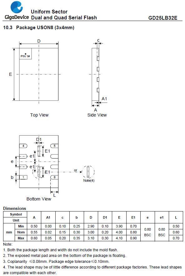

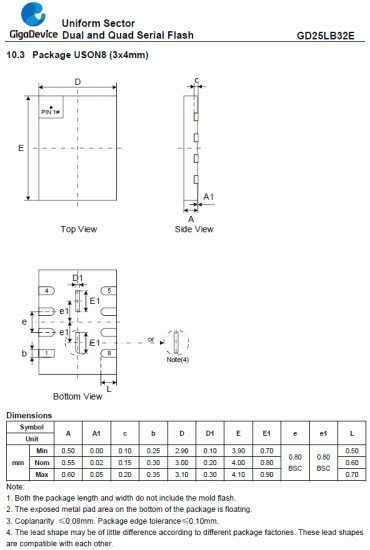

AFAICT, your ROM has a width of 3mm and a pin pitch of 0.8mm. I haven't been able to find a breakout PCB or DIP-to-smt adaptor that has these dimensions. :-(

Here are the package dimensions.
DIP adapter (not cheap):
https://www.reveltronics.com/en/shop/76/7/chip-programmers/adapter-dfn8-3x4-udfn8-vson8-uson8-dil8-dip8-76-detail
https://forum.reveltronics.com/viewtopic.php?t=79
