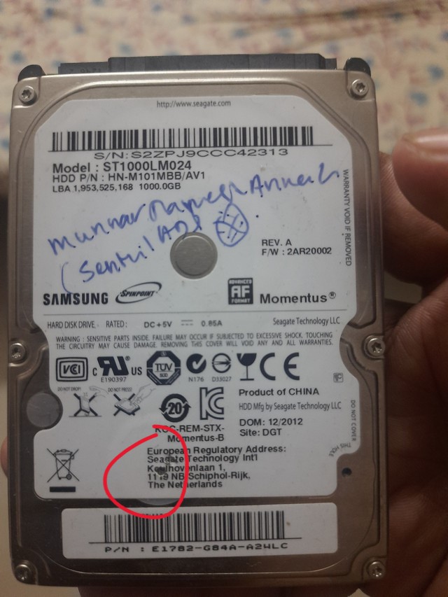

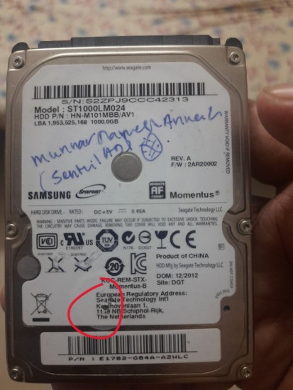

Of course you have a problem with the heads.
And probably with the surface.
And who knows what else.
This hole didn't make itself...

 Post subject: Re: ST1000LM024 is spinning but not reading nor detecting!
PostPosted: July 8th, 2024, 4:21
Joined: January 16th, 2024, 6:53
Posts: 165
Location: Chennai
Just holed it with my screw driver that's all :D
