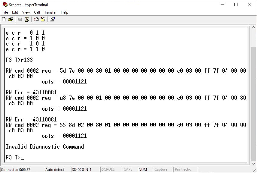

Read and Write F3 Arch Sys files with HyperTerminal :
What are you using HyperTerminal or ZOC8?
 Post subject: Re: SEAGATE ST3500320AS
PostPosted: January 16th, 2025, 15:30
Posts: 339
Location: Eastern Europe
There are no r and w commands on ST3500320AS.
I don't do DR. And my connections are limited at the moment.
PostPosted: January 16th, 2025, 15:35
Joined: January 8th, 2025, 7:49
Posts: 31
Location: sLOVEnia
I am not able to get to sys files.
