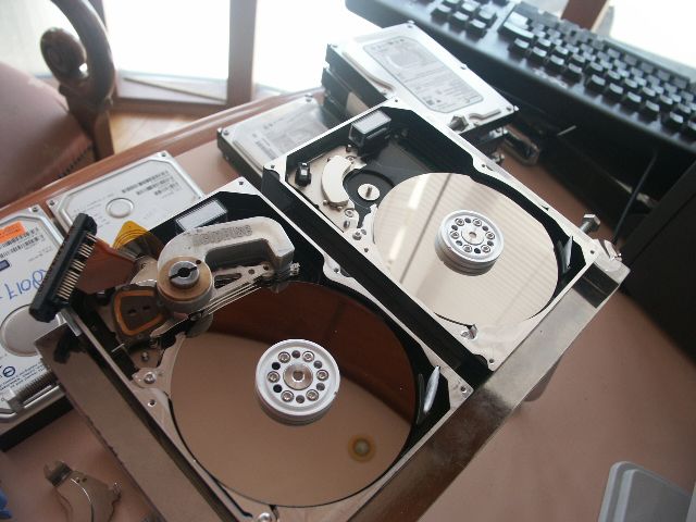

Sir, I think that You need to behave like a gentleman with ladies and in buisnies, man asked me for a date not You.

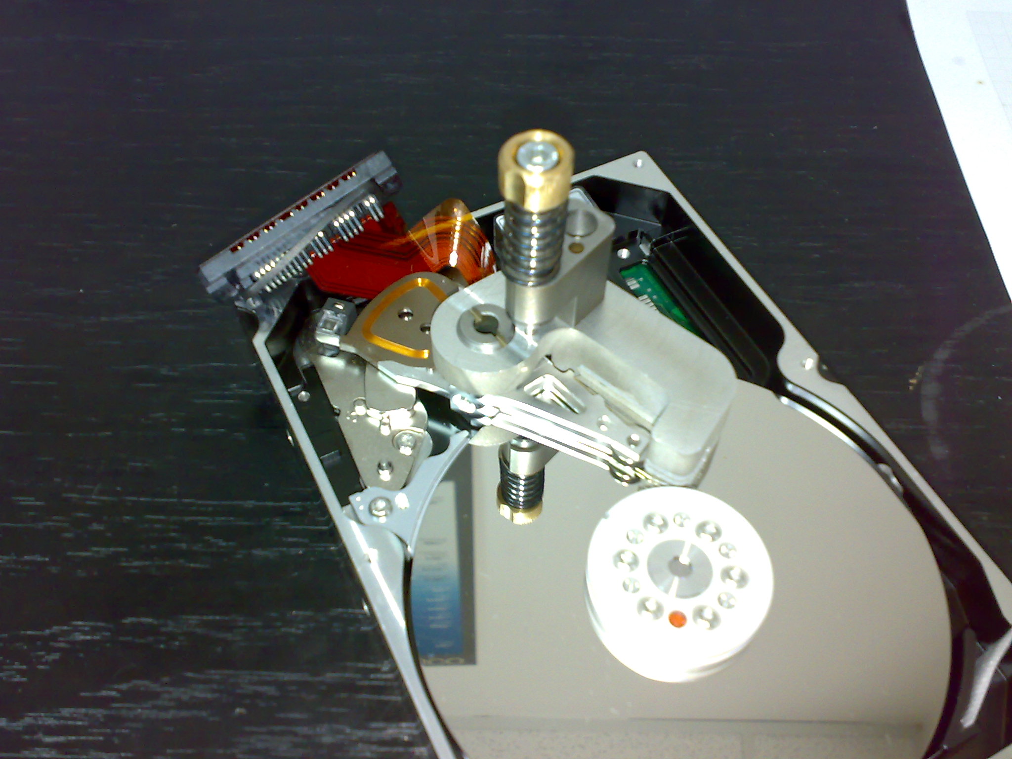

As far as our tool, i hope this version 1.3 will be ready this week, we have found some problems with previos designs, and we want to go out on market with apsolutley working tool.
Our tool is good because in cases of bad motor, You can change heads witouth them tuching the surface. Even if motor is ok, baybe can change heads with this tool. I hope in Friday this week I will be able to put some more pictures.....
thanks for patience it will pay off

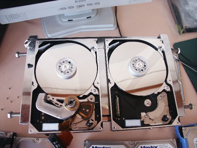

 Post subject: Re: head change tool
PostPosted: May 21st, 2008, 4:58
Posts: 709
Location: Belgrade
here is a picture of 1.2 version new will come this week ( i think final )

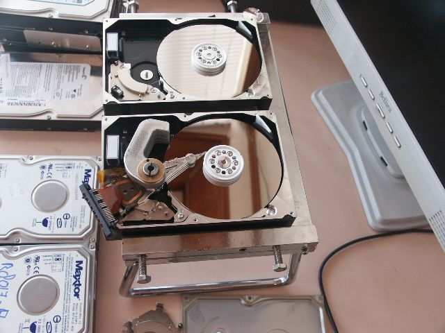

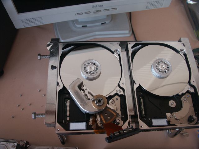

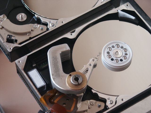

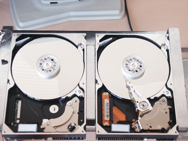

head change tool for maxtor dm9 and dm10 is finished. It is made from dural ( non magnetic aluminium ) and it works great.
It keep heads and platters tuching as well as heads tuching them selfs...
You can use same heads on meny recoveryes because head do not get bad.
More info on serbia@helpdisc.com soon on new web site....
We are curently working on seagate 7200.10 up to 500Gb....
thanks for patience....
Nikola

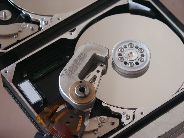

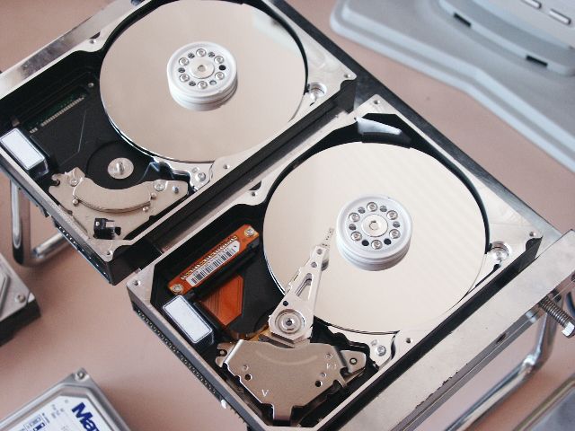

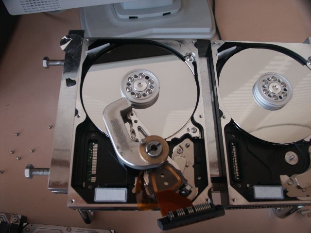

PostPosted: July 7th, 2008, 9:07
Posts: 709
Location: Belgrade

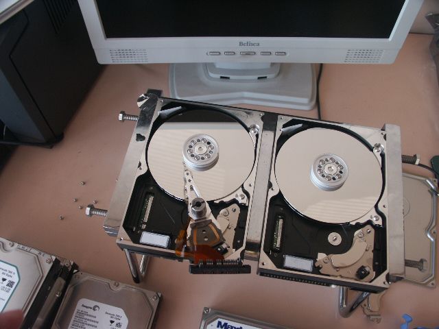

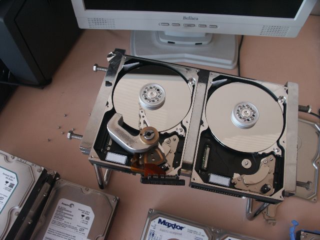

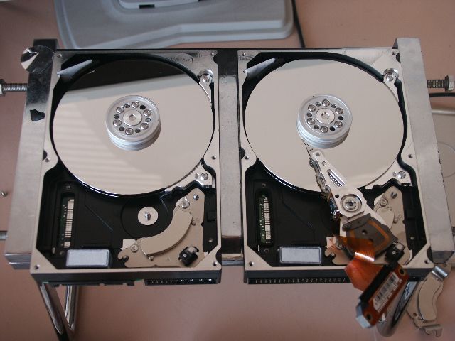

here are more pictures

Is that the tool you recommended me to buy in my Momentus with stuck spindle post? I can imagine how this thing could help me bake small cakes, but not how it will secure a platter stack, actually, it looks too big to fit around the platters in a 2,5" drive.
Hi, in their "kit" there is a 2.5 version of their tool aswell...
