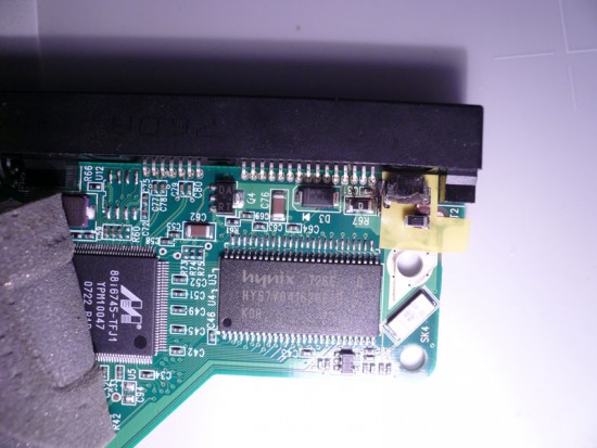

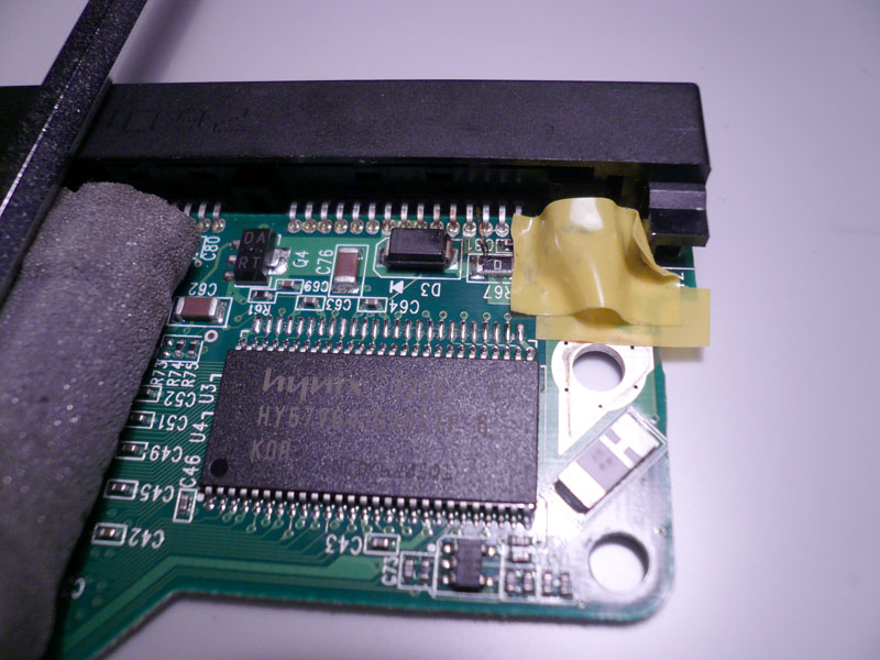

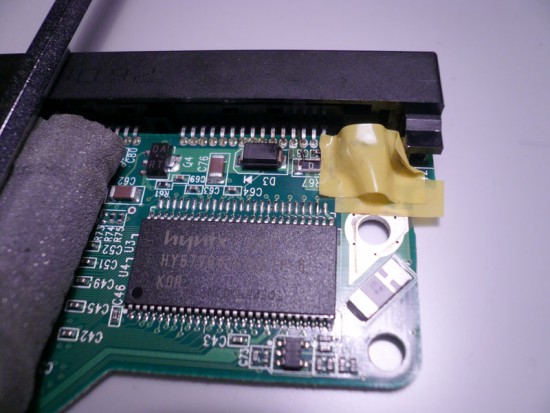

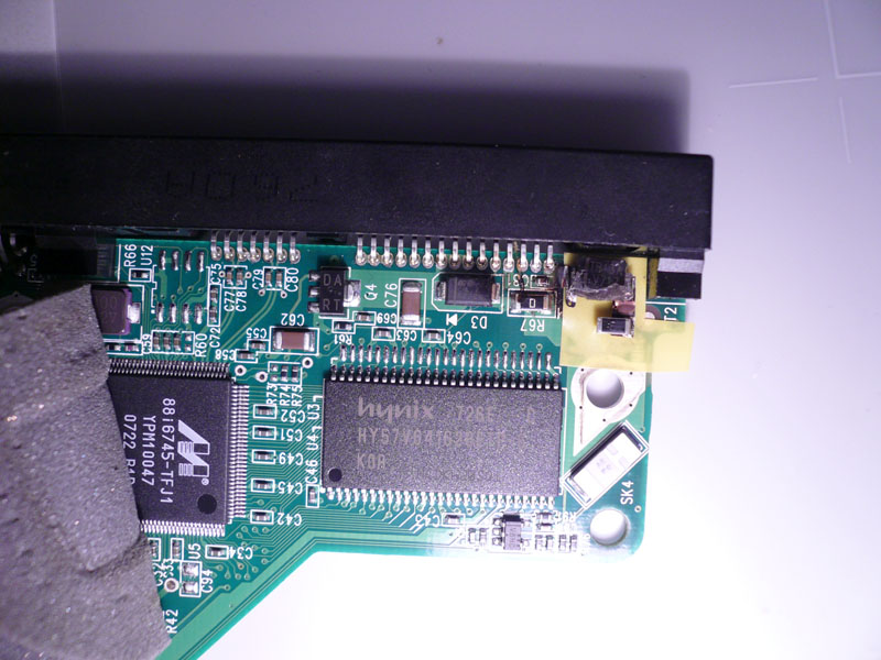

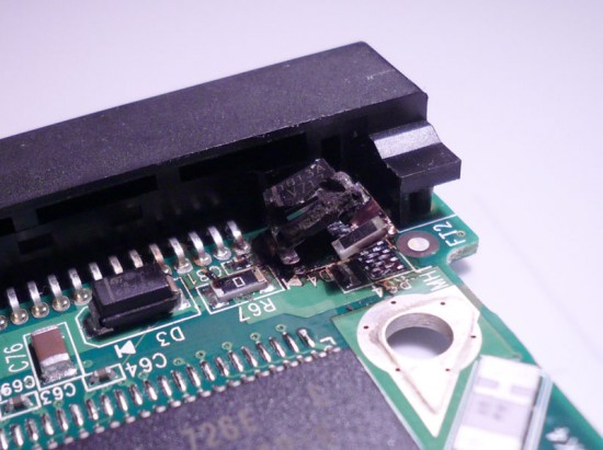

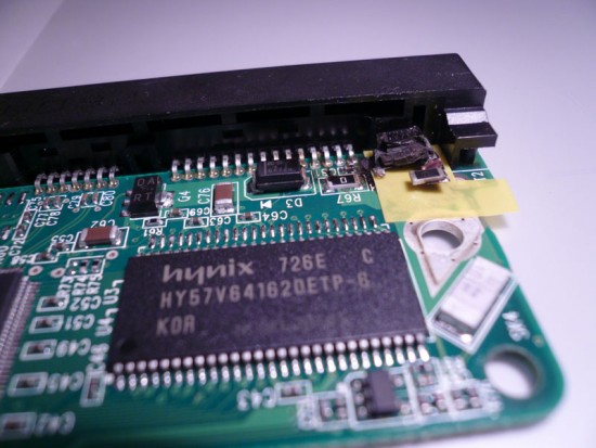

Thank you so much for sharing your solution. I had the same problem (transient voltage suppression (TVS) diode in short circuit ) and thought my precious datas lost. I didn't manage to desolder it, but as it was completly cracked and burnt, I lifted one side up accidentally with my screwdriver, detaching one side of the small "R64" (resistor ?) from the board too. I thought it would be catastrophic, but I tried to put insulated tape between the board and the detached sides of the components. It worked very well :D . I will post a photo if it can still help someone.
I would never had thought of such a solution (tried to change the board without success), so thank you again.
Olivier

Hello again,
As promised, some photos of the "repair".
File comment: View of the TVS and "R64" partially removed.

File comment: Insulated tape in place.
File comment: Top view.
File comment: Some more ribbon for more security.

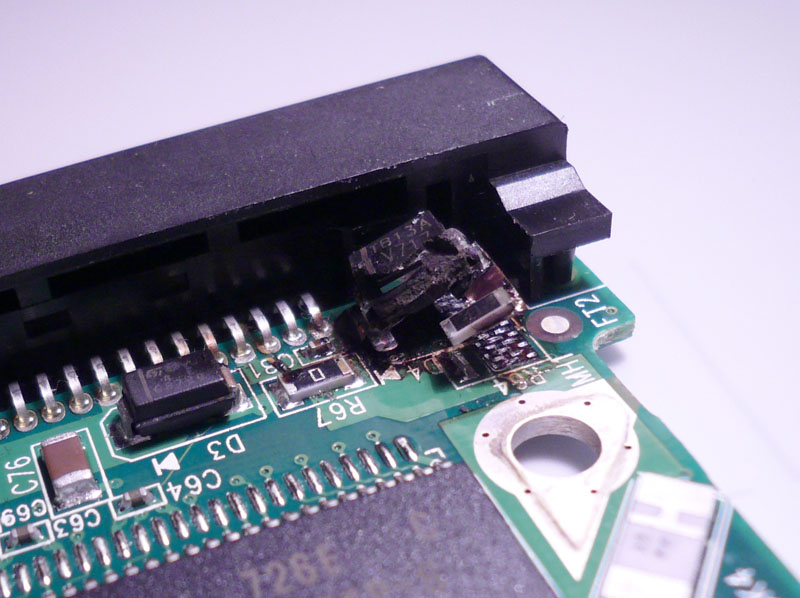

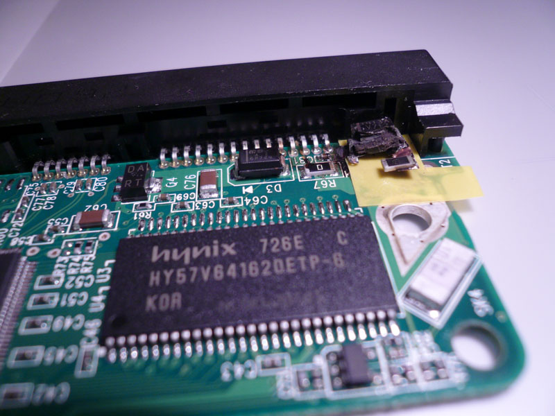

Western Digital (500GB WD Caviar, WD5000AAJS 32YFA0) from a MyBook chassis. Original symptoms were no sound/no spin-up and blinking light circle on the external chassis.
I extracted the drive and attached another power supply (I no longer trust the original power supply), then smoke started coming from the controller board. Disconnected power immediately.
I removed the controller board/circuit board and located the smoking component by reattaching the power for a few seconds: it turned out to be the TVS-diode [Transient Voltage Suppression], marked "TB13A V721").
I then found a page explaining the function of TVS-diodes at http://forums.seagate.com/t5/Barracuda- ... m-p/118908.
After reading this thread, I removed the diode by desoldering each side.
When I reapplied power to the board, no smoke or other visible things happened.
I then remounted the controller board and applied power -- DISK SPUN UP AGAIN!!! :D
