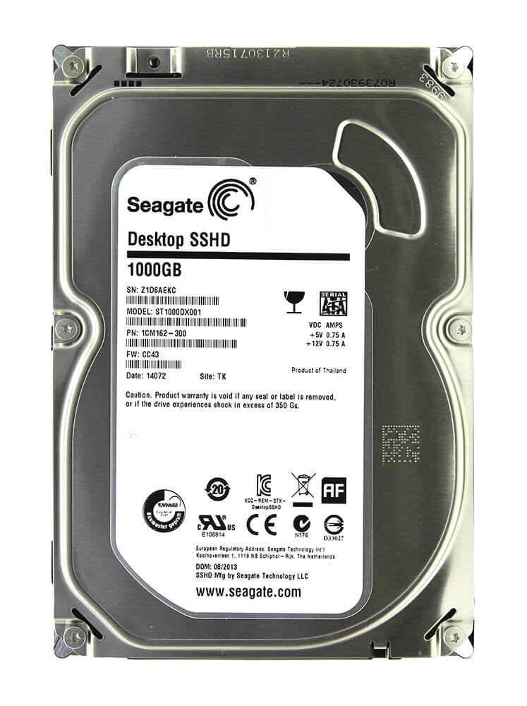

lastmile wrote:
I put a PCB from an HD donor in some PCB pacient and they spin perfectly, no clicks or weird noises.
What firmware version on the donor card? I see CC43 on some units.

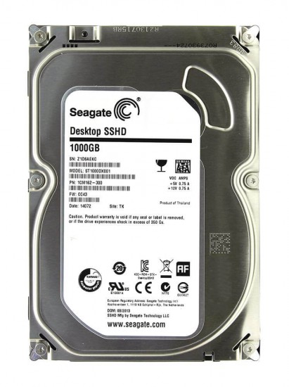

lastmile wrote:
My case is very similar to this: https://forum.hddguru.com/viewtopic.php?f=1&t=29046
What should I do ?
After ROM chip transfer the disk spins up fine, detected in BIOS ...
I be tempted to try the same and if this works re-burn all the ROM chips with a programmer
The chips are 50c each
