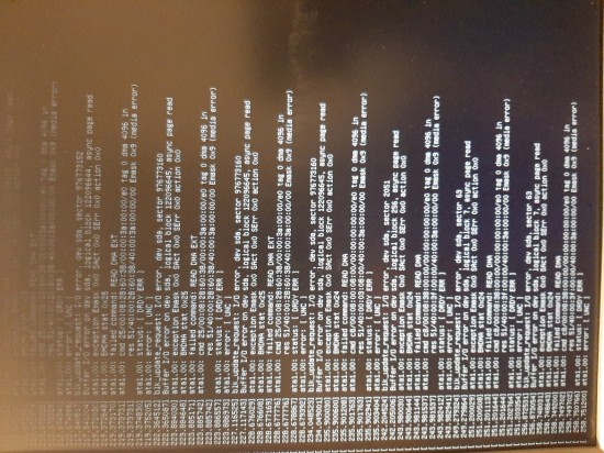

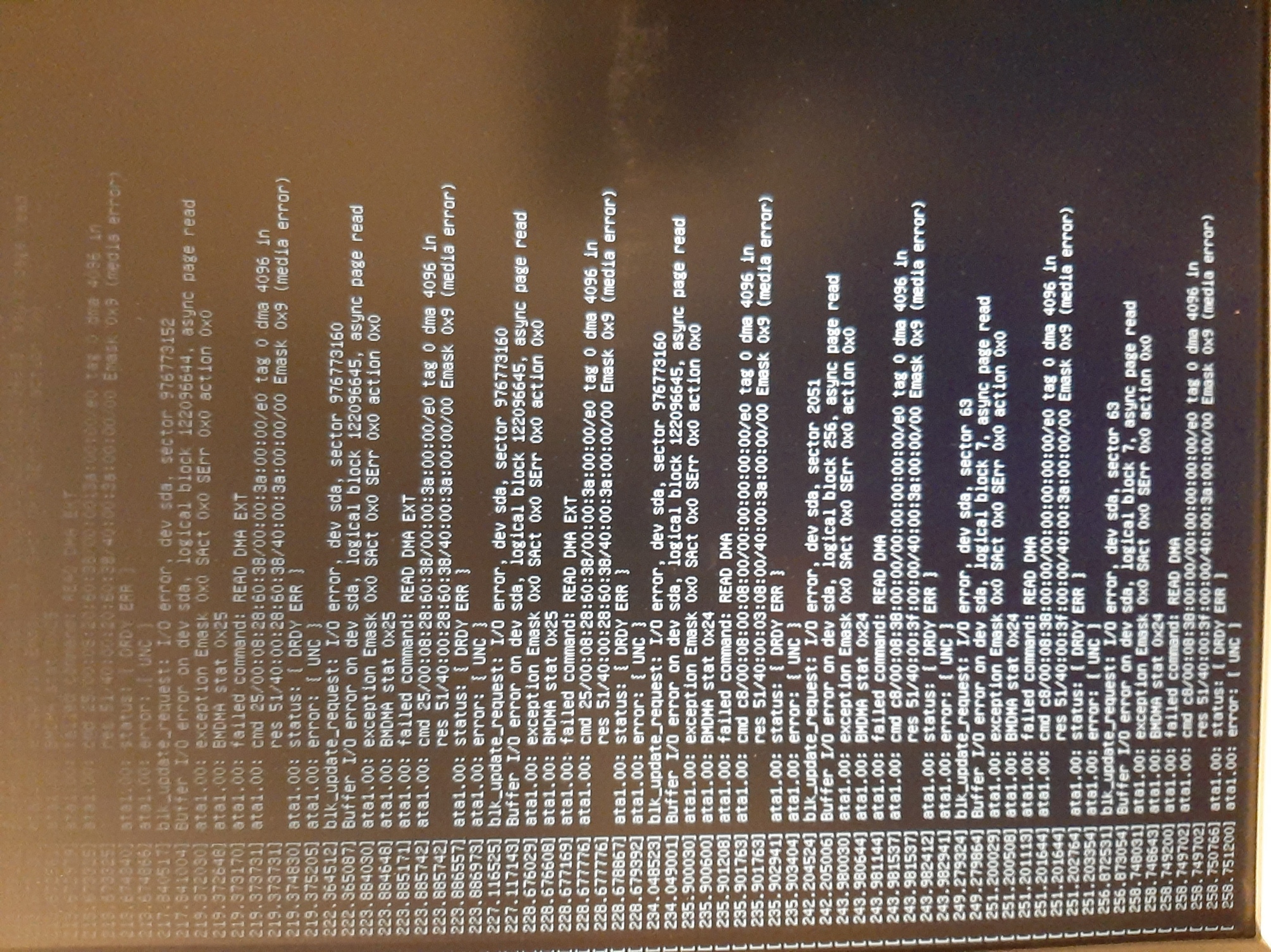

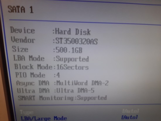

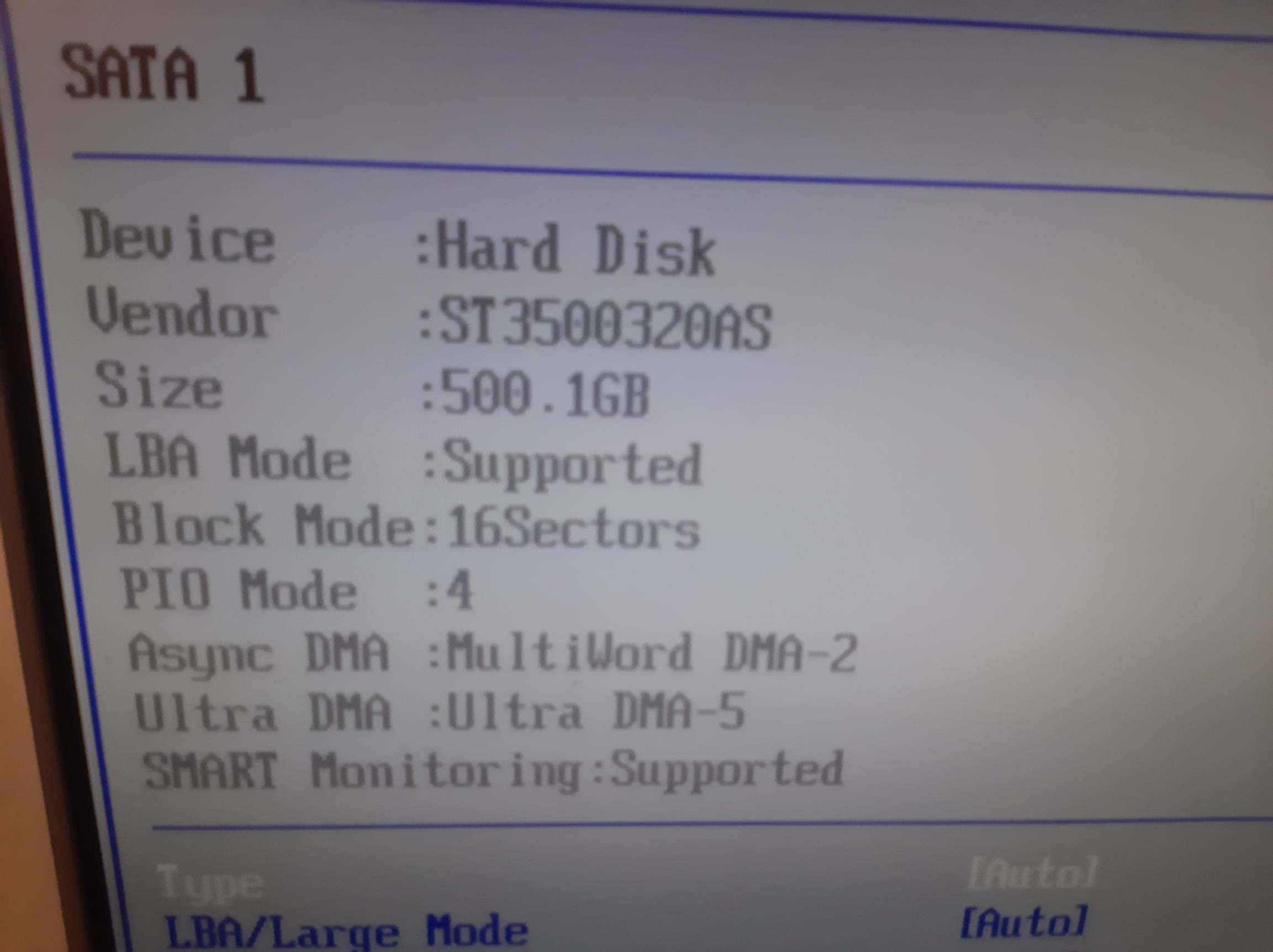

Small update
Today I've connected my drive to an old motherboard from year 2007 and asus BIOS recognized drive with correct size right away. That got a smile on my face.
Although when starting HDDLiveCD I got a lot of complaining about bad sectors. Pretty much it is complaining all the time about a bunch of same sectors
    63
    64
    257
    515
    2050
    4096
    976773104
    976772992
    976773152
    976773160
After a lot of complaining, Ubuntu starts and I can even start HDDSuperClone.

Your prospects don't look good. Those sectors are where the partition and file system metadata are usually located.
As for the "F" commands, expensive professional tools such as PC3000 issue those same commands, or directly modify the corresponding sys file. Each command can be reversed by flipping the respective bit.

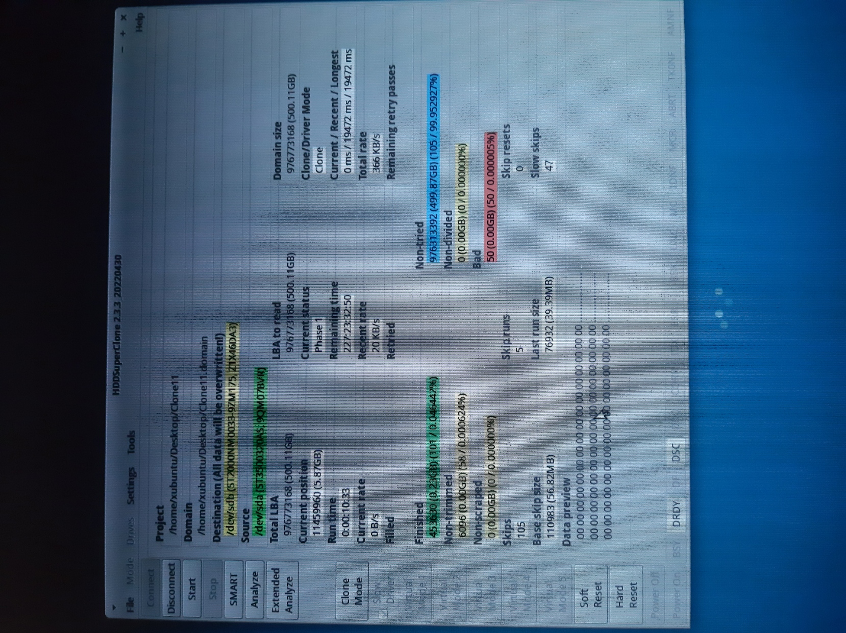

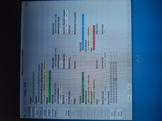

After running HDDSuperClone for several minutes, I checked the destination drive and found that it was intact with old partitions when they should be new.
Clone11.log [19.15 KiB]
Downloaded 179 times
Do you vote for running F commands, or should I send the drive to the DR specialist?
 Post subject: Re: SEAGATE ST3500320AS
PostPosted: January 18th, 2025, 15:20
Posts: 17228
At the current rate you will torture your drive to death with HDDSC. If you wish to persist with DIY, at least for a short time, then the "F" commands are your only option. If the speed improves after doing this, then you will need to make a decision. I'm not a data recovery professional, so I don't want your business.

ISTM that the error rate is 1 in 9,000. Shouldn't that give the OP some hope for a DIY solution?
Finished     453630
Non-tried    976313392
Non-trimmed  6096
Non-divided  0
Non-scraped  0
Bad          50

@fzabkar:
HDDSC log is full of 51/40 errors and skips,(if i read it correctly). the drive can't read from H0. No F command will change that.
The clone drive contains the original data, nothing cloned.
@Piper: licking my wounds for a few more days... :)
my contact is in signature. But this is not an insanely difficult case, i am sure you can find a local dr service, you could ask Jerovsek as Franc advised.

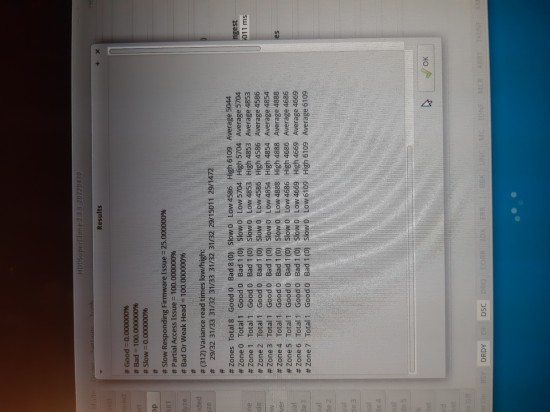

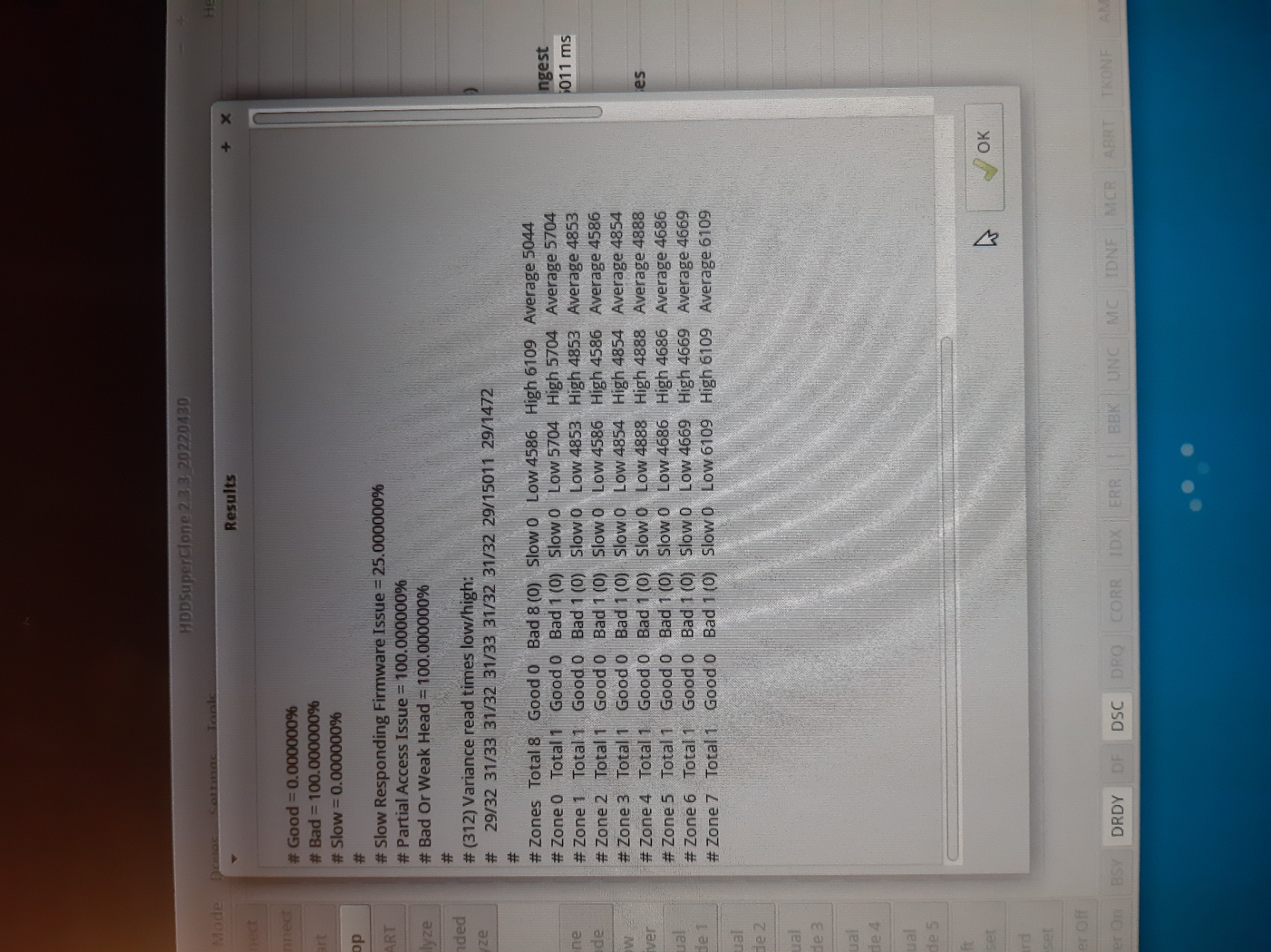

OK, here is how the things stands.
@Pepe was right.
I did download F commands to the drive and gave HDDSC a try.
HDDSC has stopped by itself, saying that there are too many skipped files.
I was not able to retrieve any data, destination drive is empty.
No more DIY, a specialist in DR is needed :( .

################ START ANALYZE DATA ################
# startanyalyze
# Good = 0.000000%
# Bad = 100.000000%
# Slow = 0.000000%
# Slow Responding Firmware Issue = 0.000000%
# Partial Access Issue = 100.000000%
# Bad Or Weak Head = 100.000000%
# (1504) Variance read times low/high:
#     30/32  30/35  28/32  28/32  29/32  30/32  30/32  30/32
#     30/32  30/32  30/32  28/49  29/32  31/34  29/35  30/32
#     31/35  31/32  29/32  29/34  31/33  29/32  31/34  31/35
#     31/32  31/88  31/34  29/34  31/36  29/32  31/32  28/34
# Zones   Total 32    Good 0    Bad 32 (0)    Slow 0    Low 4551    High 6336    Average 4826
# Zone 0    Total 1    Good 0    Bad 1 (0)    Slow 0    Low 6336    High 6336    Average 6336
# Zone 1    Total 1    Good 0    Bad 1 (0)    Slow 0    Low 4686    High 4686    Average 4686
# Zone 2    Total 1    Good 0    Bad 1 (0)    Slow 0    Low 4869    High 4869    Average 4869
# Zone 3    Total 1    Good 0    Bad 1 (0)    Slow 0    Low 4676    High 4676    Average 4676
# Zone 4    Total 1    Good 0    Bad 1 (0)    Slow 0    Low 4995    High 4995    Average 4995
# Zone 5    Total 1    Good 0    Bad 1 (0)    Slow 0    Low 4745    High 4745    Average 4745
# Zone 6    Total 1    Good 0    Bad 1 (0)    Slow 0    Low 4964    High 4964    Average 4964
# Zone 7    Total 1    Good 0    Bad 1 (0)    Slow 0    Low 4839    High 4839    Average 4839
# Zone 8    Total 1    Good 0    Bad 1 (0)    Slow 0    Low 4662    High 4662    Average 4662
# Zone 9    Total 1    Good 0    Bad 1 (0)    Slow 0    Low 4563    High 4563    Average 4563
# Zone 10    Total 1    Good 0    Bad 1 (0)    Slow 0    Low 4978    High 4978    Average 4978
# Zone 11    Total 1    Good 0    Bad 1 (0)    Slow 0    Low 4849    High 4849    Average 4849
# Zone 12    Total 1    Good 0    Bad 1 (0)    Slow 0    Low 4781    High 4781    Average 4781
# Zone 13    Total 1    Good 0    Bad 1 (0)    Slow 0    Low 4708    High 4708    Average 4708
# Zone 14    Total 1    Good 0    Bad 1 (0)    Slow 0    Low 5001    High 5001    Average 5001
# Zone 15    Total 1    Good 0    Bad 1 (0)    Slow 0    Low 5180    High 5180    Average 5180
# Zone 16    Total 1    Good 0    Bad 1 (0)    Slow 0    Low 5007    High 5007    Average 5007
# Zone 17    Total 1    Good 0    Bad 1 (0)    Slow 0    Low 4762    High 4762    Average 4762
# Zone 18    Total 1    Good 0    Bad 1 (0)    Slow 0    Low 4622    High 4622    Average 4622
# Zone 19    Total 1    Good 0    Bad 1 (0)    Slow 0    Low 4616    High 4616    Average 4616
# Zone 20    Total 1    Good 0    Bad 1 (0)    Slow 0    Low 4760    High 4760    Average 4760
# Zone 21    Total 1    Good 0    Bad 1 (0)    Slow 0    Low 4761    High 4761    Average 4761
# Zone 22    Total 1    Good 0    Bad 1 (0)    Slow 0    Low 4767    High 4767    Average 4767
# Zone 23    Total 1    Good 0    Bad 1 (0)    Slow 0    Low 4782    High 4782    Average 4782
# Zone 24    Total 1    Good 0    Bad 1 (0)    Slow 0    Low 4813    High 4813    Average 4813
# Zone 25    Total 1    Good 0    Bad 1 (0)    Slow 0    Low 4675    High 4675    Average 4675
# Zone 26    Total 1    Good 0    Bad 1 (0)    Slow 0    Low 4598    High 4598    Average 4598
# Zone 27    Total 1    Good 0    Bad 1 (0)    Slow 0    Low 4680    High 4680    Average 4680
# Zone 28    Total 1    Good 0    Bad 1 (0)    Slow 0    Low 4685    High 4685    Average 4685
# Zone 29    Total 1    Good 0    Bad 1 (0)    Slow 0    Low 4551    High 4551    Average 4551
# Zone 30    Total 1    Good 0    Bad 1 (0)    Slow 0    Low 4940    High 4940    Average 4940
# Zone 31    Total 1    Good 0    Bad 1 (0)    Slow 0    Low 4581    High 4581    Average 4581
# endanalyze
PostPosted: January 21st, 2025, 11:55
Posts: 4816
well, this is strange, drive gives 51/40 errors all over the surface, if only H0 was bad it should be able to read at least from other surfaces. Here and there.
still not sure i interpret the log correctly.
