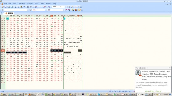

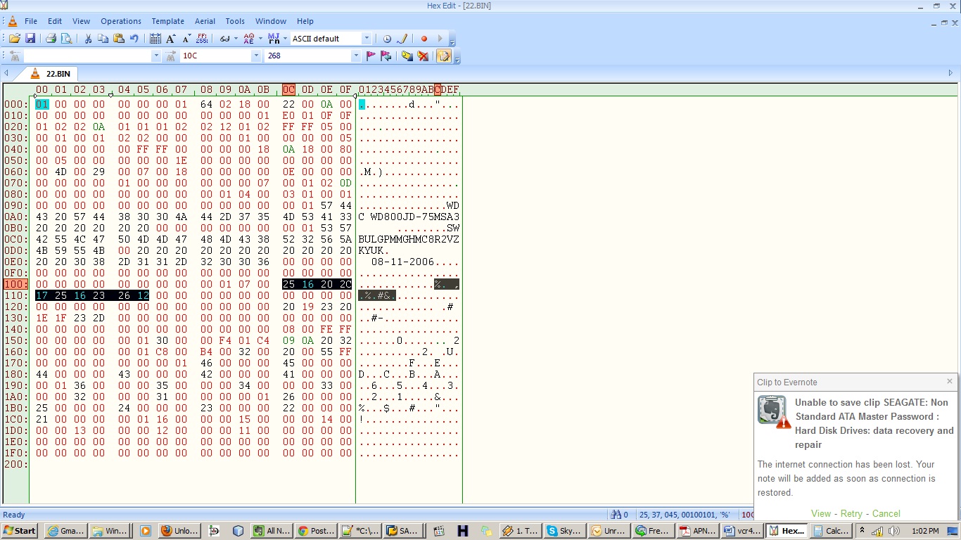

Hi, I have a wd800jd-75MSA3 harddrive that a friend brought me,she needs her photos which are on it but can't access it. Its locked with an ATA password.
So far I have run the script .dump in MHDD and now it has dumped the 22.bin.
I have found this string
25 16 20 2c 17 25 16 23 26 12
Am I on the right track to cracking this password?
I want to know how to enter this string so I can unlock the harddrive.
I have attached a screenshot of 22.bin in my hex editor program.
Thanx all

PostPosted: March 12th, 2013, 17:15
Joined: January 7th, 2012, 11:48
Posts: 33
Location: netherlands
rudolphm
send the dump i will give you the password

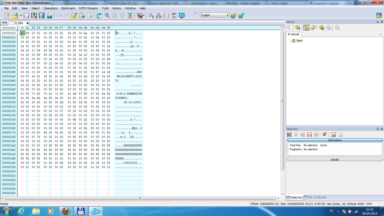

i have an emachine g730 with an wd 1600bevt hdd.
The hdd password was made with the bios.
I have forgotten the password and now have big trouble to retrieve it.
I have made a screenshoot of the 22 image, but i don´t know where to find it.
Can anybody here help me ??
Best regards
PostPosted: April 30th, 2013, 1:09
Posts: 1898
Location: In your hard drive.
The User and Master passwords are clearly visible. Research page 3 of this topic.
