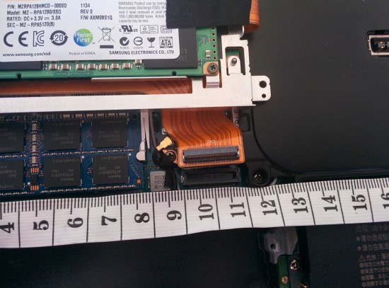

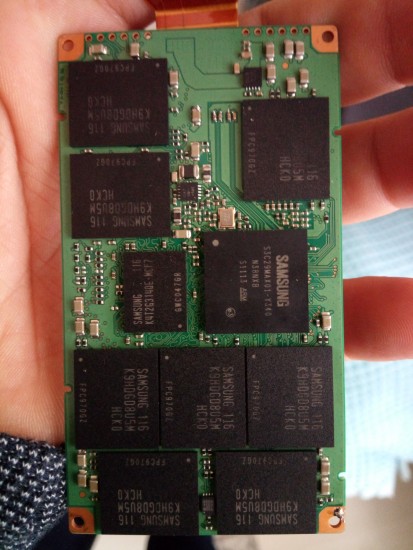

Hi all,

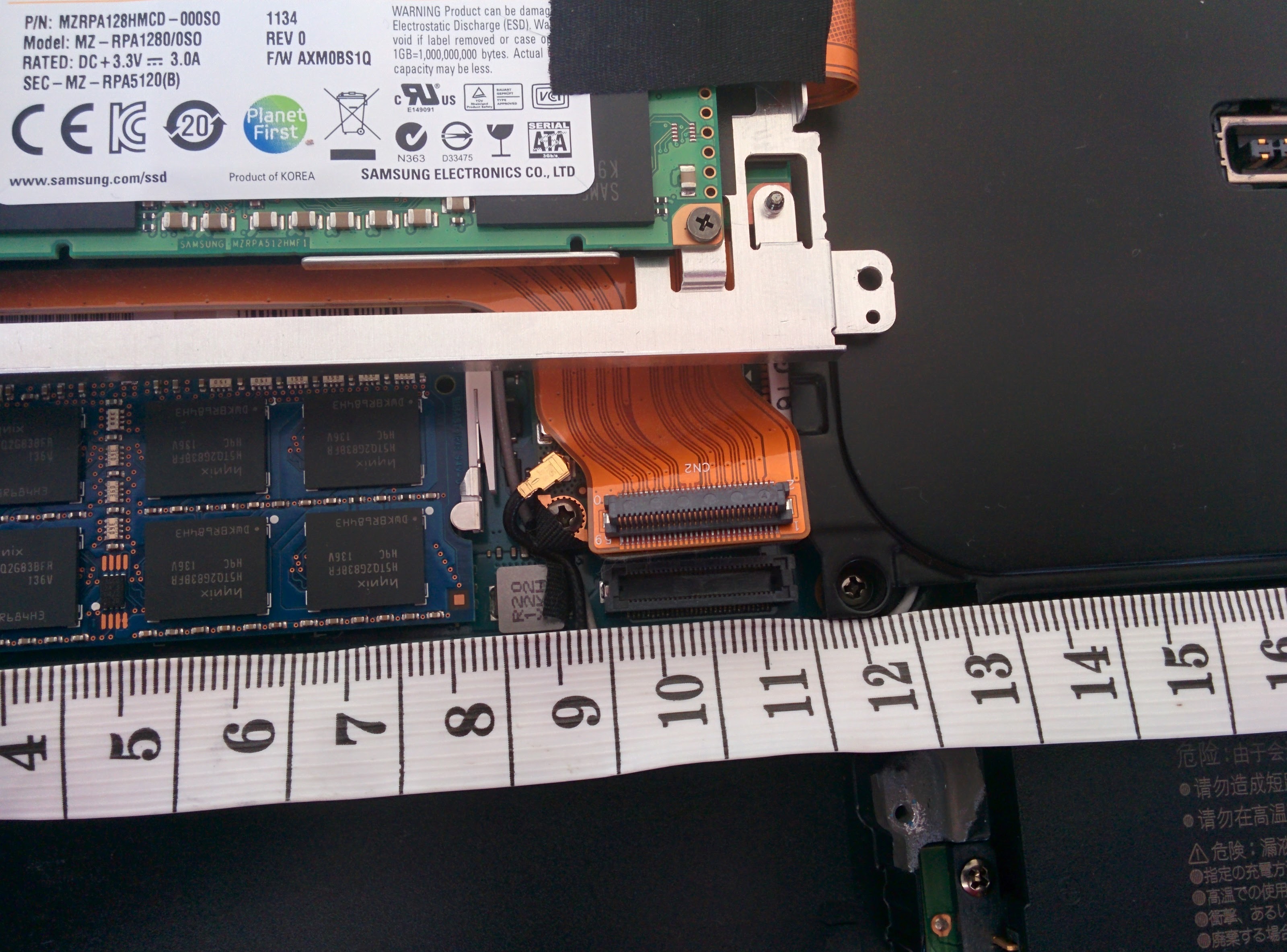

Slightly different question here, but I believe some of you may now this: Is there a way to connect a more standard SATA SSD to the 60-pin socket on those RAID-0 VAIO motherboards? Or am I stuck with the LIF SSDs on RAID forever now?
In my case it was the Samsung LIF SSD which failed. Luckily no important data there. Vaio is all fine. Would like to put a standard and more modern SSD back there. Any thoughts on how to do this?

do you mean like this:
http://forum.notebookreview.com/threads/upgrading-vpc-z1-with-quad-raid-to-1tb.655886/
 Post subject: Re: Samsung RAID LIF 128GB SSD, any adaptor for it?????
PostPosted: September 14th, 2015, 7:01
Joined: September 13th, 2015, 10:37
Location: Dublin, Ireland
HaQue wrote:
No, that's way too complex, and I'm looking to connect a simple SATA drive (like this one: http://www.amazon.com/Crucial-BX100-250GB-Internal-Solid/dp/B00RQA6TEI/) in place of those RAID0 LIF SSDs. I found this cable and am thinking to give it a try: http://www.ebay.co.uk/itm/321387688269?_trksid=p2060353.m1438.l2649
Then I'll need a proper caddy for it too: http://www.ebay.co.uk/itm/131518218620?_trksid=p2060353.m1438.l2649
Just wondering if that will work.

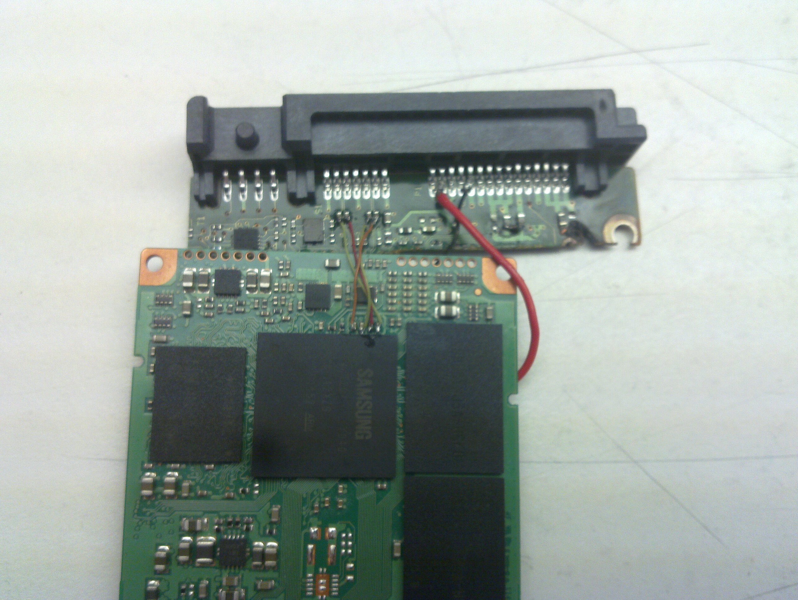

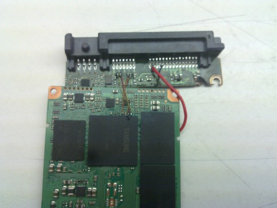

Dear all,
I'm trying to inteface a 512Gb to SATA using info provided by Fzabkar, trying to follow the image pinout it doesn't work for me, could you post a better detail image or pinout of the image where you stroke SATA tx/rx SSD top, which one are tx and RX?
Thank you in advance
PostPosted: December 17th, 2015, 19:01
Posts: 488
Location: US
Something like this.
PostPosted: January 5th, 2016, 17:54
Posts: 488
Location: US
I could solder wires, read your ssd like I showed in picture above.

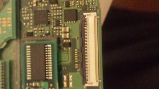

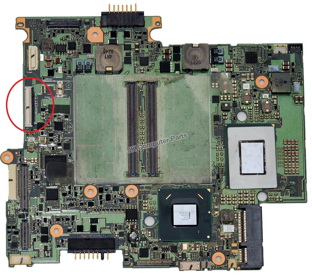

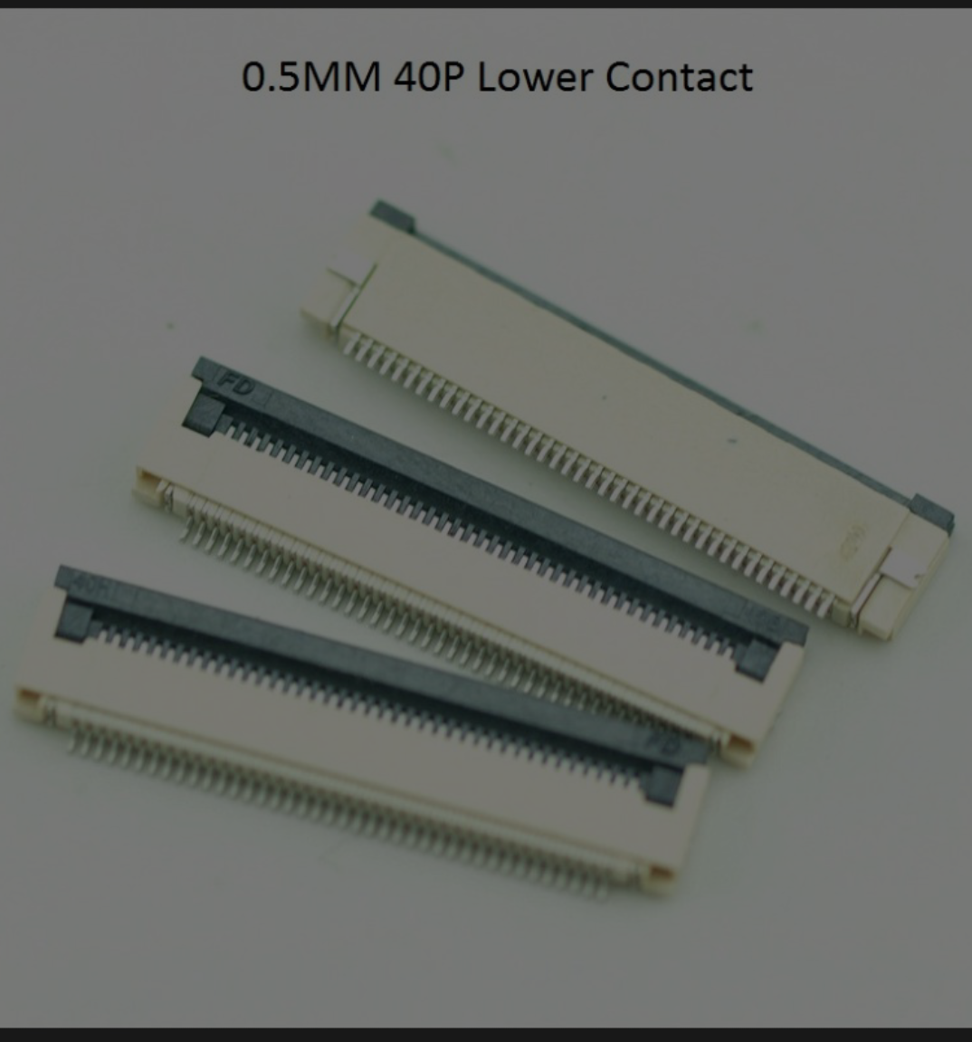

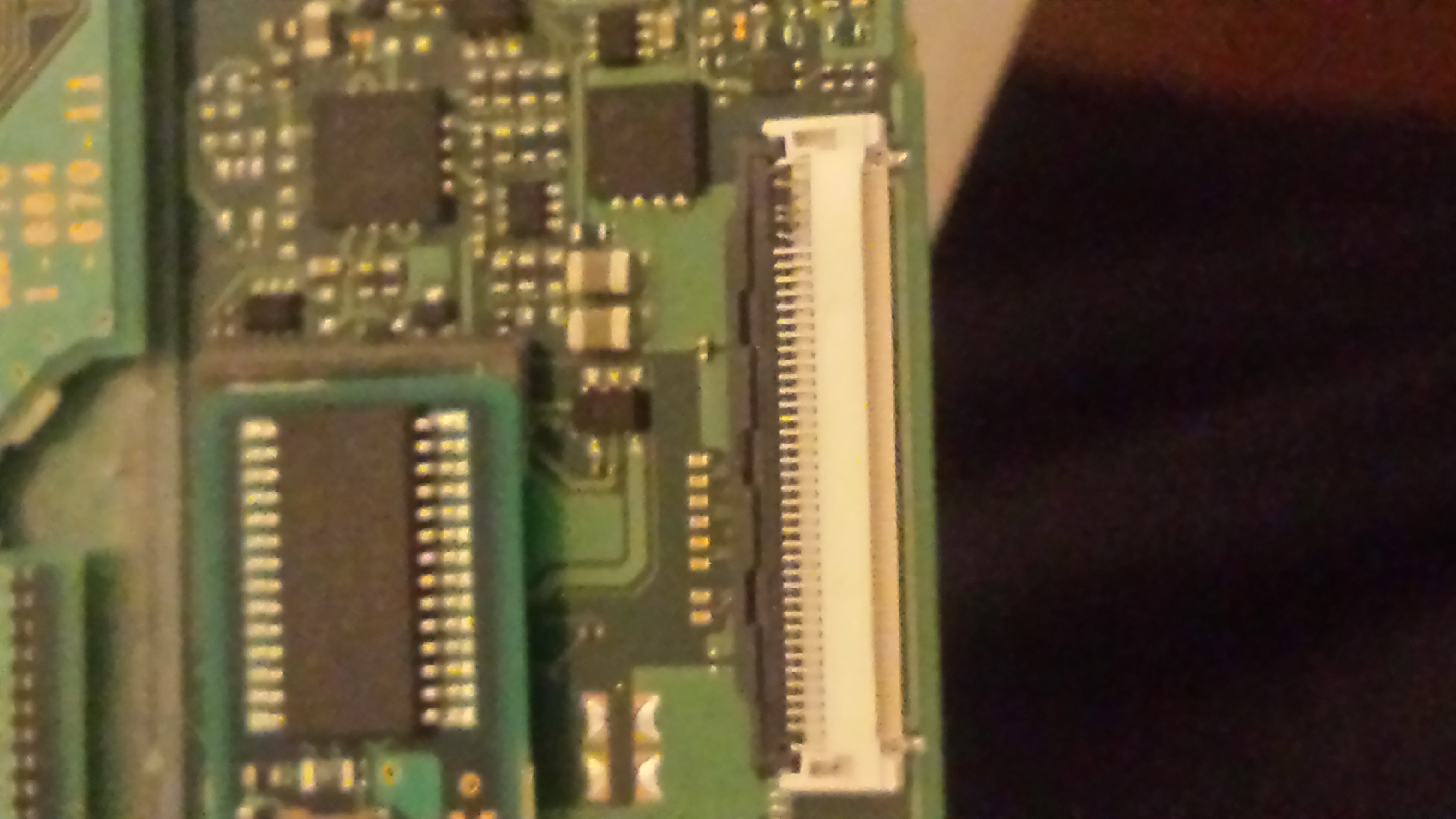

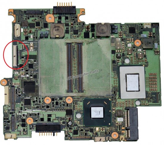

Dear users, Does somebody now where i can get this connector or what exact name it has to order it from ebay. The pins are broken.
PostPosted: March 24th, 2017, 17:58
Posts: 791
It's a LIF or ZIF surface mounted connector.
count pins and see what you find at mouser.com or other electronic suppliers. You may even find one on old hard disks. Fujitsu and Quantum spring to mind
https://www.mjm.co.uk/

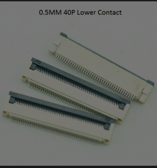

How many pins does it normally have?
Could it be te following attachment?
PostPosted: March 25th, 2017, 16:48
Posts: 791
Count the pins, measure the length, width and pin pitch. The check the specs for those. I think yours MIGHT be 44 pin but you will have a clearer view :)

Posts: 17335
If the broken pins are power pins, then it should be very easy to run jumper wires between the appropriate points.

How should I jumper wires?
I also don't know what the functions are of the pins.
The problem is also that I don't know how many pins there are in total.

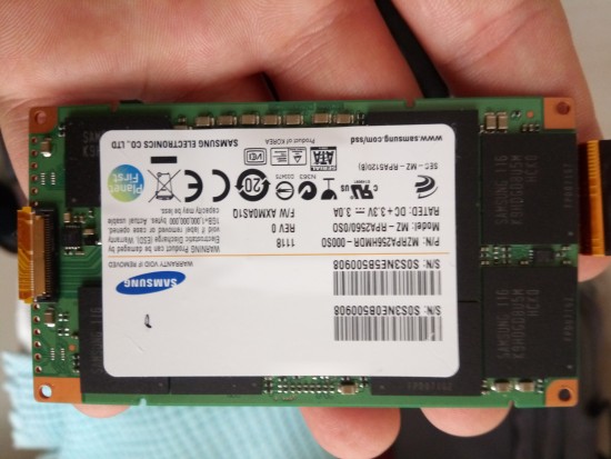

Location: TURKEY

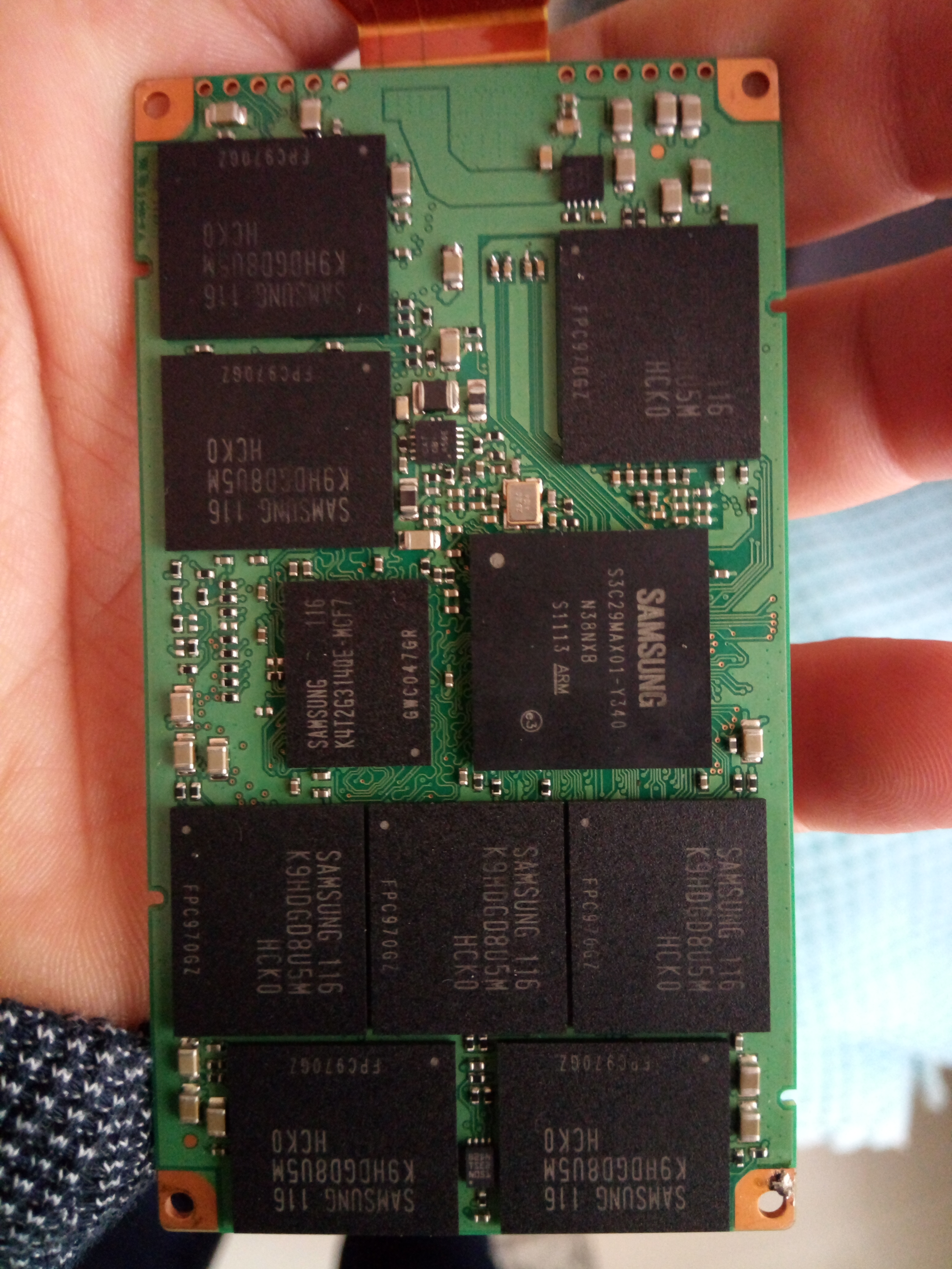

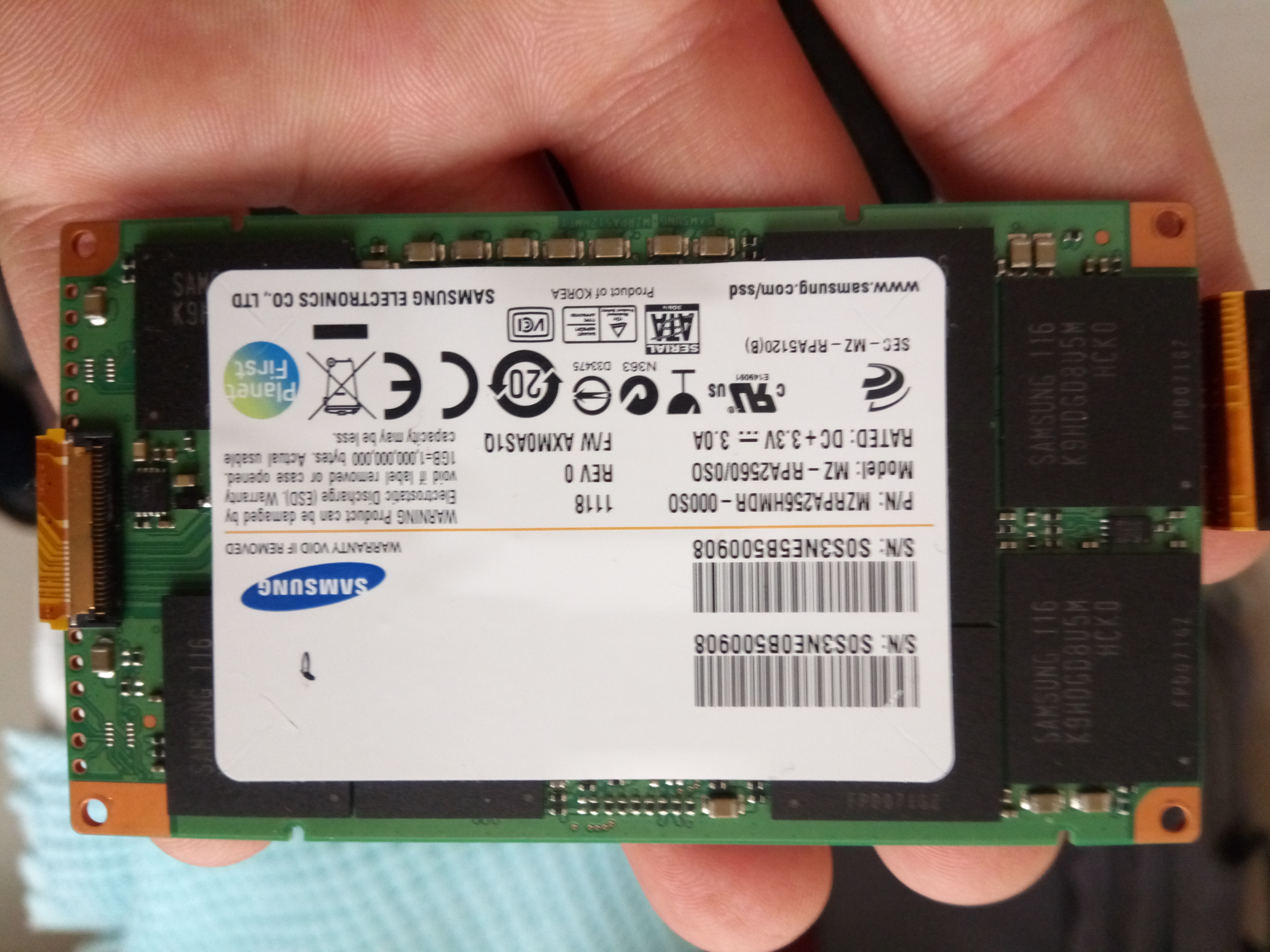

I have 256 GB lif SSD for VPCZ2 . Which pins should i use to connect sata? Does anyone help me?
PostPosted: February 6th, 2018, 16:32
Posts: 17335
IMHO, the easiest way to identify the SATA pins is to find an SSD with a regular 22-pin SATA connector (15 x power, 7 x data) and with the same flash controller, in this case an S3C29MAX01-Y340. Then follow the Tx/Rx traces from the SATA connector back to the controller.

Think this model is a 2 x 128 GB drive. So prepare to clone 2 drives and some RAID0 reconstruction.
