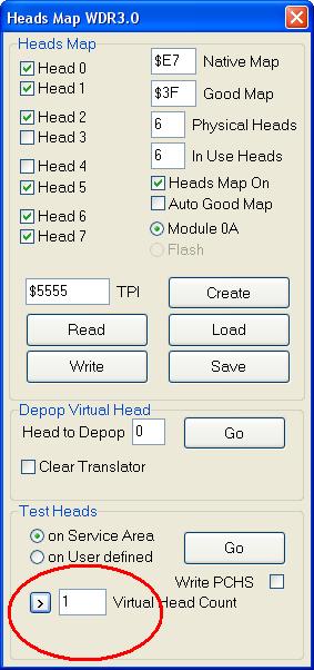

Maybe i understood what's wrong on head map...
If i push the button in the red circle, it counts only 1 head:
So i think it can't load SA because 5 heads are off or not counted in head map...
It makes sense for you?

Now if i push the button in red circle i get always 6, :lol:

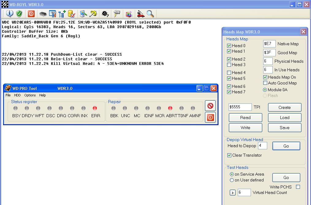

 Post subject: Re: Need firmware for pc3k WDC WD20EARS-00MVWB0 25.12E
PostPosted: April 22nd, 2013, 14:01
Spildit wrote:
You have a messed up head map.
Tick the 4 first ones and untick the others. Then save.
No!
0,1,2,5,6,7 is valid head map for SadleG6 drives
PostPosted: April 22nd, 2013, 15:26
Logical vs Physical
Not always the same
Typical 2Tb SadleG6 has physical 0,1,2,3,4,5 (i.e. all populated) but logical (ROM head map) 0,1,2,5,6,7
As a typical 500Gb Tornado have 2,3,4,5,6,7 in ROM, but 0,1 are not physically missing.
I have no idea how WDR (or whatever software he used) decides which is which for "de-popping".

In the pic you can see that i have depopped head 4 on "virtual head"
If rom head map is 0,1,2,5,6,7, what physical head has been turned off?
(maybe head 5) :?:

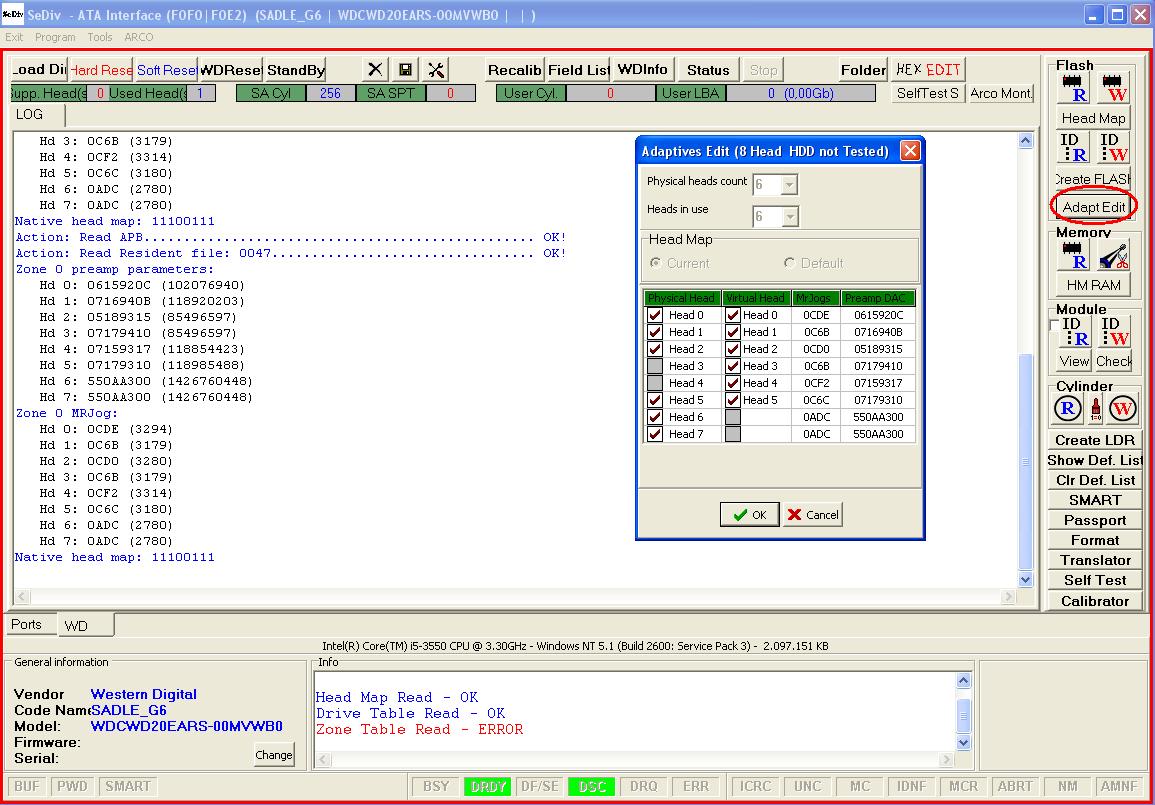

It's a "Road Map error", i don't know how to fix it.

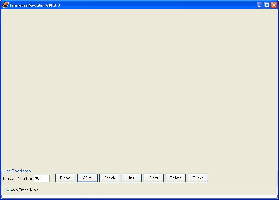

No it doesn't read, i get ~id0001.bad (0 byte) if i push "read" :shock:
P.S.
i copied the 01 module from my backup folder to WDR working folder, then i pushed "write" into w/o road map window.
Still i can't see modules.
P.S2
If i push once again "read" after i write 01 backup, i still get ~id0001.bad
