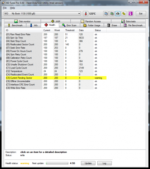

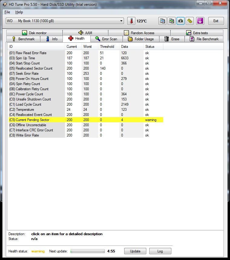

I finally achieved to access again to data. while I was trying to take printscreen of WDSW as you requested. I don't know why I suddenly saw once again the directory and it's folders. So I quickly run hd tune pro, he found the drive. went on menu health and did a printscreen.
Here it is:

yep, HD Tune doesn't work, try one of the other software that me and fzabkar suggest you.

 Post subject: Re: WD Mybook Essential 1tb smoke
PostPosted: July 18th, 2014, 12:52
Posts: 1768
Location: Verona, Italy
:shock:
seem that your drive reached the temperature of 123°C.
Also you have pending sectors, this means that there are bad sectors or heeads are getting bad.
I think the high temperature as damaged the drive inside.

0383A wrote:
strange from outside I can touch it, it is even not hot!
I don't mean now, but when there was attached your faulty pcb.

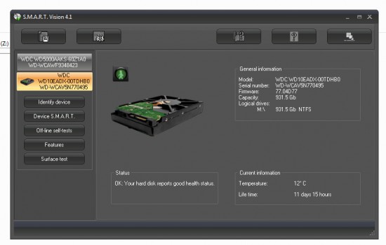

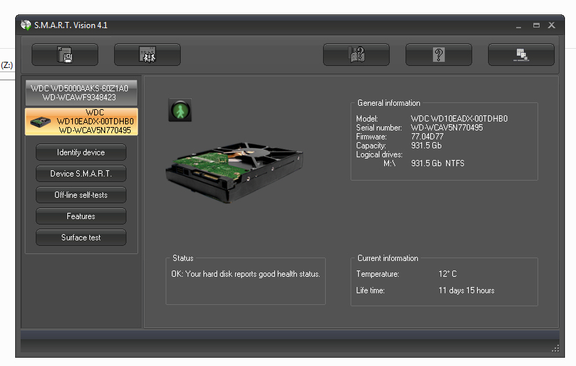

Actual temperature of the drive is 12°C . Thank to the bad and cold weather. here is the 1st screen caps for Smart vision 4.1.

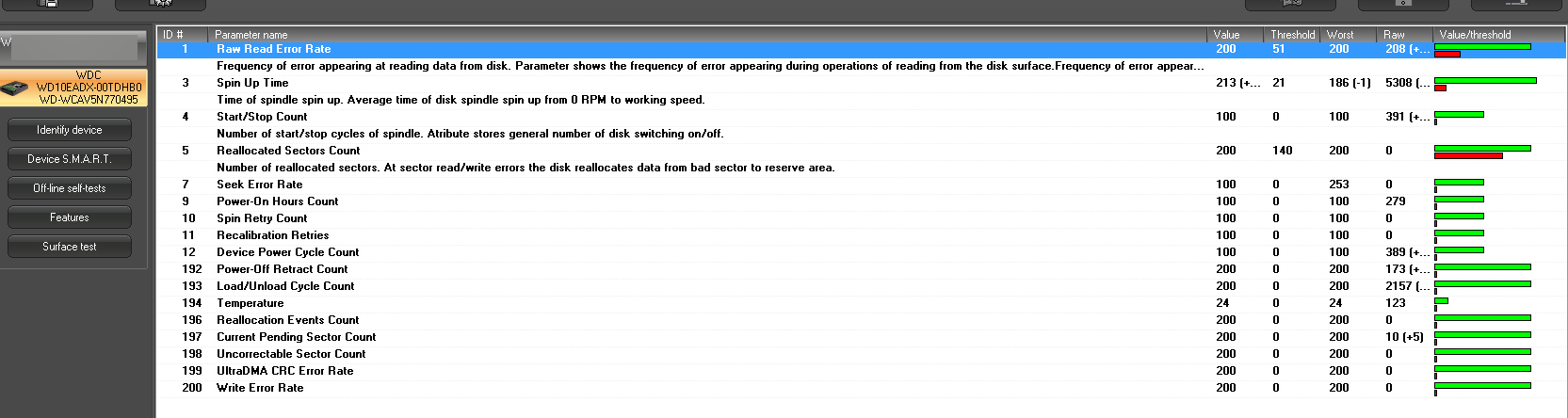

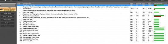

Clic on "device SMART" and show us.

Here are some more details from Smart Vision on this screen caps.
