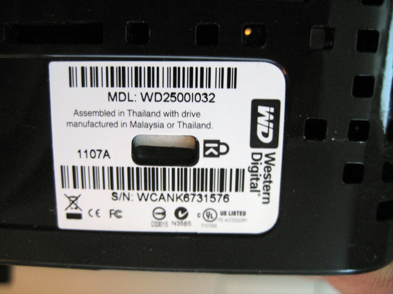

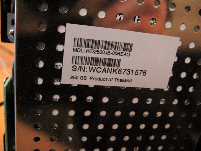

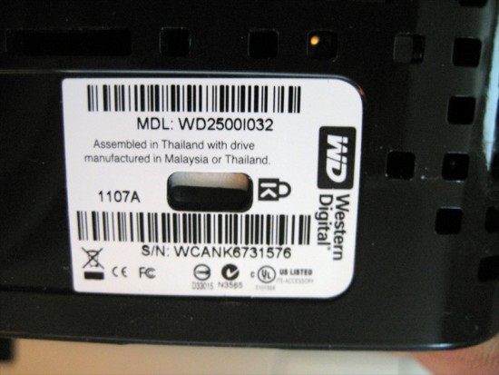

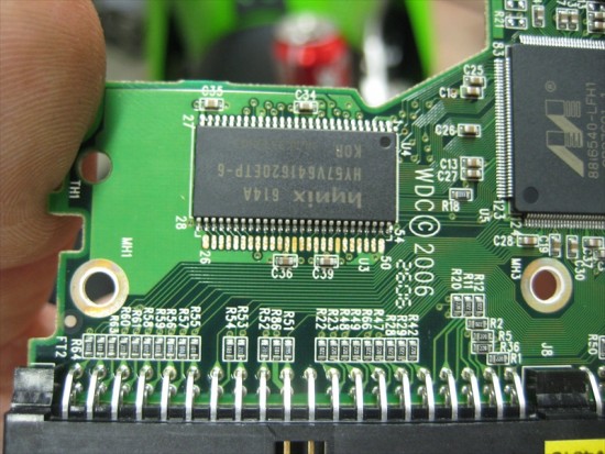

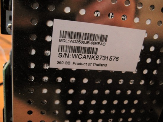

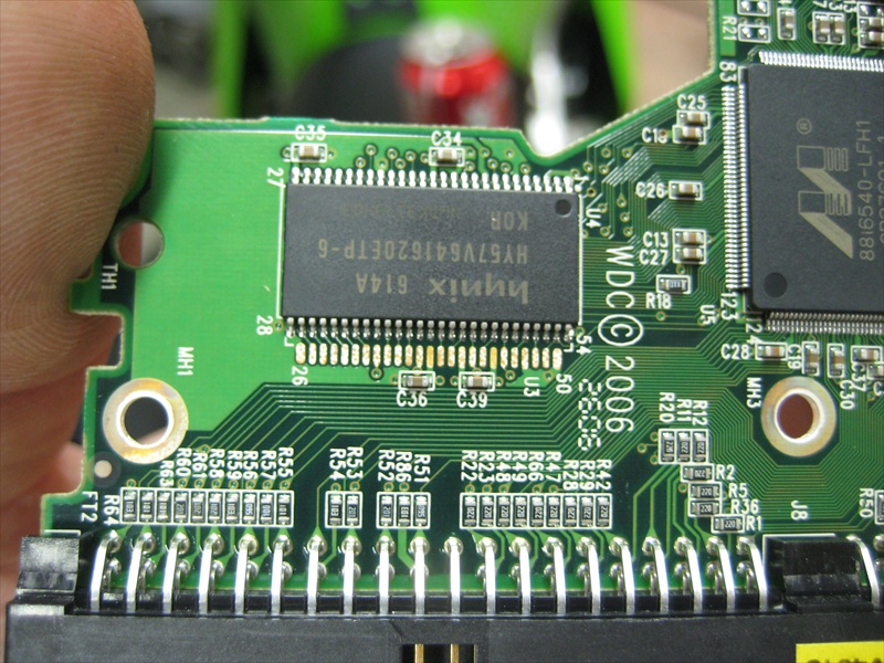

What happend: I mixed the powercable from my laptop to my external HDD.
So my HDD got 19v, 3.42A instead of 12Vcd, 2A as it should have, so its broken now. It wont start.. :cry:
The specification is at the pictures ive posted:
All the photos and texts is priceless for me so if anyone know how to repair it i will appriciate it alot
My theory is that the discs are okay, but the steeringcard had to much power and broke. So maybe i can replace it if i find an exacly the same kind och HDD and swap the steeringcards, if its possible?
/Freddy

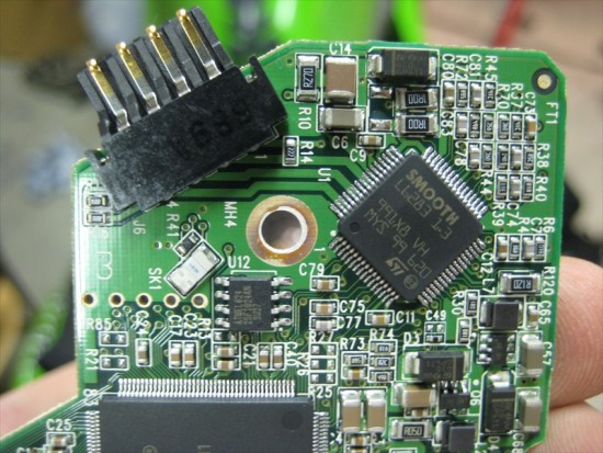

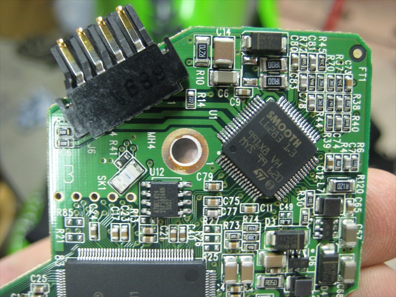

It should be this one wich is burned? in that case, where do i find an identical one most likely? Ebay? WD company?
Japp, bor i Umeå
Edit: ive taken out the HDD out of its external casing, and tried it as an internal HDD in a home computer, without any results, still dead. :shock:

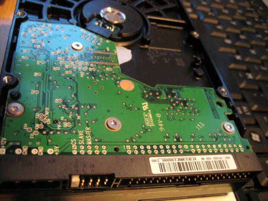

unscrew the board, flip it over and post a GOOD picture of the area around the power connector. if your data is so important though the best way is with a pro.

I recommend Bosse (mr_spokk) from Sweden. You need him to transfer the ROM from your burnt board to a good one, and extract your data.
I know for a fact he's done loads of these successfully, and you need Pro help.

 Post subject: Re: Extern HDD broken, please help
PostPosted: October 8th, 2008, 17:59
Joined: October 8th, 2008, 9:08

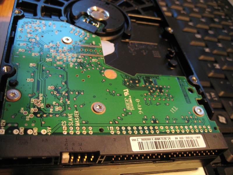

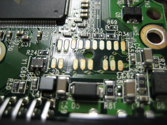

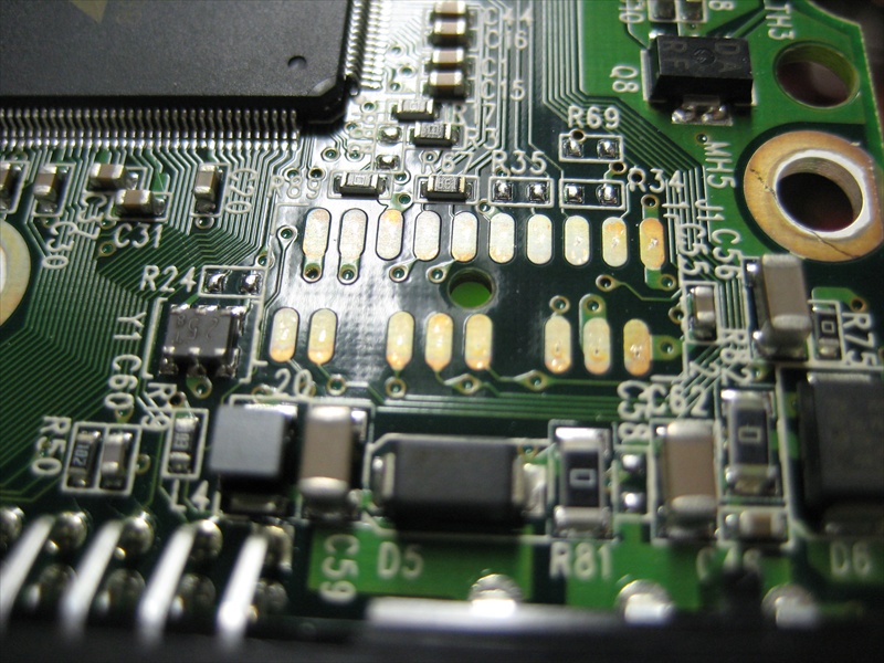

Here you go:

How proficient are you with a soldering iron and a multimeter?

the stuff on that third picture, test it, with a tester

Hi, screw the third picture, this is not Seagate...sorry "mediaman".
You got PM.

Well, if you're curious, you can search for TVS on here. However, it won't be terribly helpful if you can't test components with a multimeter, or replace them with a soldering iron.

mr_spokk, can you please elaborate? What do you mean? :)
I can clearly see 2xTVS (D5, D6) on the third picture

Hi guy's, sorry for the harsh criticism...hope I've not offend anyone!
But I've rarely seen a WD suffer from TSV problems, even after a current spike or wrong current inserted.
On the other hand I've quite often seen numerous of Seagate drives suffer of TSV problems...
