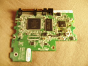

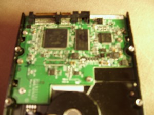

Thans for the clue but I don't really know where is the ROM, If that may help, I took two pictures, one of the old PCB and one of the new.
The pictures are a 'bit' blur because the camera is really bad, if you need something more sharp just tell me.

 Post subject: Re: Maxtor DiamondMax 10 200GB 6B200M0 PCB Change
PostPosted: April 11th, 2008, 0:09
Posts: 3598
Location: Chicago
ROM is 8-pin-chip with inscription contained 25...
PostPosted: April 22nd, 2008, 7:19
Joined: March 21st, 2008, 15:07
Posts: 6
Thank you for the advice.
Rom has been changed from the old PCb to the new one, but the problem is still the same.
I noticed that the strange noise was there even when I just plugged the power supply connector, and not the SATA one, so it is like the heads fail to calibrate or something like that.
Do you think something inside is broken ? Or the PCB I got was not so compatible ?
