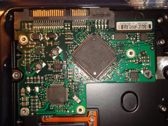

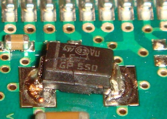

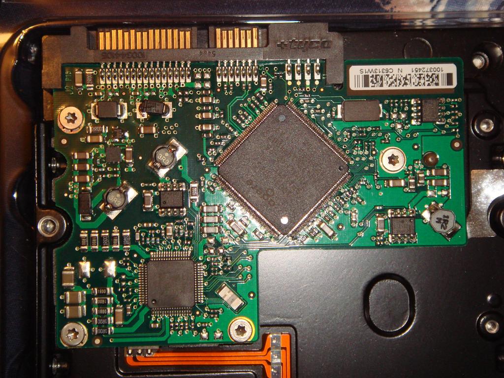

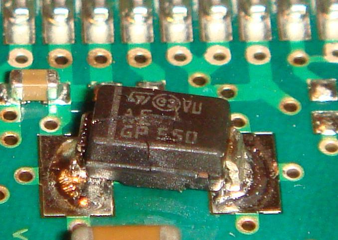

Whilst trying to transfer data from a Seagate Barracuda 250GB 7200.9 Ser:4ND2DEV7 with a USB converter I stupidly got the IDE power supply connector around the wrong way (as hard as this might seem to do :oops: ) pushing it into the receiving connector of the adaptor. This smoked one of the components on the HDD circuit board. I'm hoping it is a protection cct of some kind and that replacing the obviously damaged component will fix the issue. Can anyone help me in identifying this component (see image) When I plug the hard drive in now with the adapter around the correct way it still smokes and the drive dosn't spool up. :(
Many thanks
Oh in the wider shot the component is the one at the top of the picture close to the SATA connecter second in from the left (on a bit of an angle)

Remove it. If you were lucky enough the damage was limited to the tvs. If not, we'll see.

In further delving on the forum a found this thread really helpful explaining what TVS diodes are and how they work.
http://forum.hddguru.com/seagate-300gb-hdd-fried-need-help-repair-pic-inside-t9758.html?hilit=What%20are%20tvs
I'll let you know how I get on.

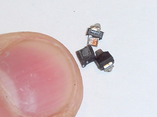

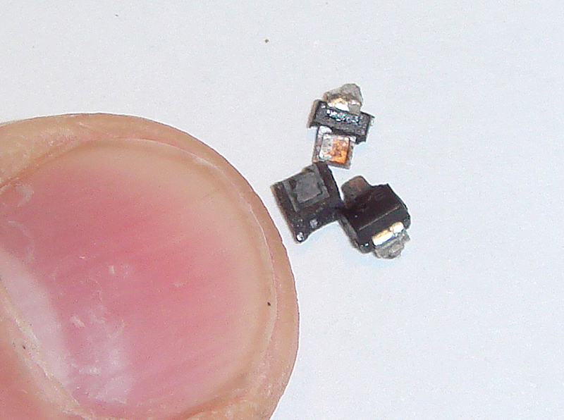

Many many thanks guys. I did as you said BlackST and just removed the diode and off it went. I'm transferring data as I type this! :D :D :D
and for you wiseleo...here is what remains of the offender....
again many thanks guys, much appreciated!

To complete work, replace the tvs - it's a protection device. And use the drive again as secondary or for non critical storage.
