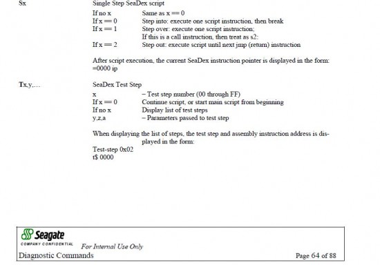

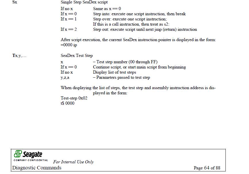

are you meaning this commands for seagate?

networkpc3000 thats the old one.

sorry, Terranova is right, i have the old one. i make mistake....... :(
