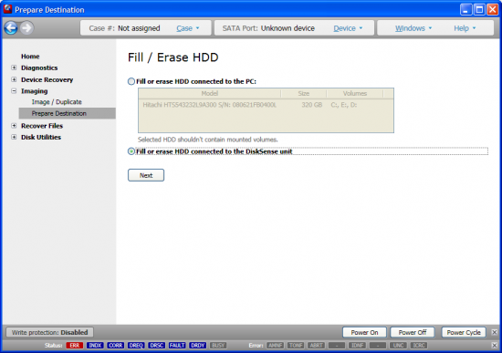

Also, there will be some more options for zero-filling in the upcoming release (this week) - see picture below.
I will look if we can move or copy the security erase functionality into that form as well since it is the most convenient way to zero-fill hard drives.
And, within couple months we will replace the current Insight's imager with the new one that will completely resolve this issue so that you won't have to worry about zero-filling anymore.
