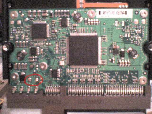

Yesterday went home and attached external HDD to power, but no effect, just a smell.. I examined the power suply, found a gap, opened it and found 3 elements cutted of by radiator, that's grounded. So, i attached the HDD to PC, pressed ON button, no effect. turned just the PC's power suply on mannually, after attaching just HDD, no effect. Turned on Power suply and attaced the HDD, the power turned off. By examining the HDD, found a small gap in a black square form element with two legs, close to power input, that connects ground other plate.
So my question is, if there's a hope to bring the HDD back to life by my self and your help? Is it possible to find matching plate and replace with it?

Remove this element, just snip it off.
Your drive will almost certainly work again long enough to get data off.
Then throw it away, don't trust it again.

Search the forum for TVS, you'll find plenty of info about it.

can you post PIC?

networkpc3000 wrote:
can you post PIC?
Sorry, bad quality.. tomorrow will be better..

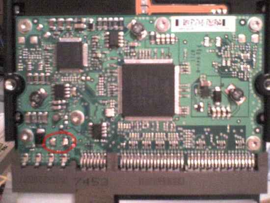

I circled the place, where was this element..

That was it..
All data I needed were saved to a safe place..
The HDD disapeared from My Computer, I turned it OFF, then ON and blue smokes came of the HDD.. So it's officially dead, but lucky saved the data! TNX again! :mrgreen:

That component protects the rest of the PCB from excessive voltage... I might start to be concerned about your power supply.
The drive works fine without it, but you could think of it as similar to a fuse. The fact that whatever blew the TVS then blew the PCB indicates to me that you have a power problem.
