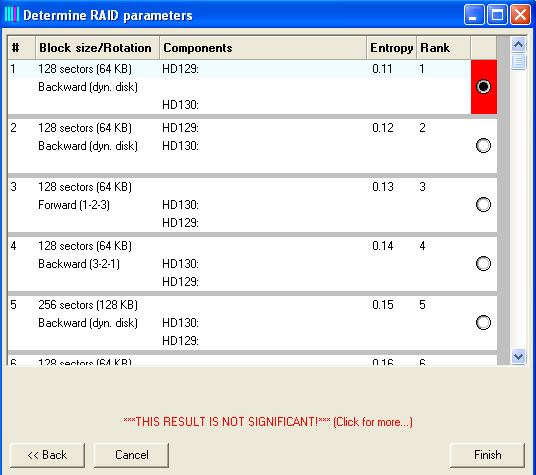

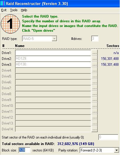

We have plugged the hard drives into another machine and tried both RAID Reconstructor & R-Stidio to reconstructor the corrupted RAID and the following are the result.
RAID Reconstructor

In my opinion raid reconstructor is useless in most cases, especially when one drive is missing, it wont be able to find stripe size etc...
You are right that 2 out of three drives should be sufficient to retrieve the data, at least when they are not messed up.
Best tool for this is winhex in my opinion.
First of all you have to determine the correct parameters: stripe size, offset, forward or backward, dynamic or not.
Winhex is very good at helping determine that, but you'll need to do the thinking.

After some googling, I found the complaint of "The result is not significant" means required information like stripe size, offset etc are not available/ sufficient :shock: why would it be missing/ insufficient while the other 2 drives are still functioning properly?

RAID reconstructor does not cater for all RAID 5 types and this could be your problem. Winhex covers most (as does R-Studio).
Winhex and a good understanding of the file sytem you are trying to recover will get the job done.

What is RAID controller, or motherboard model? you say Windows did not load, so FS is NTFS? RAID Reconstructor supports NTFS and should at least display an OS value such as OS1. OS2 etc. Maybe your RAID uses a header? Did so called IT Expert reinitialise raid while in incorrect order? Was RAId reinitialised in incorrect order with a replacement disk?
there are too many factors here that can potentially cause a serious loss of data. If data is of any value you need to consult a professional
