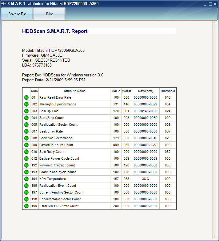

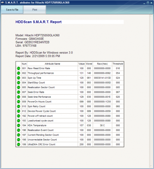

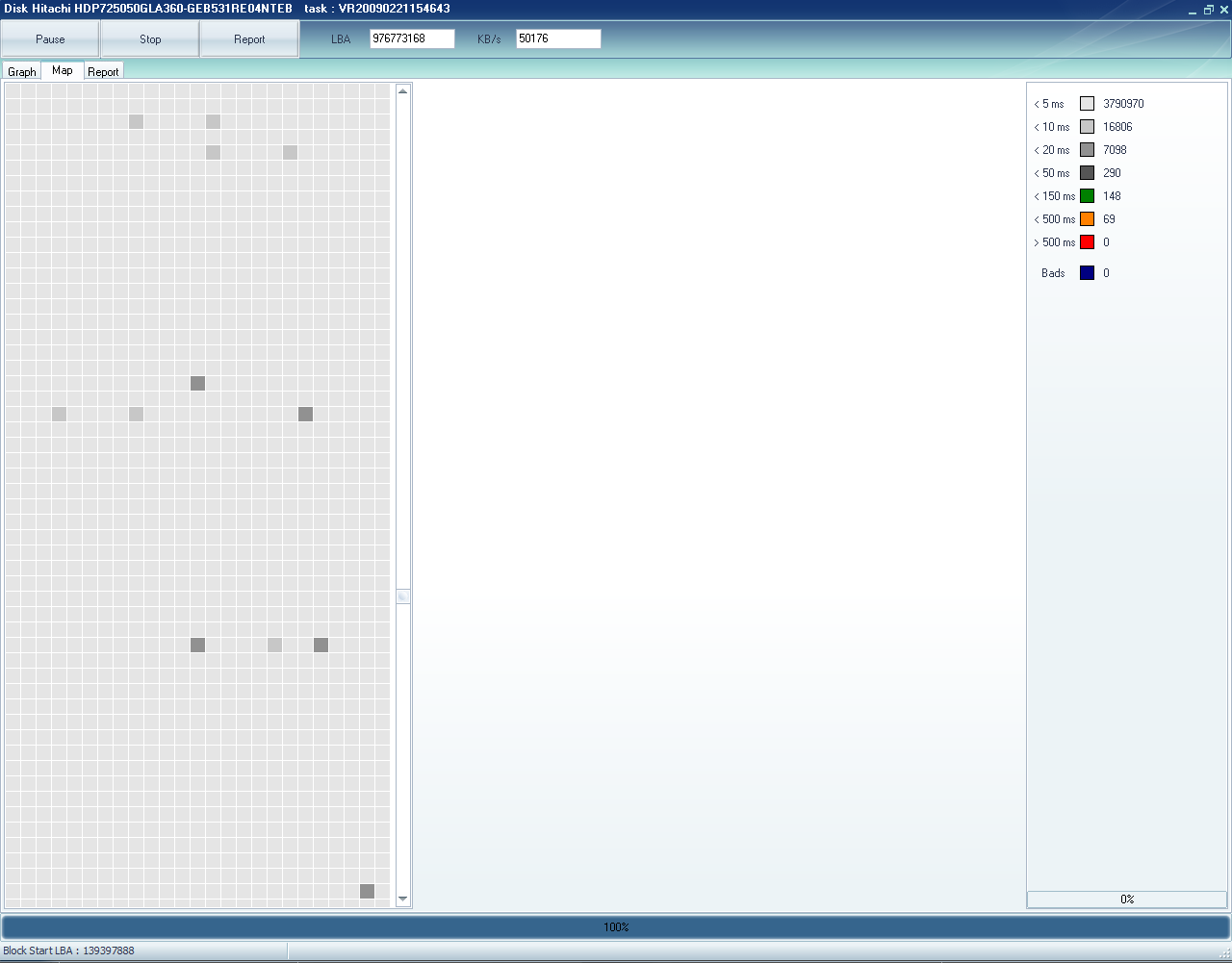

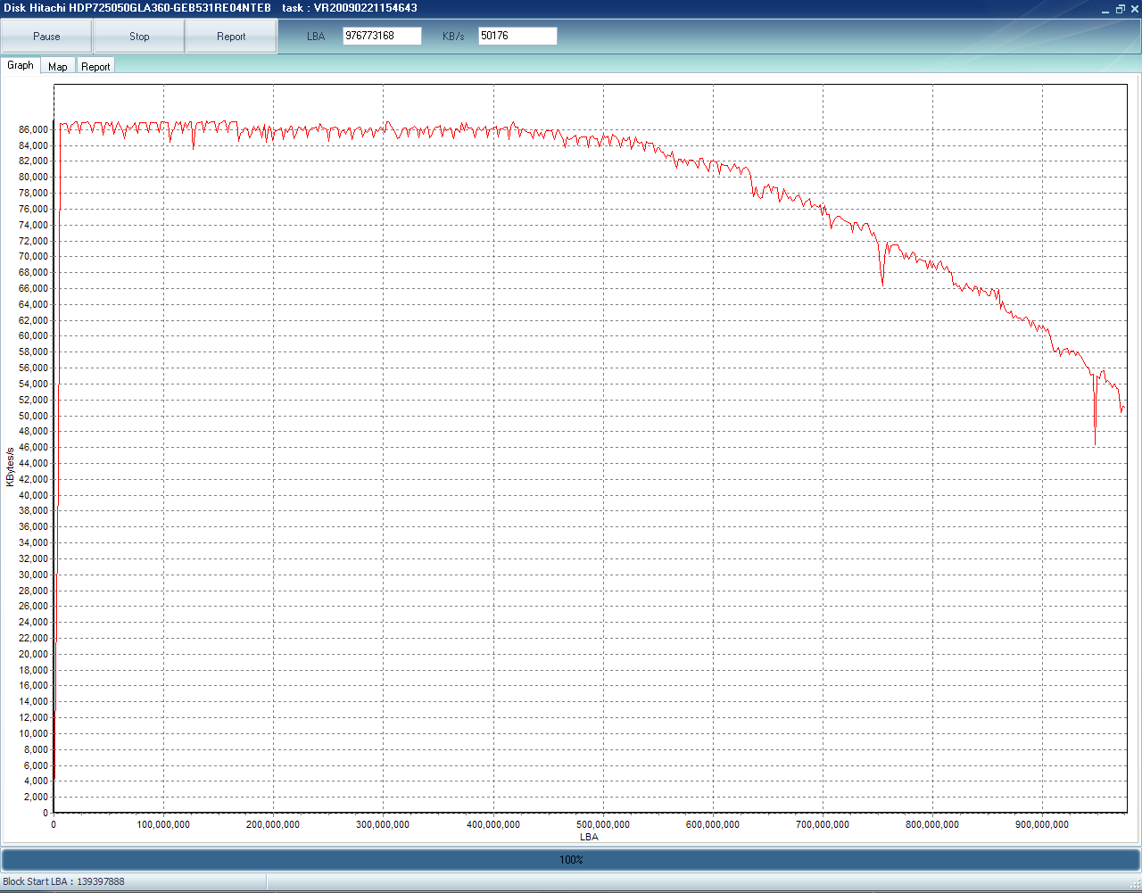

Hello all,
About a year ago I purchased a 500gb Hitachi HDP725050GLA360 drive and it's been very quiet and fine until about a month ago when it started to develop an on/off vibration (a low level "elliptical" humming that vibrates the case and is very unnerving - it feels like a wobbly bicycle wheel turning slowly). Then the drive developped an additional problem: the motor revs up and down very loudly at cold boot time, in a jerky sort of way, after the system's been inactive for a few hours, and only settles to normal after a few minutes (could be related to fairly cold temperature in the room).
I tried to tighten the drive in the case but the irregular vibration is still very ennoying. The drive is full of data with about 25-15gb of free space and it's been like this for a year. Max temp at any time 42C.
Attached are results from latest HDDScan tests (SMART and VERIFY). Previously I've run hitachi ftool and it didn't report any problems.
Should I try to RMA it?
Verify-blocks-address.txt [15.55 KiB]
Downloaded 605 times

Worn bearing. Failure is 'imminent'. Rma.

It won't get any better, in fact, it will get worse faster and faster. Bearing wear causes vibration, vibration kills bearing, and on and on it goes.
