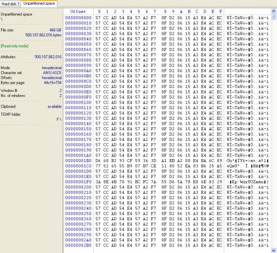

I have a Lacie 500GB external hard drive SAMSUNG HD501LJ Where the power adaptor failed and the data is gone. Yes, GONE.
I have scanned the drives for HFS+ or any others but found nothing at all. Rstudio, nucleus, mediatools, x-ways, etc etc, nothing found.
Weird, does anyone have this experience in the past?
The drive Samsung HD501LJ checked using UDMA and all working fine.
 Post subject: Re: Strange Lacie 500GB external hard drive
PostPosted: February 25th, 2009, 6:35
Posts: 2984
How does the disk appear in Winhex?
PostPosted: February 25th, 2009, 6:44
Posts: 1493
Also check the disk in a hex editor (winhex). Save a lot of time. You should be able to see if data is on the disk or if it's all zero's. If 'data' can be seen try UFS Explorer, then try a file signiture search.

Winhex screenshot:
File header search, none found.

Is it the same values throughout the disk?
PostPosted: February 25th, 2009, 9:37
Posts: 1238
Location: inside ROM
no, i see some different data when i scroll it down.

Is it encrypted? What about results from a file signiture search?
PostPosted: February 25th, 2009, 10:27
Posts: 1238
ahhhhh HDD Spaz, you have given me a brilliant clue now, the LACIE has biometric finger print , maybe its encrypted after all. I'll check it out tomorrow. thanks.

I have worked with 128-bit AES encrypted flash drives where the raw contents look like this. That was my first guess.

Had one of these recently with the fingerprint scanner. Unfortunately customer would not send in his finger so couldnt recover :-(
Actually, customer was no help at all and as soon as I began explaining about encryption he requested his media back so never really got a chance to look at it. No doubt it will be difficult.

thanks guys, the drive indeed encrypted, I chopped customer's finger off to get the data. :D
