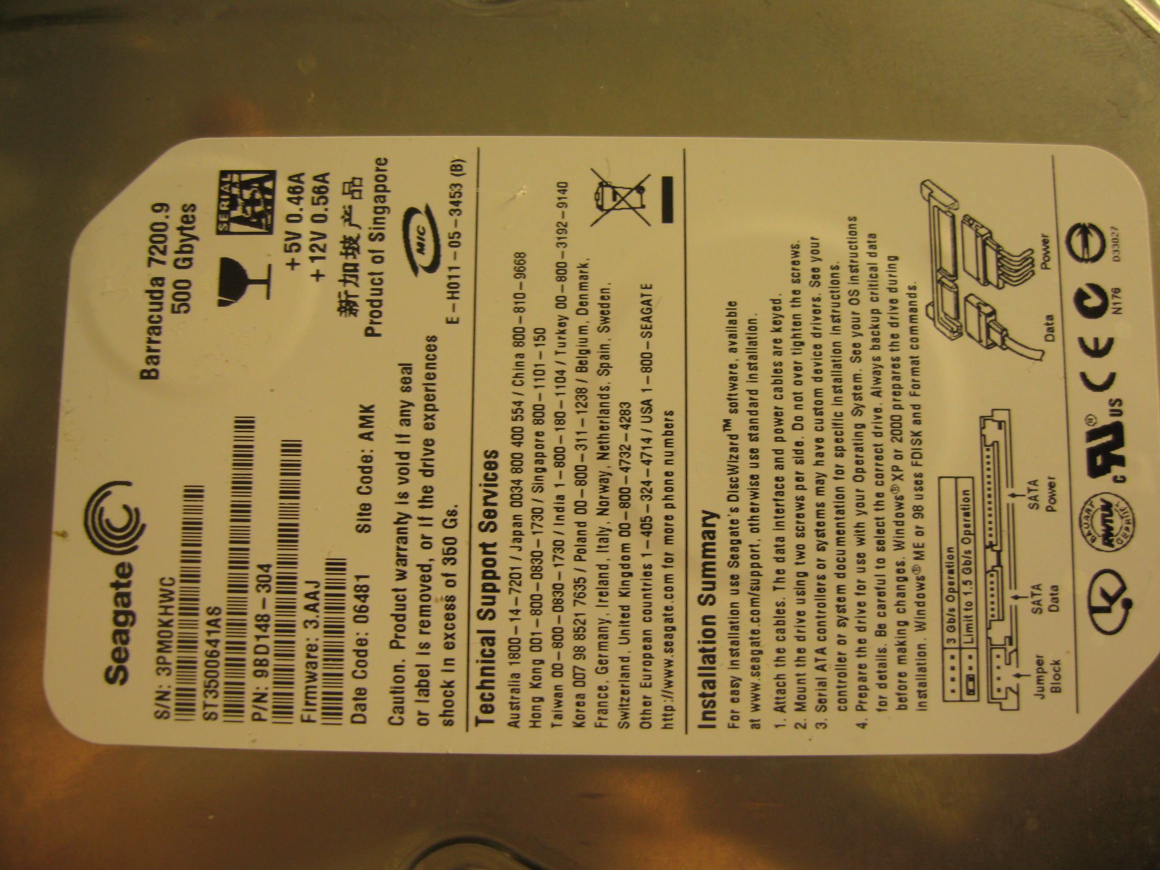

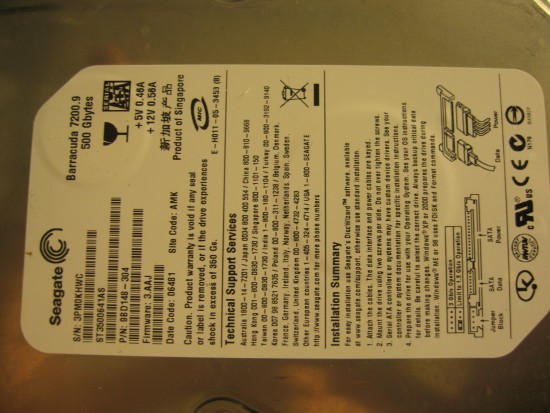

I am in need of a PCB for seagate barracuda 7200.9 500GB firmware 3.AAJ. Any help? Thank you.
Data on HD
s/n 3PM0KHWC
ST3500641as
p/n PBD148-304
Firmware 3.AAJ
Date Code: 06481

I think, You not need the pcb, you need professional help to solve the platter/head problem instead!

I want to try to swap the PCB board, as it has worked for me in the past.
Thanks for your comment.
Anyone have this hard drive? Thanks!

In this model a simple pcb swap is useless.
The pcb have some unique data, and you need to transfert this to the other.
Unless you have made another artifical problem(s).
Additionally, i am sure, your drive have head and/or surface problems....
(if you try your good pcb on another working simiar drive, that can be clicking again, because you have not match the unique data.)
