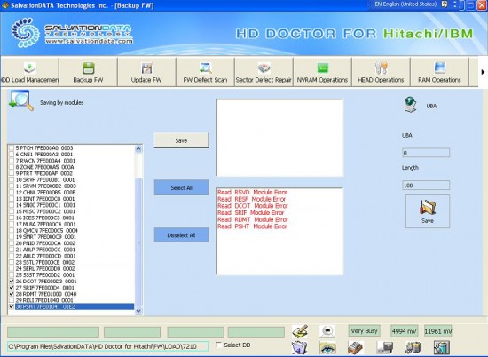

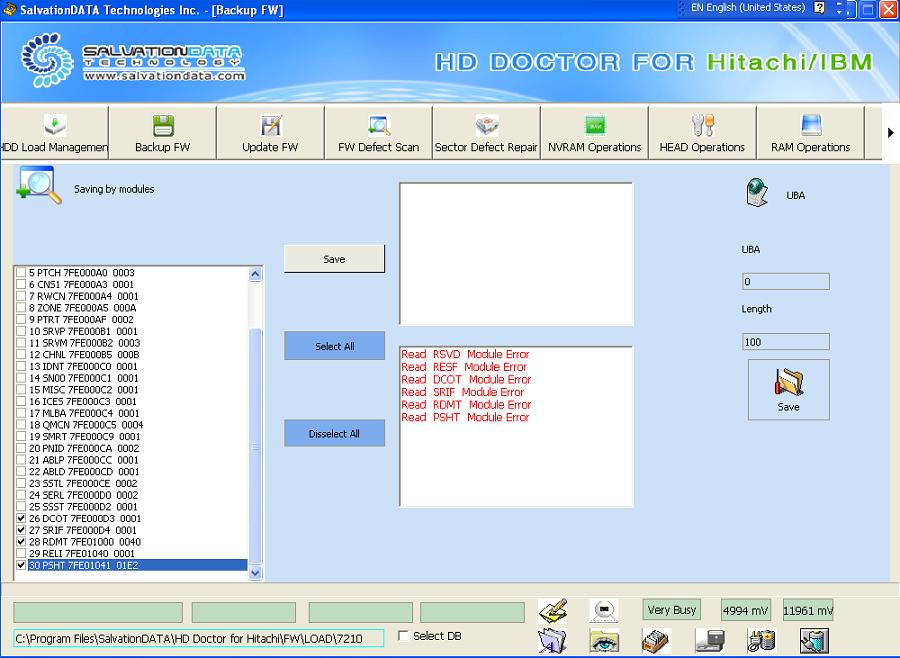

 Post subject: Re: HTS721010G9SA00 comes to Ready but won't go any further...
PostPosted: March 22nd, 2009, 4:22
Joined: February 1st, 2009, 4:43
Posts: 32
Here is the SA-C Back Up Screen
I noticed SA-A Back Up Screen has 20 more Modules than SA-C...
PostPosted: March 22nd, 2009, 4:24
Joined: October 2nd, 2005, 0:30
Posts: 288
Location: Jakarta - Indonesia
Is that really P-List (PSHT) on SA-C ? Damaged ?....Oh my..........How about P-List on SA-A ?
PS : Don't worry about PSHT damage. still recoverable with correct procedure
