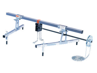

Create something nearly similar to "Engine hanger" in automotive equipments, however, you need to modify a lot with high precision needed.
http://ktc.jp/catalog/photos/ae901.jpg
Use your imagination :wink:
You won't be needing the chain in that picture for sure :D, but something else :wink:
hint : adjustable & lockable screw with pressure springs needed to hold the heads
