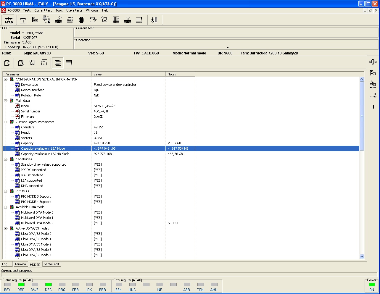

Got this ST3500830ACE,
can ID and read sectors (only in pio mode)
but cloning drive also in raw recovery i have all data as "garbage".
Looks like a general corruption, of SA and DA,
anyone faced this?

 Post subject: Re: Galaxy2D displayng corrupt ID and SN and datas
PostPosted: October 22nd, 2012, 16:11
Posts: 17234
AISI, it was obviously an issue with the IDE interface.
The first clue is the fact that every second character in the model number is corrupt. The IDE bus is 16 bits wide, and each character is stored in 8 bits ...
Other clues include the number of logical sectors, ie ...
32831 = 0x803F
This number should be 0x003F, so clearly there is a single stuck bit.
You could then refer to the IDE pinout to identify the failing bit:
http://pinouts.ru/HD/IdeInternal_pinout.shtml
ISTM that DD15 (pin#18) would have been faulty. I would have checked the soldering, plus the associated resistor.
