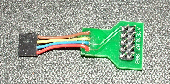

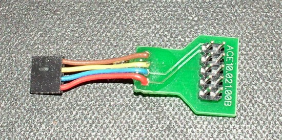

Well, here is an example of an PC3000 adapter for Seagate (I removed the delicate pins and used a small header instead).
As shown it works for Seagate. For Samsung, reverse the red and blue wires.
Jono
http://www.datasaversllc.com

jono-ats,
That looks surprisingly un-complex compared to the schematics here:
http://hddguru.com/content/en/articles/ ... schematic/
granted you did say it is an adapter from the pc3k kit, should i assume that what you are showing actually connects to something like the link above?
 Post subject: Re: Terminal connection on non Seagate drives
PostPosted: April 6th, 2009, 12:28
Joined: May 5th, 2004, 20:06
Posts: 2782
The Acelab serial adapter is a simple TTL<>RS232 converter
PostPosted: April 6th, 2009, 12:38
Joined: June 8th, 2006, 19:44
Posts: 3144
Location: Atlanta, GA
You'll need an RS-232 adapter if you don't have something like the PC3000.
The last poster is exactly right.
