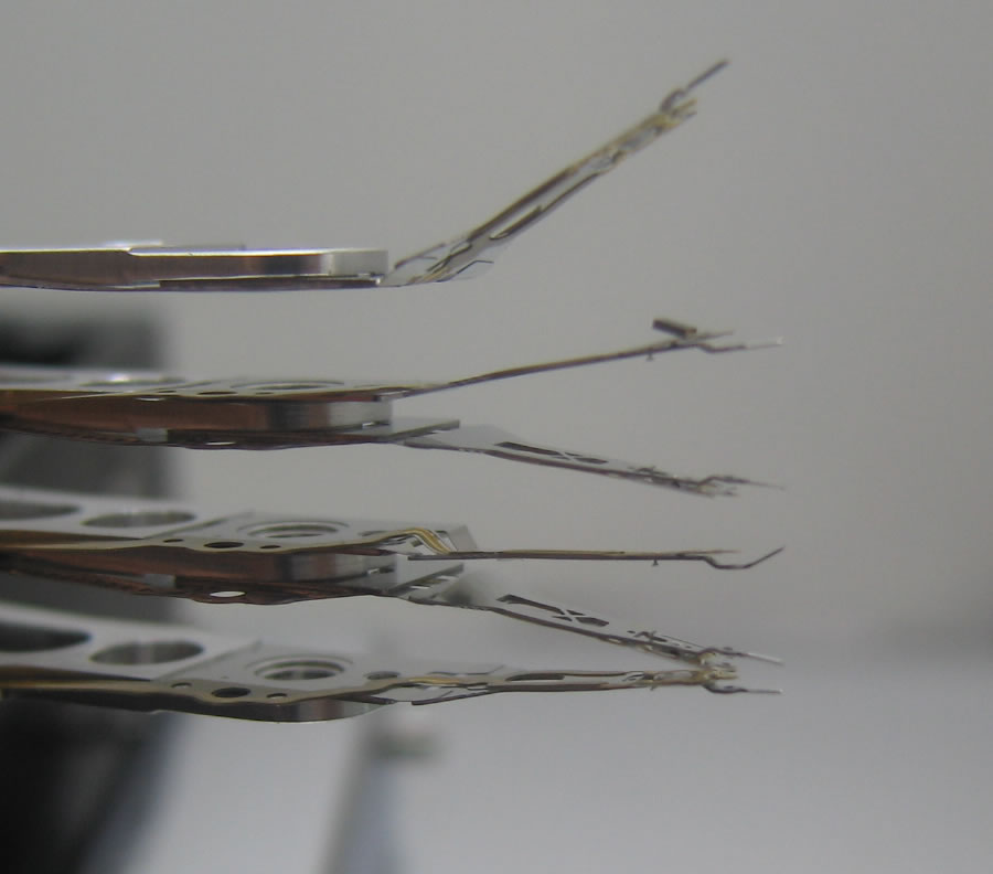

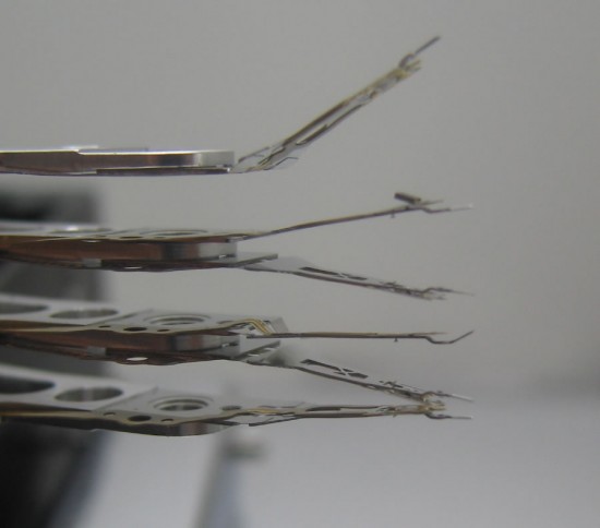

Hi to all,
i received this wd disk, and when i open it i notice that is missing 5 Heads, and i dont see the heads in the disk.
So if i dont see the Heads but the heads are somewhere in the disk.
I order a donor, and afther change heads in it try to callibrate 3 times them stop.

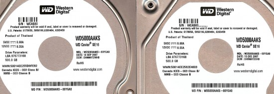

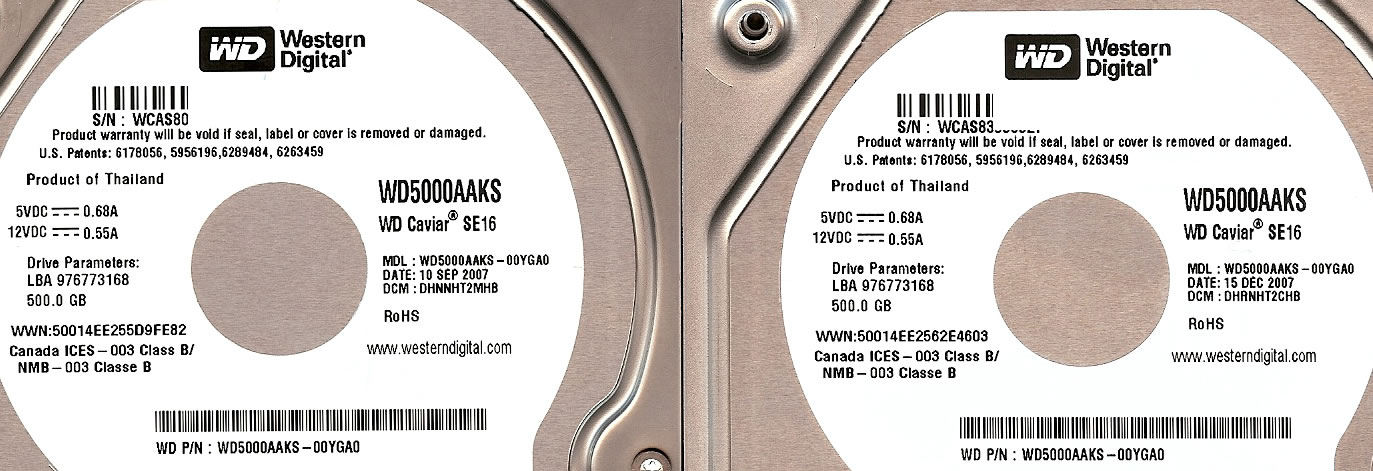

The DCM first 3 numbers match, and also motor number match.

Zebong, DCM is not important.
This drives from same family --YG-- and this is one of the conditions.
You should compare head map in both ROM's. It's must be same. This is second codition.

Hello zebong i would check, for magnetic dust over platters that family has some tendence :(

Another curiosity : did you find the heads in these conditions ? For me this drive is a desperate case (user intervention ?!?) :shock:

yes, i found the heads like this...
And dont find yet the missing heads, the filter was clean, very clean.

I vote for heads being captured by the VCM magnets . Remove top pole and take a look there because the drive is not a bathtub and there's no sink :mrgreen: the heads, unless ground in nanoparticles, should be there.

There is a slim possibility of a heads stuck to a platter, that what probably took new heads (if I undertood correctly)

The heads are almost 99% sure on the magnet. These magnets are very strong and it is lickely the heads are blown towards the magnet, while the drive was spinning.
I have eaxactly the same drive which needs a head swap (WD5000AAKS-00TMA0). I am curious if you managed to get the alignment OK and if so how you did it. Did you use the ramp for the swap or just a different tool?

Hi in this case was not easy change heads , i could do it with a tool that i build and using the ramp.
Abou the aligment .... i am trying :( :( no sucess at the moment

I have also seen where the heads were ripped off and stuck to the platter.
 Post subject: Re: WD5000AAKS - Head change
PostPosted: March 10th, 2009, 18:02
Posts: 4819
I found many heads stuck on the gasket of the cover.

what i said is when i open the disk it was missing the heads but the disk came to me closed with seal, i open it.
What happen to the disk it was dropped by the client so heads jump.
At the begginer dont see any heads, but i could find just two.
The others heads is in the disk inside dont knwo where !!!
