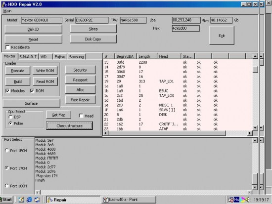

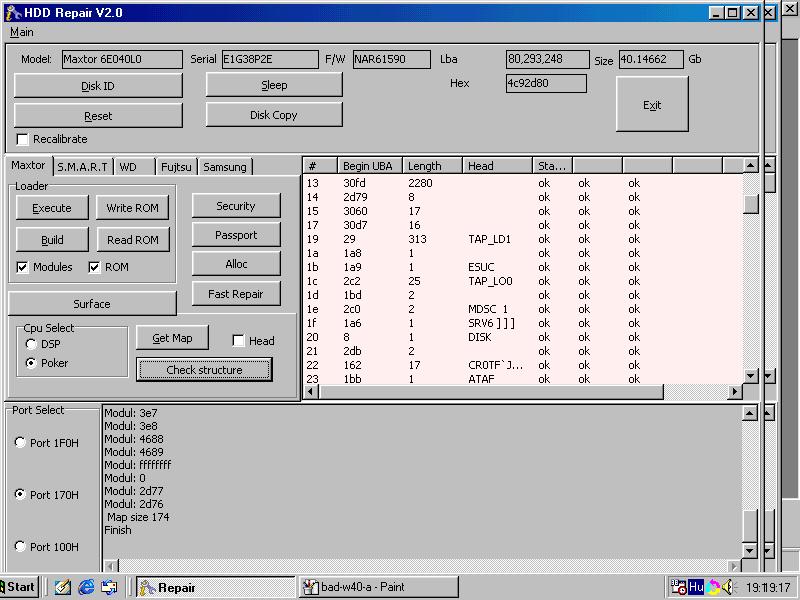

What is the reason when Maxtor DM+8 modul SRV is 20h and not 1Fh. Can I upload pictures here?

Sorry, mistake: DISK modul PN is 20h not 1Fh.
I try but BMP not allowed.Try jpg...
 Post subject: Re: Maxtor Safe mode jumper
PostPosted: March 24th, 2009, 9:21
Posts: 849
Module numbers in HDD Repair Are not the same as in PC3000! They are shifted with 1...
Therefore module 20 in HDD Repair correspond to 1F in PC3000, 21 to 20, etc....

Thank you BGman!
I was warried about it.
Yes BlackST, this tool is not PC3000 but I have this.
One more question: how can I enter into ALT_SA with this tool, (if possible)?
