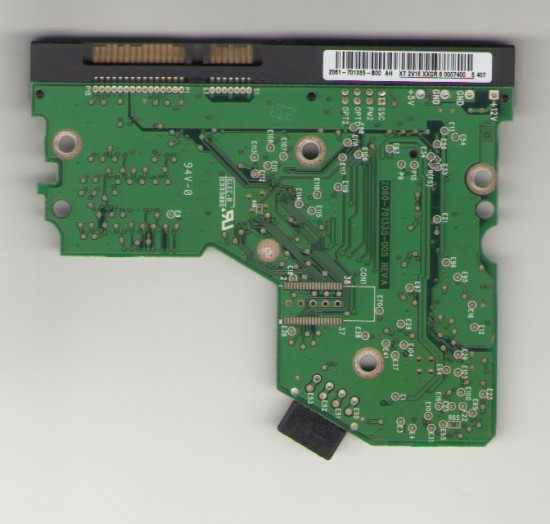

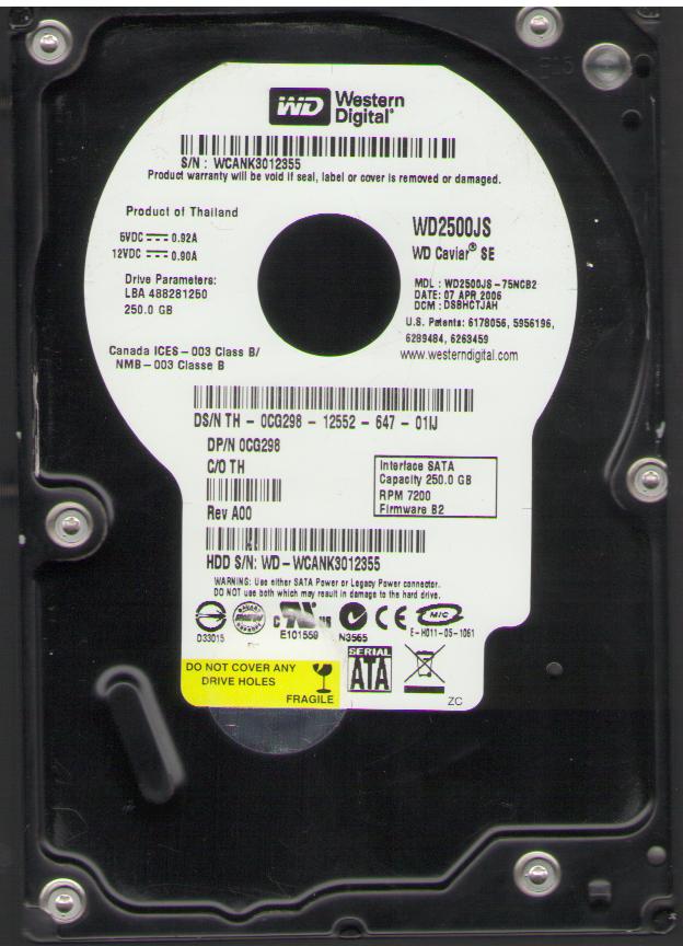

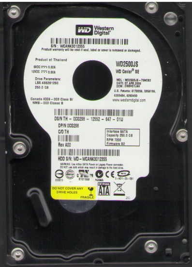

I need help with my Western Digital HDD. It's 250 GB. RPM is 7200. Model nummber is WD2500JS-75NCB2. Drive parameters: LBA 488281250
I connected it unproperly to the motherboard and now it is not working. I showed it to some people who understand that kind of stuff, they opened the HDD and found out that a little thing, called "controller", as they said to me, has been fried up!
The HDD came with Dell XPS 200. I bought it in WA. I can't get any support or anything from Uzbekistan. THe only HDDs that are in use in Uzbekistan are Maxtor and Samsung.
We're guessing if I had another motherboard/chipset of WD HDD, I would be able to use the HDD again. I have some very important data in the drive. I don't understand anything in this field. And, as far as I know now, I can't buy any Western Digital HDD here in Uzbekistan.
I'm attaching the pictures of the HDD. Please, help me! I don't need the HDD itself, I don't want to use it again. I just need the data in it. Is there any other way, if I can't find a way of fixing/replacing the HDD's motherboard? Please, help!...

Without access to a replacement PCB, you don't have much options. Of the top of my head I could think of the following:
A) If you are knowledgeable about hard drives try and find a donor pcb.
B) Ask on the forum for the person which is closest to your country you mabe be able to send it to them for recovery.
C) Try asking on the Russian forum for help
 Post subject: Re: Need help with my Western Digital HDD
PostPosted: April 11th, 2009, 14:47
Without a replacement PCB, recovery impossible.
PostPosted: April 11th, 2009, 14:54
Posts: 872
Location: Dublin
You can get one from Ultratec...
https://www.ultratecdirect.com/stocklis ... rch=cg298&
It's a B-Grade part but perfectly acceptable for DR purposes. They also ship to your country.
You can read up some more about swapping PCB's on a WD drive, you'll need to swap the ROM chip (denoted by U12) on the PCB.

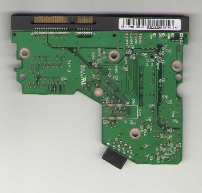

Use this site http://www.ultratec.co.uk/ to find same PCB .
Resold the U12 from original PCB to the new PCB.
Plug the new PCB on patient drive and backup your data.

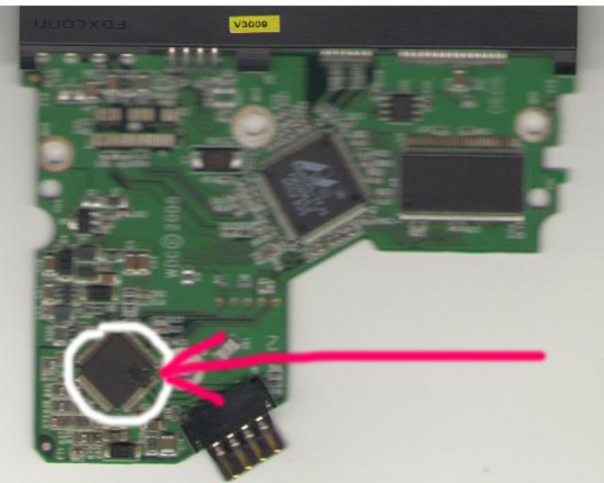

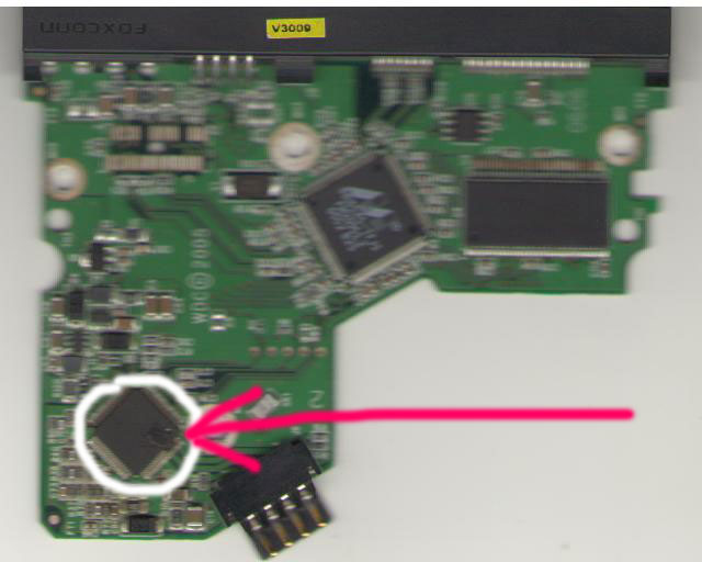

Are you sure that this PCB has actually an external serial flash ROM? The SO8 device between the SATA power and data connectors can also be some kind of load switch or regulator MOSFET. Check if you have an U12 before you order another PCB, as some model have the ROM with the adaptive data within the CPU :(
This would mean that you have to swap the CPU to the new PCB and pray that it did not blew when the motor combo did.
Chances are that the preamp inside the HDA has also been damaged. I've been given a HDD to practice on on which the flex prints within the HDA have vaporized. Looks nice on the platter, fortunately it's only one in my drive, but three in yours :(
(another way would be to replace the blewn motor combo chip, but this would require to check all components around it for defects)

When buying a pcb try to get the exact match , with the same controllers .
That's definitely the EEPROM on 701335 boards.
