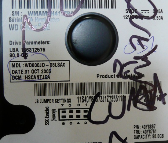

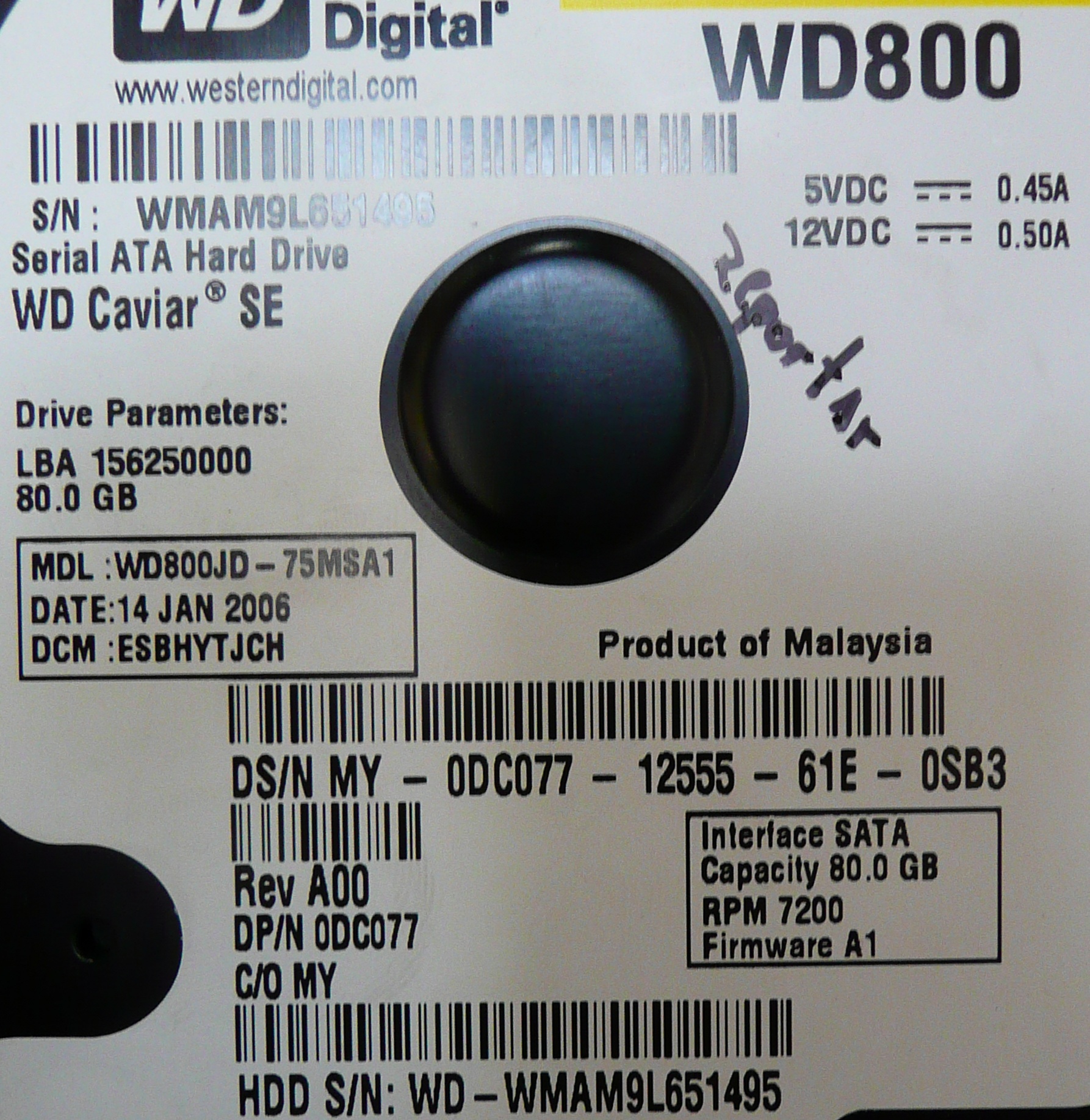

 Post subject: HSA swap wd800jd, donor compatability
PostPosted: April 22nd, 2009, 9:59
Posts: 249
looks a fine candidate to me but would like your esteemed opinions. thanks.
 Post subject: Re: HSA swap wd800jd, donor compatability
PostPosted: April 22nd, 2009, 10:08
Posts: 1517
Location: Mexico

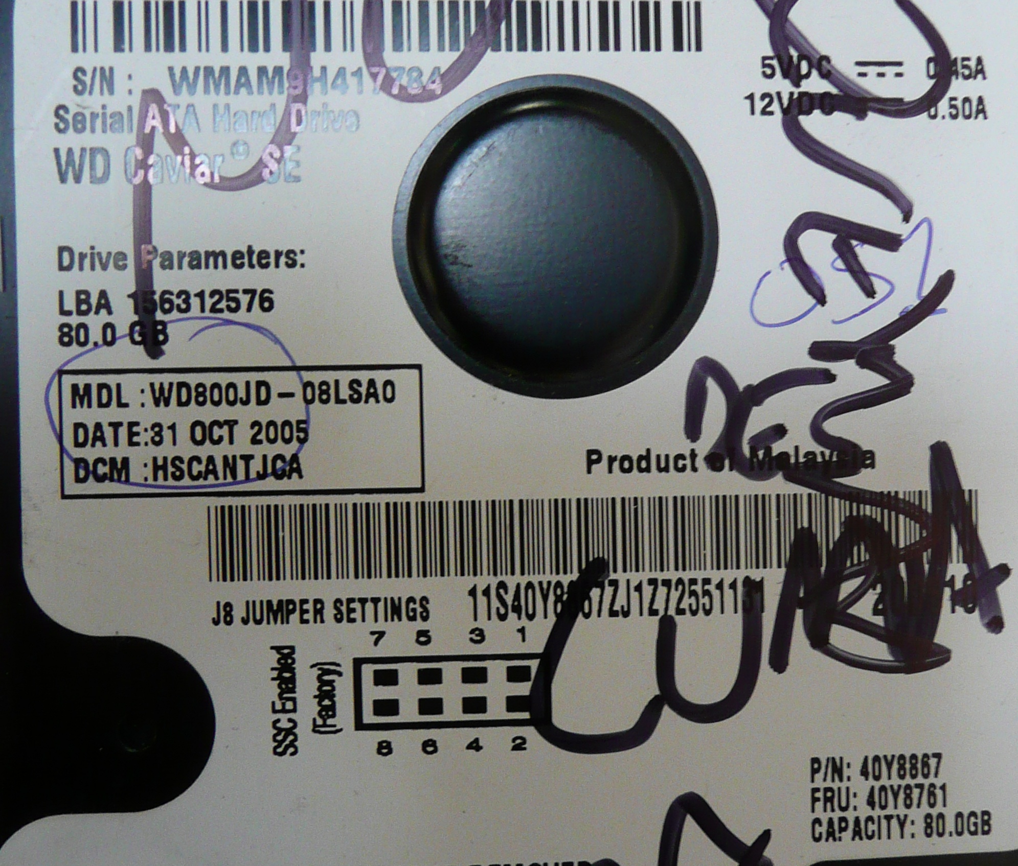

Hy this WD´s are hard to find donnor´s some years ago i got similar case, donnor was same model, at that time, check " 3 letters" DCM now im know´s DCM doesnt matter, and no works foruntely, at that time, the hdd not knocks, and reach´s readiness only the head test show me error at second head, but after work with the patient was possible to get data , because the head swap, not works, endless knocking, i will suggest for this case get a donnor same model but closest date and tried
PostPosted: April 22nd, 2009, 10:16
Posts: 249
thanks Beto. You think my match is not close enough?
Yes disk had click of death, client knocked over while running.
Any closer donors out there? :D

Absolutely incompatible donor for Head Swap.
You need:
1. wd800jd - xxMSxx same with patient;
2. Same head maps
3. Malaysia.
I would never send my broken HDD to such 'pros'...
This user was found to be affiliated with Ace Lab/PC-3000. See this topic for details.

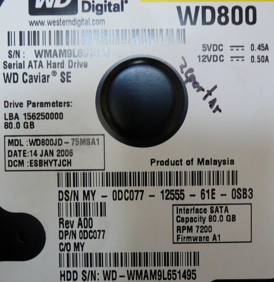

Match the Dell P/N DC077 for best possible match.

I would use this one for donor
It looks compatible to me

MS Vs LS still the same class.....
give it a test you will know... it is simple.......

I personally would have thought that this is not a good match. But Doomer has me confused. Would you be able to elaborate on this. Why so many different answers??? :roll:

LSA and MSA are both Unicorns. They use same hardware. Heads map supposed to be the same - 2 heads H0 and H1
You may need some tricks to make the drive work after transplant but this is usual for WDs

These tricks you speak of....Manually jigging head alignment or altering adaptives for head alignment?
