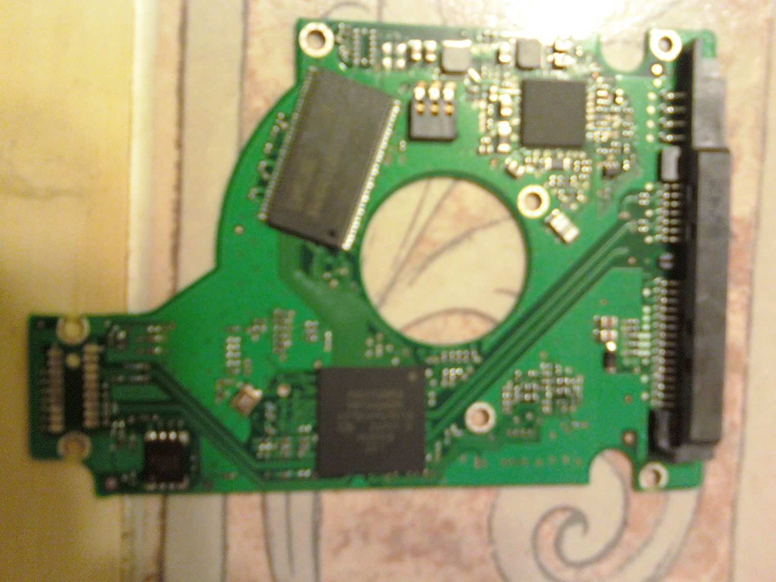

Hi Gurus!!!
Wrong power cord on this PCB. TVS or protective register locations?????

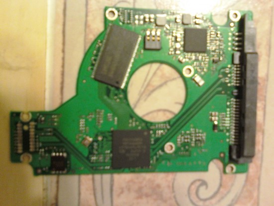

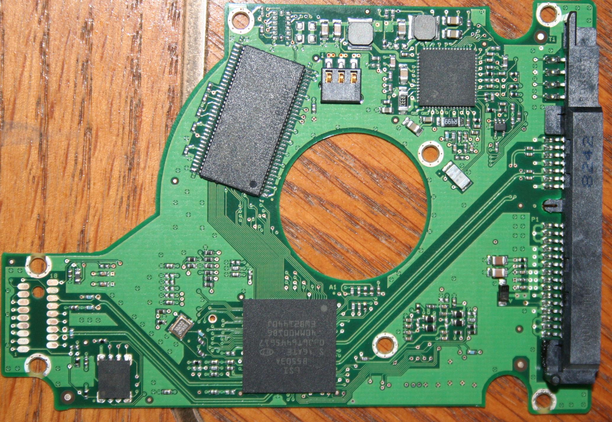

Better picture.

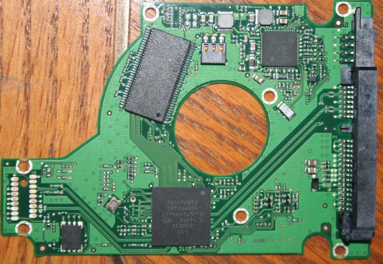

 Post subject: Re: Seagate 2.5" PCB TVS???
PostPosted: July 13th, 2009, 22:16
Joined: November 11th, 2007, 22:44
Posts: 168
Just to the left of the 10th pin between the 5v and Ground
PostPosted: July 13th, 2009, 22:51
Posts: 269
Location: behind the platter
Thanks! I tried that one but the drive remain the same... I was wandering if there is another one
