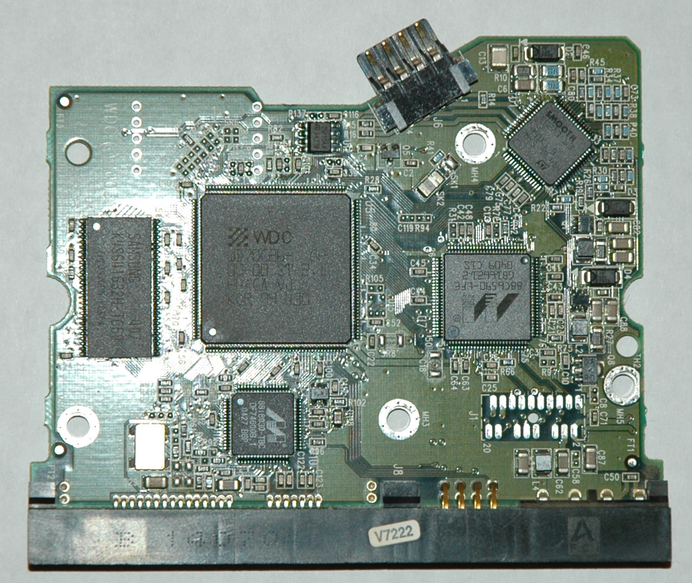

Hi folks,
I have a wd2500JD-75HBB0 that died on me, stopped working , no warning, nothing. It does not show in the BIOS.
I have replaced the old PCB. I am getting the drive to spin up and down now but am getting 6 clicks repetively.
(4 constant clicks followed by 2 clicks)
FYI-I have not swapped the ROM
Any suggestions? please.
Thank you very much,
sammad

swap the ROM

Thanks so much for the reply.
Can you give me an idea as to how to do this.
Im not sure what chip it is and how to de-solder/re-solder it.
I have enclosed a picture.
Thank you
sammad

U12

U12 is the 8 Pins IC

Got it! Now I see it. Is there a "best way" to do this. What part do I heat to remove this? The legs? The chip?
Long story short, Im a novice to soldering, however, I will give it my best.
Any help is appreciated. And thanks so much for all the replys!
sammad

Hi, if you not used to soldering I would suggest you to take the Pcb to a eletronic repair shop and ask them to do the change.

Just take the PCB to any electronic technician and tell him
to replace the new 8 pins IC on the new PCB with the old one
on the old PCB

The ROM swap worked perfectly. A special thanks to harddrivespecialist who provided the PCB as well as the soldering.
