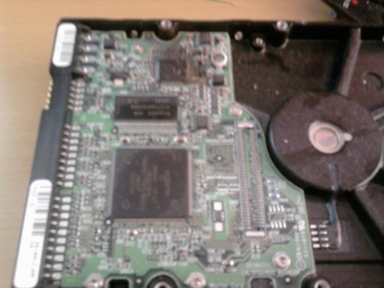

My maxtor hard drive pcb board's square chip caught on fire, and completely rendered the hdd usuable.
Is it safe to replace the pcb board?
HDD info:
MA6Y160P0
Code: YAR41BW0
K,M,G,D
M88FYB
301862101
CALYPSO/KOT_P/THERM

On this model you can use any M8FYB pcb.
But you can have damaged preamp as well wich is common on this model + this problem.
If your preamp is short, the new pcb will be gone too.
If your data is really important, i suggest to find a pro near you.
This problem can be cheap.

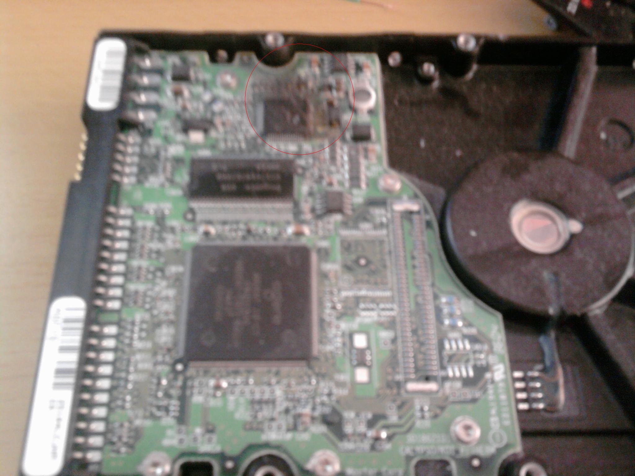

 Post subject: Re: Maxtor DiamondMax Plus 9 160GB ATA/133 HDD burnt PCB board
PostPosted: August 1st, 2009, 19:38
Joined: July 30th, 2009, 3:27
Okay, here's a bad quality photo. My phone's camera doesn't have autofocus
PostPosted: August 1st, 2009, 22:35
Posts: 269
Location: behind the platter
Yep, I can see it even with this low resolution photo...
You have to have a replacement PCB at least!!

Posts: 384
Location: China
SMOOTH drive chip got fire, try swap PCB.
