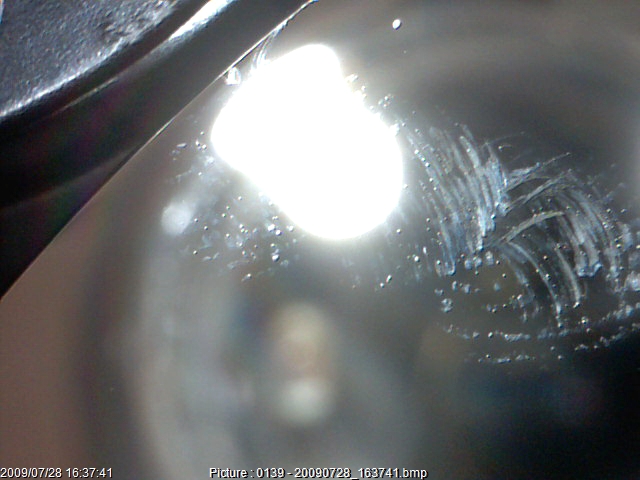

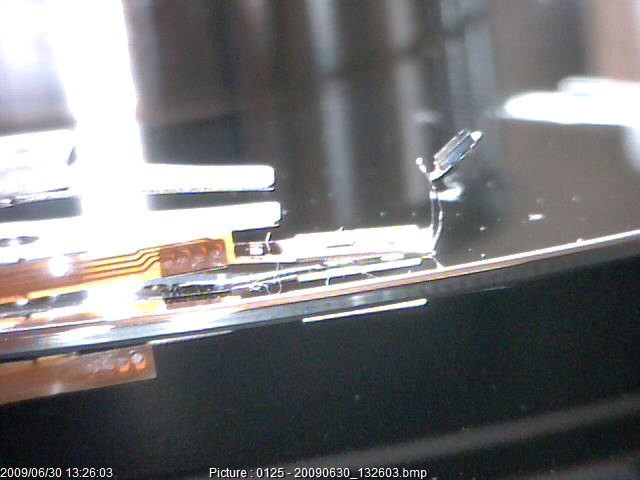

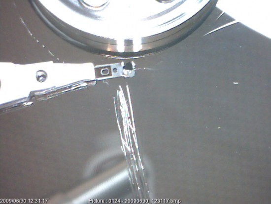

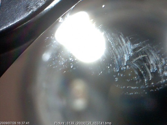

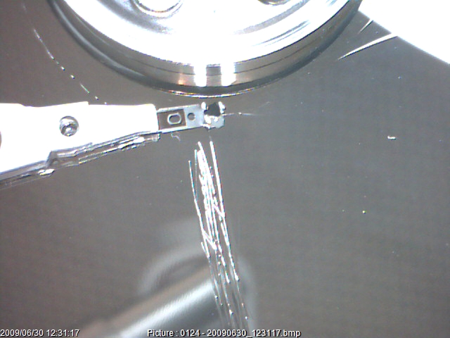

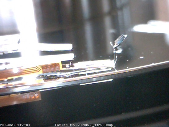

Ok everlost here is explanation why we said that cases need to send it to a "pro" a
1.- WD case arrive to us , another hands tried to did the data recovery, caused a lof dust, scratch´s and media damage to the surface the worst they exchange platters to another HDA,and reverse it to did the "data recovery" HDD¨s are piece of engineering no exchange parts.
2.- The second another case where another "experts" tried to recovery on a Fujitsu case, they kill the surface when take off and put the "good heads"
At u case if its not Mac, version, u could be the "typical" autoreallocation process selftest, wich is causing , not anwer to any command or answer slow, where needs to check on terminal, and u could get some like this
P)SATA Reset
AT Er 00 Nwt Er 37 RdWr 00e4f.01.031f
ATA St 50 Er 01 Op 00 0,0000/0/00,00 01 00
Niwot: 97f29ff7 c0 97f29ff7.1.bda 0000 007f 0000 06ec
EC=43 at 000e4f.01.031f
c775c7 Type=5 Add To Pending c775c7
AT Er 00 Nwt Er 37 RdWr 00e4f.01.0322
9ff79ff7 c0 9ff79ff7.1.bda 0000 007f 0000 06ec
=37 LBA=c775ca Type=5 Add To Pending c775ca
AT Er 00 Nwt Er 37 RdWr 00e4f.01.032f
Niwot: 9ff79ff7 c0 9ff79ff7.1.bda 0000 007f 0000 06ec
EC=43 at 000e4f.01.032f
This case´s cannot be solved by end user
I hope this helps

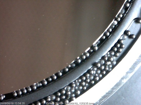

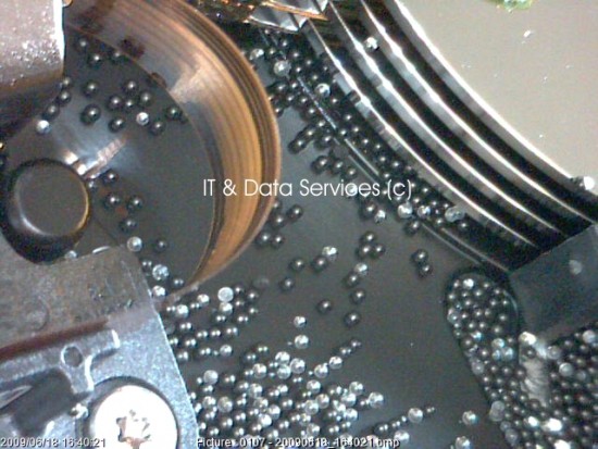

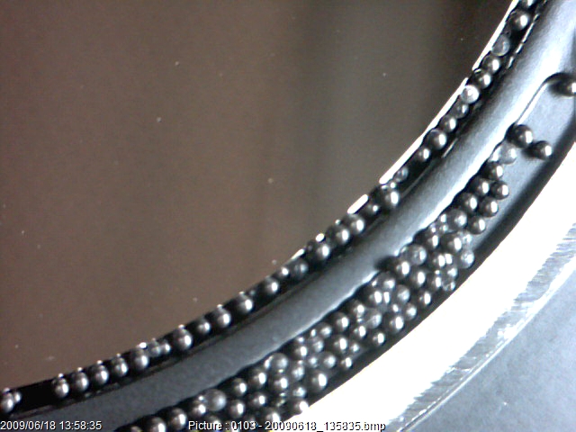

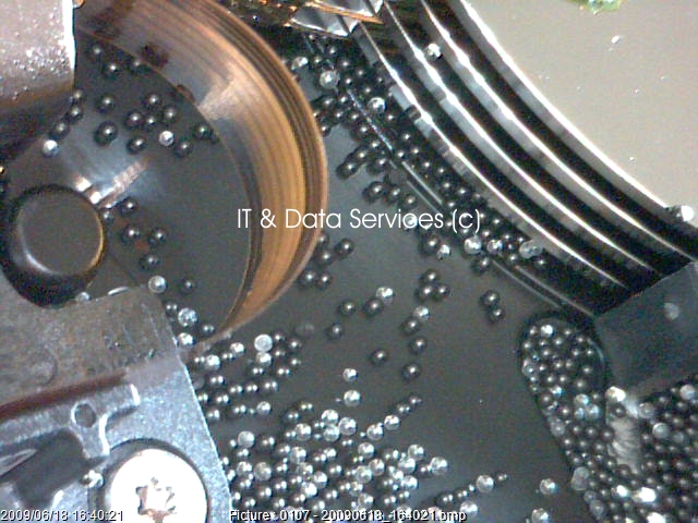

Here is it another worst case drccsc :? , a Seagate Chettah Case from a RAID 5, another "company" tried to did the "data recovery" and they did here a platter exchange on a case Seagate Chettah Size 0 wich looks was G list problem , the worst they broken the silica bag and all balls falls inside the hdd, but the worst was from a "so called professional company"
Im think there are good examples !
