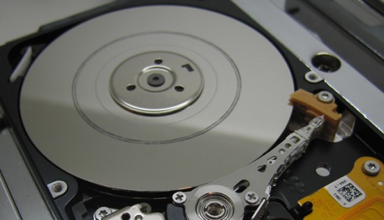

Hi just for Info about this error.
Have this error in terminal.
Reset
4096k x 16 DRAM
VENUS - 1_Disk S-0C 12-12-06_13:23
Buzz HM REG701 91
HM REG701 91
HM REG701 91
HM SFI
$($18E5E,00E74,0000,00,51,30,AC)HM REG701 91
HM SFI
$($1890C,00E74,0000,00,65,30,73)HM REG701 91
HM SFI
$($19223,00E74,0000,00,47,30,96)HM REG701 91
HM SFI
$($17ED5,00E74,0000,00,50,30,5A)HM SFI
$($10C94,10C94,0024,00,65,70,FF)HM REG701 91
HM
This when i open the disk it have a big head crash.
No data from here :(

Er.... did you find the reserved track data on the filter ? :mrgreen:
 Post subject: Re: SEAGATE MOMENTUS
PostPosted: January 12th, 2009, 16:57
Posts: 3235
Location: USA
Is this firmware 3.CAE? Have had a bunch with the same issue. On one of them the platters were so badly damaged that I could see right through BOTH of them to the bottom of the drive case. :shock:

We too have had no end of 3.CAE drives in, 120Gb & 16-Gb flavours. ]
Anyone have decent amount of success with these?

Based on my experience with these drives, they are usually damaged beyond repair. 90% of them we have received had platter damage on the underside of the platter.
