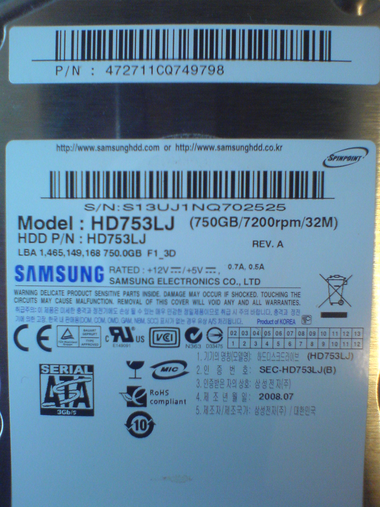

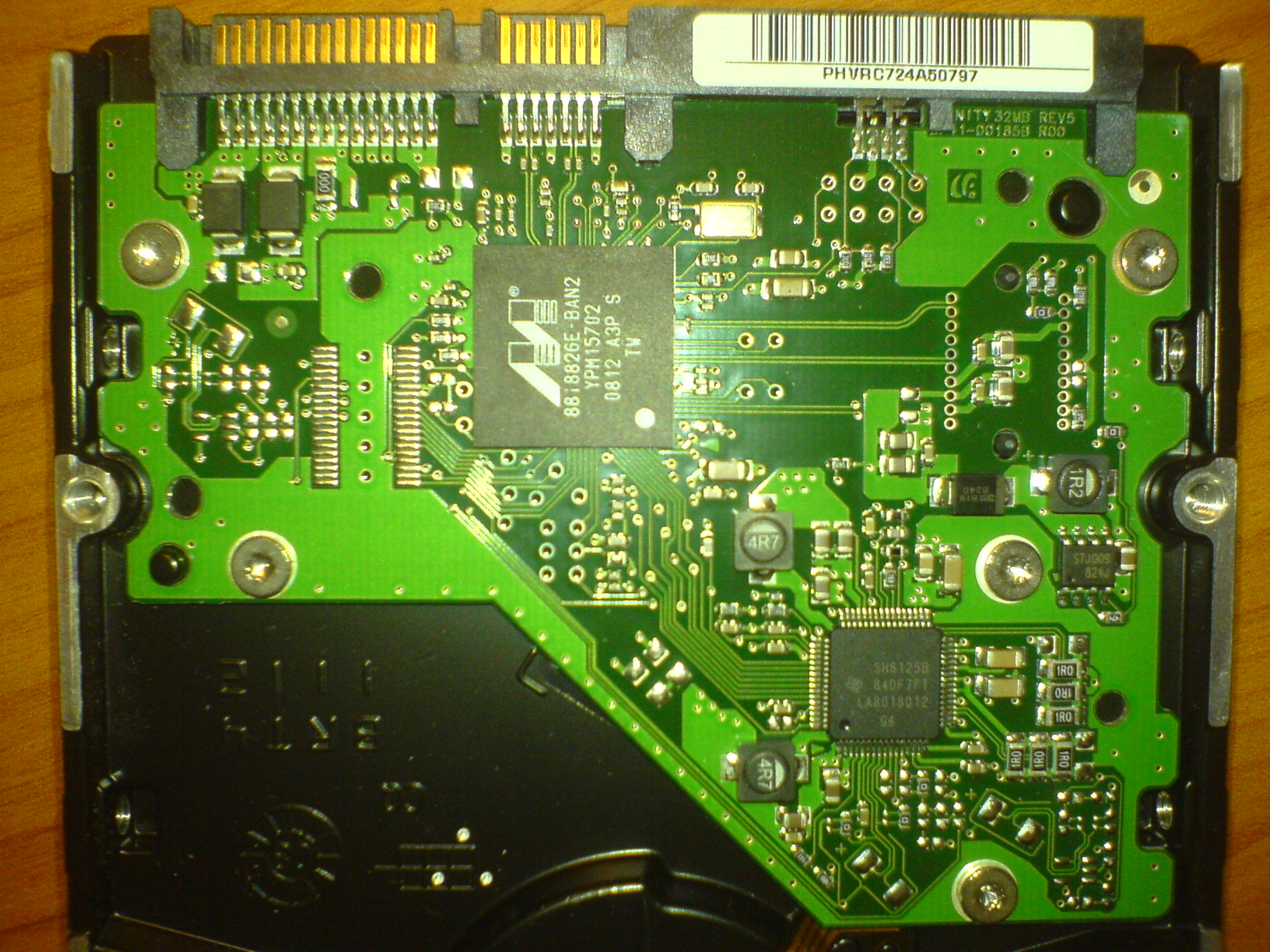

Several weeks ago, I fried my 750GB Samsung harddisk (SAMSUNG HD753LJ F1_3D Rev A) by using a power plug from a regular 80 mm fan which has been subject to the 5V mod:
I've applied the 5V (see [1]) mod on three of my 80mm fans where they are connected together in series. At the end of the last fan's power cable there is a molex connector (see [2]), and without thinking any further I plugged the molex connecter into the Samsung disk. When I switched the machine on, BIOS wouldn't detect the harddisk. So, I think what's happened is that the harddisk has gotten 12V where it should have gotten 5V, and 5V where it should have gotten 12V. :-(
Since that particular harddisk uses SATA power connector, I used a SATA-to-molex power converter (see [3]) between the fan molex and the SATA harddisk.
The question is whether replacing the PCB from a similar harddisk will recover my files? I am mostly concerned how important it is to find a PCB with exactly the same firmware.

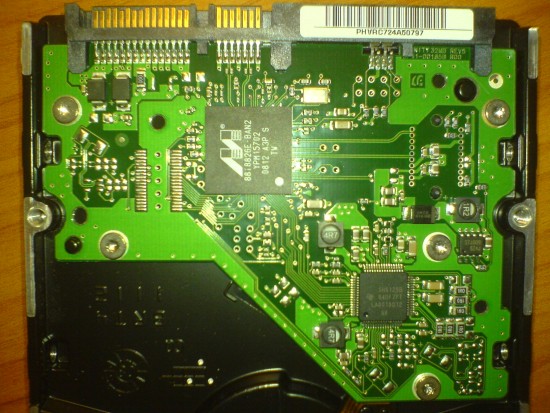

Post a pic of your PCB.

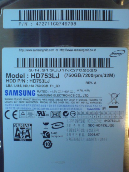

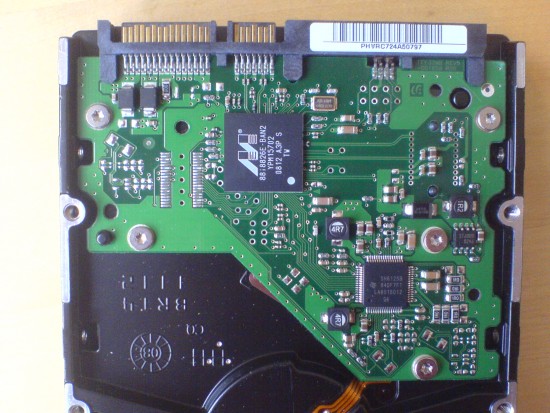

Unfortunately, I can only provide images taken with my phonecam. If the image quality isn't satisfactory, let me know. Thanks for your time.

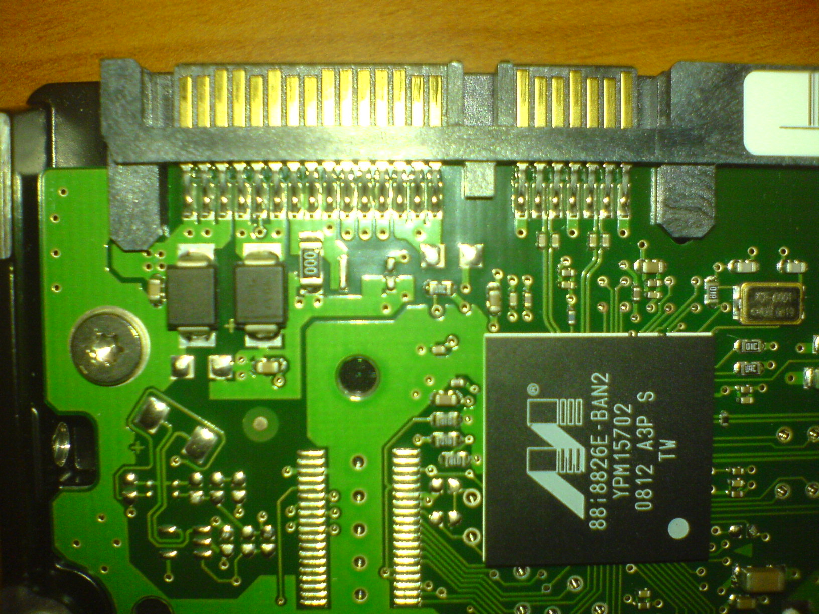

Check the two TVS diodes (two black rectangular components next to each other top left of PCB) for continuity with a multimeter, these should NOT be short.
Also check the "000" component next to them, this SHOULD be short.

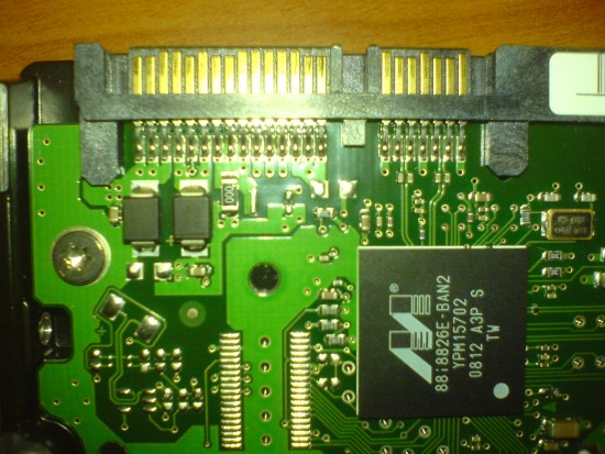

Everything appears to be the opposite of what you have suggested: The left TVS has a 7-8 ohm resistance and the right 0 ohm resistance. I consider them both as shorted. Also, the 000 component isn't shorted, maximum resistance according to the multimeter. What can I make out of this? Thanks.

If accurate then sounds like two blown TVS and a blown fuse.
 Post subject: Re: 5V fan mod may have killed my disk
PostPosted: September 8th, 2009, 2:30
If read correctly, then yes.
Ideal solution is to replace all 3 components.
Risky solution (at your risk) is to just remove the two shorted TVS's and short the fuse.

Check for OTHER problems beyond... or "va-va-vooma" DC-DC and PREAMP.... beware...

Better still, take to a pro.

Either the way, you wouldn't recommend "simply" replacing the PCB over replacing the components?

I know it's an old post but I finally had the luck and time to fix the hard drive so for the sake of history (yup, Google will handle that :).
The fix was "simply" to find a harddisk with a matching PCB. My dead disk's print board's revision number is 5. Last autumm I bought a Samsung 750GB REV. A rev. 6 in a store but at that time I didn't know the print board's revision number also matters - rev 6 didn't bring my disk back to life. [1] Then a few days ago I got hold of a rev. 4-disk (also 750GB REV. A) and that one worked well with my dead disk - well it's no longer dead! :-)
I'm just wondering what REV. A means - obviously, it's neither the firmware or the PCB version as it is printed on all three harddisks. Oh well...
[1]: Rev 6 PCB also looks pretty different from Rev 4 and 5.
