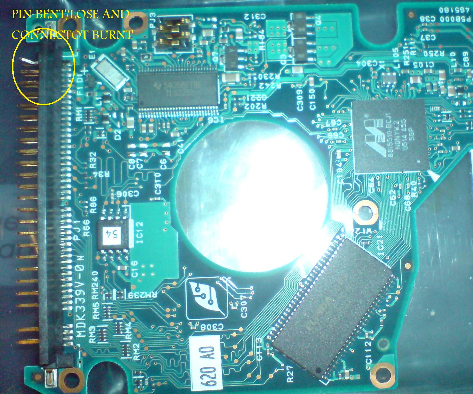

Can you upload a detailed photo of the PCB?
 Post subject: Re: Toshiba mk4025gas shorted on connector
PostPosted: January 13th, 2010, 19:17
Joined: January 12th, 2010, 12:23
Posts: 11
Location: uk

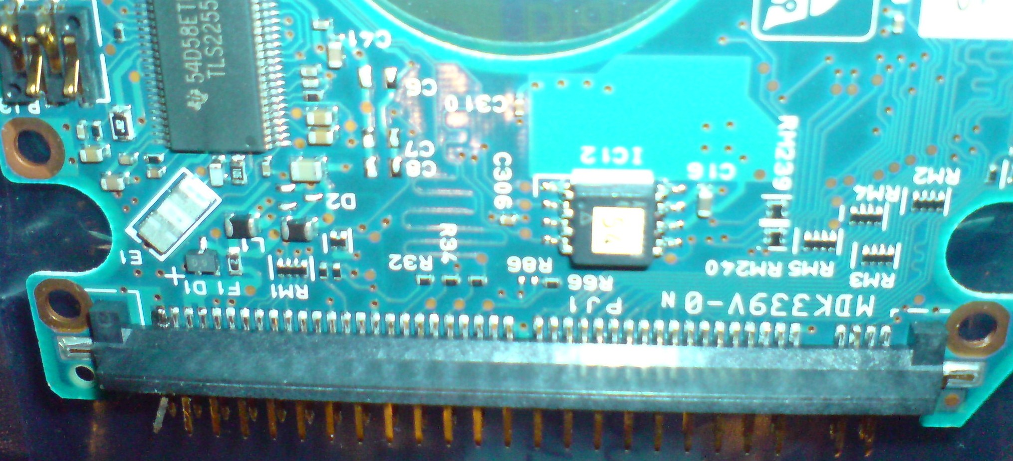

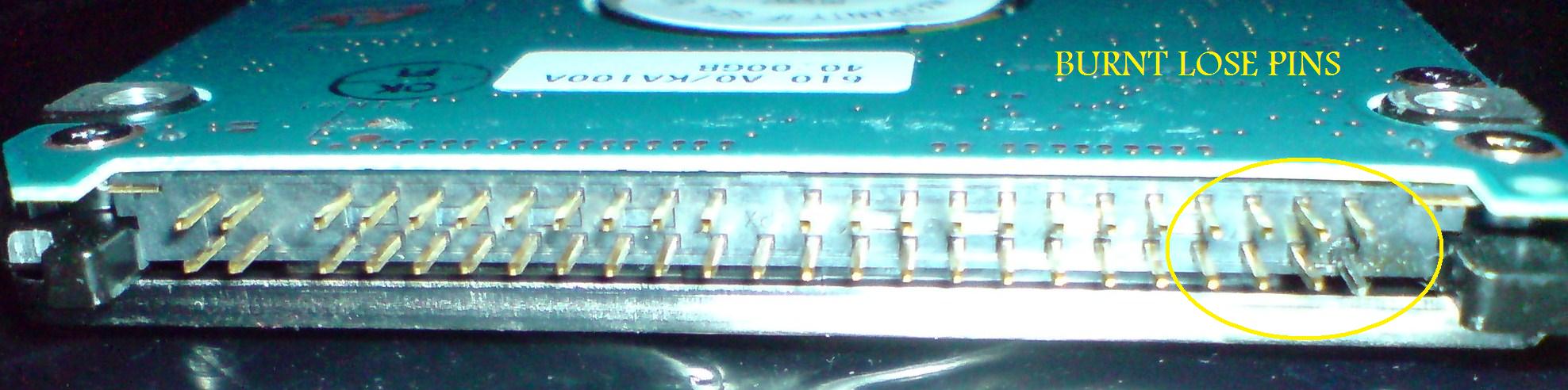

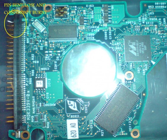

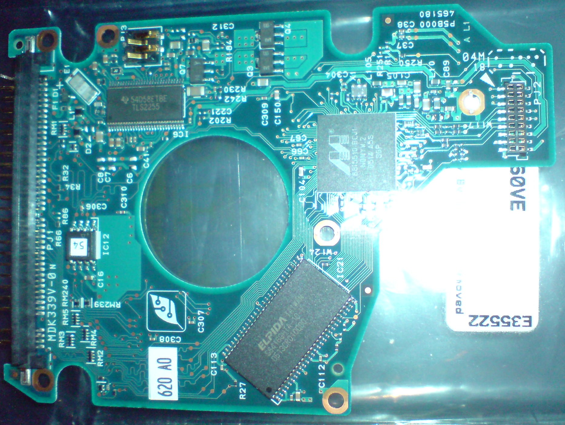

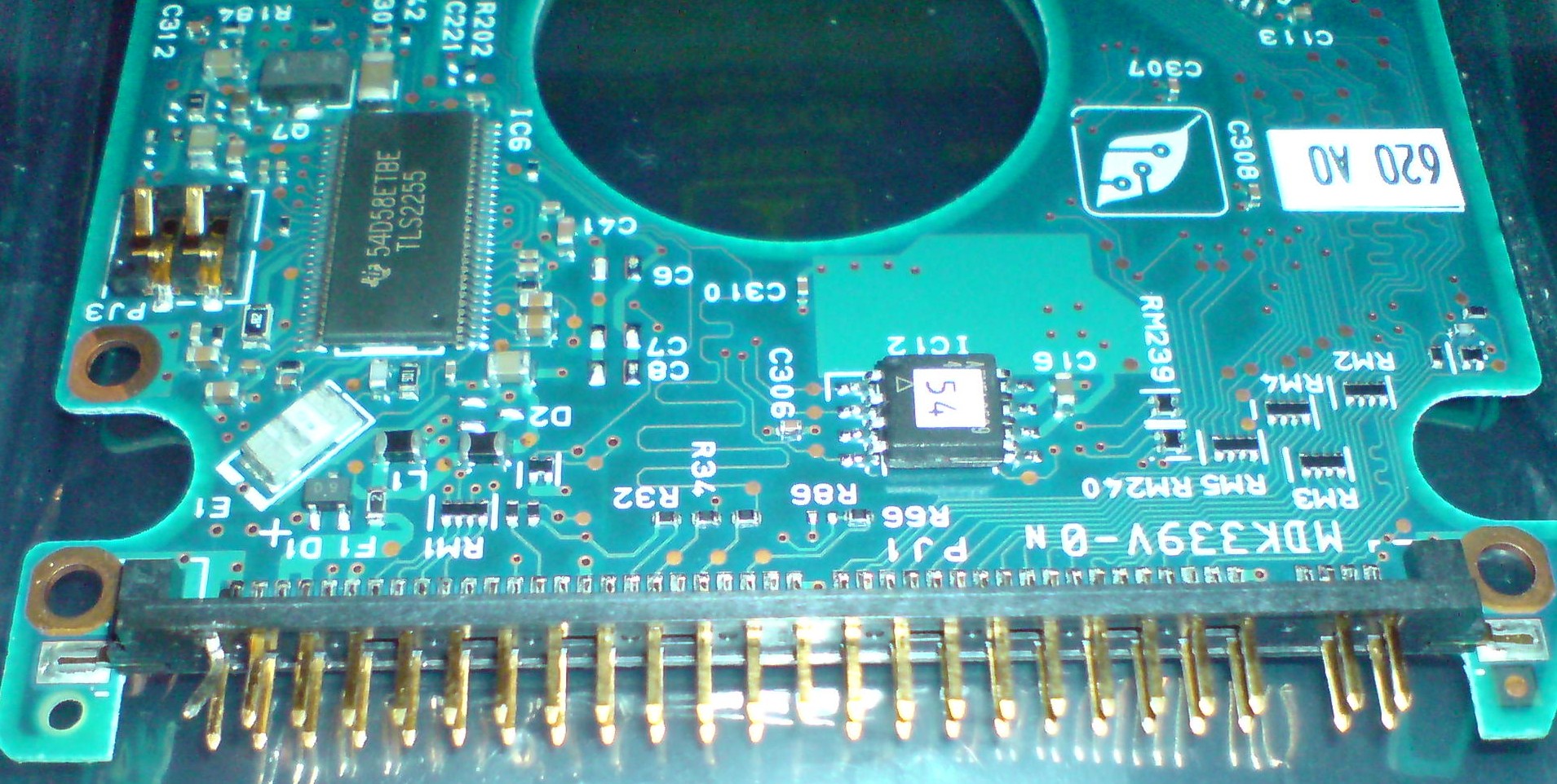

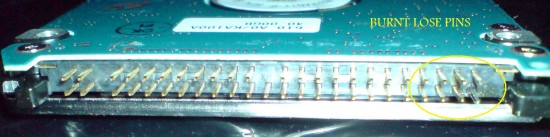

Hello fzbkar
The connector plastic is burnt and pins lose any advise/help ?
Thankyou
PostPosted: January 13th, 2010, 20:11
Joined: July 8th, 2006, 6:18
Posts: 222
What has it been connected to? 12V? IDC plug wrong way round?
PostPosted: January 13th, 2010, 21:03
Posts: 17352
andrew2010 wrote:
The connector plastic is burnt and pins lose ...
I can't see exactly what happened, but it could be that the IDC pins were making poor contact, in which case the current may have cooked the connector due to ohmic heating in the high resistance joint.
Alternatively, you may have overvolted the PCB, in which case the TVS (?) diode D1 may have short circuited and caused an excessive current to flow. However, I would have expected fuse (?) F1 to go open in such a case. If you have a multimeter, set it to the 200 ohms range and measure the resistances of F1 and D1. If D1 is short circuit, remove it. If F1 is open circuit, bridge it with a wire link, or replace it with a picofuse (3A ?). Just be sure your power supply is OK because doing the above will leave your drive without protection. If you want to replace the diode, you can use an SMAJ5.0A from Farnell, Mouser, Digikey.
Here is the pinout of your connector:
pins 41-44:
http://pinouts.ru/HD/Ata44Internal_pinout.shtml
pins 1-40:
http://pinouts.ru/HD/AtaInternal_pinout.shtml
If you decide that you would rather replace the whole board, then you will need to transplant the 8-pin serial EEPROM chip at IC12 (?) from patient to donor. Before you do so, confirm the part number under the paper label.
Hello Shawn
I think the IDC plug may have been connected wrong eg pin 41 to 43
and pin 42 to 44 but not sure pin 44 or 43 was black & lose .
PostPosted: January 13th, 2010, 21:16
Posts: 4854
I don't see any burnt components apart from the connector... u can check fuses on the PCB
to replace the pcb u need to swap rom (IC12)

andrew2010 wrote:
I may wait for a replacement hard drive/pcb, which numbers have to match for a sucessful transplant of EEPROM chip at IC12?
I'm not experienced in data recovery, so that question would best be answered by a professional.
One other thing I would check would be whether the end pins are still making contact with the circuit board, especially the loose one. It may just be a matter of resoldering it.

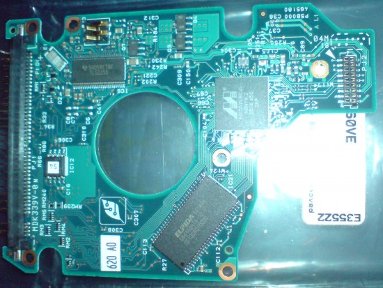

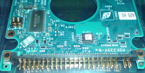

hello all
I have been offered toshiba MK4025GAS HDD 2190 B ZE01 T and MK4025GAS HDD2190 C ZE01 S, which one would be the better match for EEPROM chip IC12 swap ? Can the donor eeprom be reprogrammed in situ and at what cost ?
Thankyou.

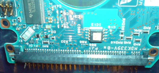

Hello all
F1 the component below the F ? No beep on 200ohms setting.
D1 is that the large rectangle adjacent to the E1 marking ?
If not can you circle the correct ones on the pcb photo.

Hello drc
Why the rolling eyes ? Just wanted to confirm the donor drive codes and component markings. The components are very small, in some cases smaller than letter markings on pcb.
I am familiar with larger electronic components but this is first time on 2.5'' drive so am a newbie.
Thankyou.
