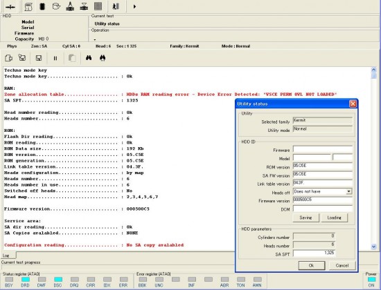

I have a WD10EADS-00L5B1 (Kermit) HDD which has some corrupted modules including
loader module. If you have resources of the same drive please share it with me.
Details:
Model: WD10EADS-00L5B1
Date: 20 APR 2009
DCM: DANNNT2CFN
Firmware: 01.01A01
Firmware version: 000500C5 (I need modules of this version)
(My donor drive dated 23 March 2009, has firmware version of 000500C2 which in not compatible)
Please have a look at attached screen shot for more details or for any possible advise regarding
recovery of data from this drive.
Thank you
Pninja
File comment: Screenshot of patient drive

can you read sa tracks? if you can, make a full backup of BOTH sa heads. if you send me the backup i can see if it is possible to extract the modules.

Some heads are faulty

agree with terranova. but backup of sa tracks could be possible. extraction of modules is neccesary for hot swap.

On this type (green label), head swap is pretty easy. So I did a head swap today.
Unfortunately, nothing changed.
Original head also worked fine on donor drive.
In very very rare cases I have seen a faulty head passing the tests.
That is why I normally trust the head test until I have no choice other than
the head swap.

Start in kernel mode
Do head map edit on the fly - turn off all but #2
Do soft reset
See if you can get drive ID
See if you can access SA
(may have to exit utility & re-enter w/o powering off to access some SA features)
http://www.datasaversllc.com

I did it. Drive ID or SA was not accessible.
