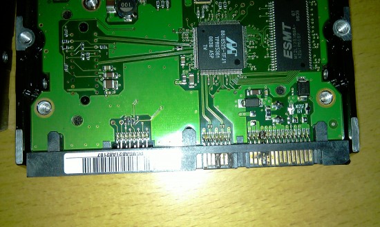

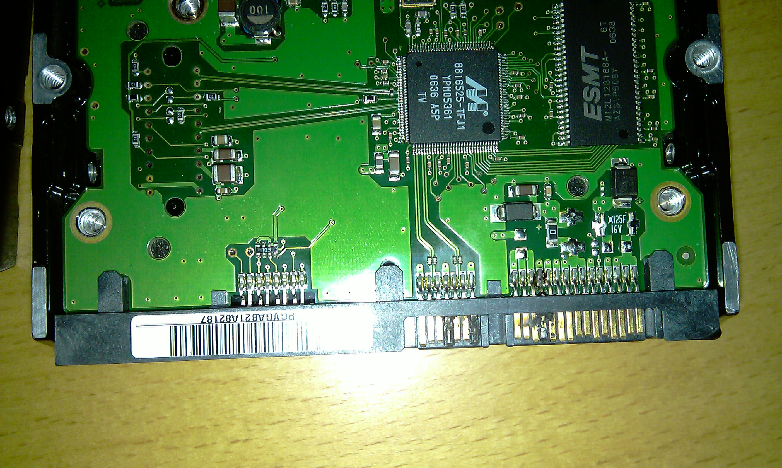

The 400 has a burn on it. (pic attached below)
The other three look fine in my eyes.

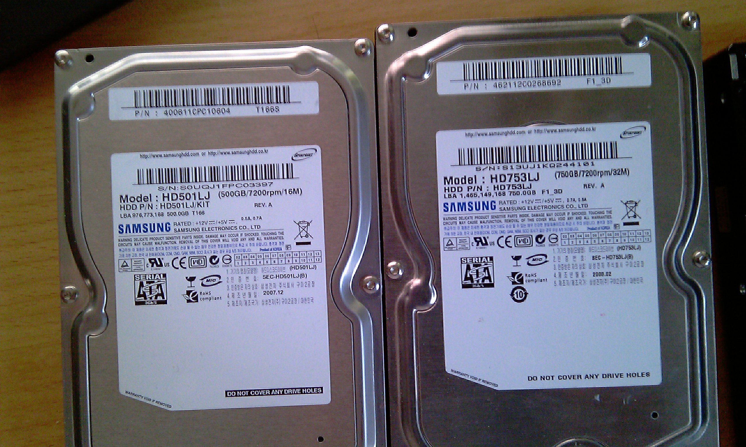

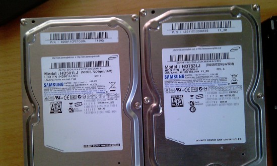

S13UJ1KQ244xxx HD753LJ INW 2011-06 100 In warranty
S13UJ1KQ244yyy HD753LJ INW 2011-06 100 In warranty
S0UQJ1FPC03zzz HD501LJ INW 2011-03 100 In warranty

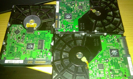

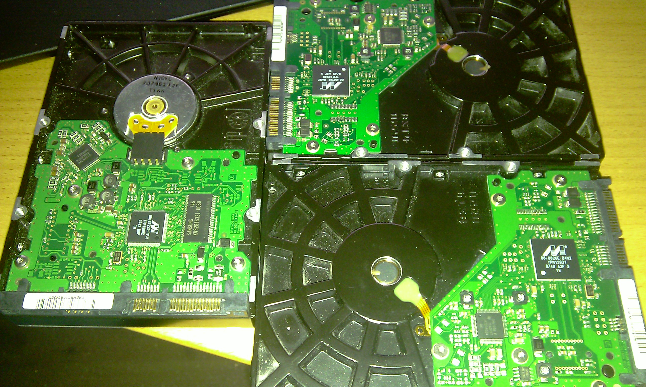

File comment: 500 & 750
File comment: 400 with burn

I should have been more clear though; only the 400 has the burn on it, the 500 & 2 x 750's "look" okay.
I have already ordered a 750 of the same type as the ones I have.
I'm guessing it will not cause further issues to try it right?
I figured that the 500 would be the issue since it's the oldest and not generally available.
I replied in this thread for a similar spec 500.
When you say repair the PCB's, have you any idea what is the matter with them?
When you say you can help, can I send on the PCB's to you for repair?
Apologies for the quality of the pics.

Do you have a multimeter?
If so, then measure the resistances of the TVS diodes and zero ohm links near the power connector.
If a diode is shorted, then remove it. If a zero ohm link is open, then replace it with a 2A picofuse or a piece of wire.
If you need more help, feel free to ask. One of us will help you.
